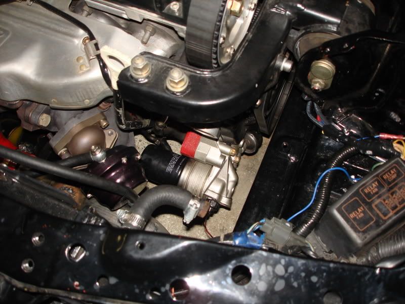

I figured the 20g at 20 psi was outflowing the old intercooler so I slapped another one on, 140 shipped and I sold the old one for 80 bucks! Had to hack up some stuff but not much at all, right now the grill cant be used till I figure out how I am going to reroute those wires
Even though it became a pain in the ass, I loved this mod! Bought a alternator relocation kit from JNZ they had laying around, Buschur racing for 75 bucks. wheres the alternator?
Oh there it is!
Where did the come from?
Galant vr4 tranny that needs a rebuild, 60 bucks
4 bolt rear with galant vr4 subframe with 4 lug so I can keep my wheels!
Also I got the car aligned since it was all out of whack from me taking off the shocks and replacing the axles. As of right now at 20 psi it runs great, just really rich! Cant wait to get the cams, hyduai valve cover, meth kit, then all wheel drive here I come :twisted:

Looks like you've been busy man. You are going in the same direction that I wanted to go with it until I had to sell it. I wish you were closer because I'd love to help with the AWD conversion.
Can you just notch out the grill to fit around that harness? I had to run it like that in order to mount the radiator under the core support. Also do you think the alternator sticks out further than an AC compressor would? The reason I ask is it may be in the way of the rear AWD mount now but I'm not sure. It was hard to tell from the angle of the pic.

Thanks, yes i have been busy but still have lots more to do! I probably could do that, as of right now I havent been too concerned, I ordered hood pins for it today and am going to try and fine tune it a little more. I am not sure on the A/C compressor, I could take more pics, would that help? Ive seen your progress on the Elantra/summit, so you finally went with the Elantra as the candidate for the 4g63? I can only imagine how that will come out seeing your work from this car! Thanks and I still want to meet you one day!

I have no idea on the clearance for the alternator I just remember seeing on Jason's AWD video that he mentioned having to use smaller tubing to clear the AC compressor. Maybe someone with the AWD swap can take some simple measurements for you.

It is looking really clean under the hood. Have you considered cutting the front ear off of the timing mount bracket since you don't have power steering and remove the front engine bracket?

What o2 housing is that and where can I get one?

Is that shiny JMF manifold going to clear the firewall, and or when the TB is reinstalled with an elbow, will it not hit the Brake Booster? I seem to remember people having issues with long running intakes creating this issue in CSM body cars.

i dont see it having a problem clearing the firewall, but as far as the brake booster goes, i might have to rig something up :-?
