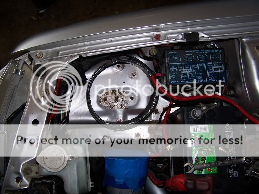

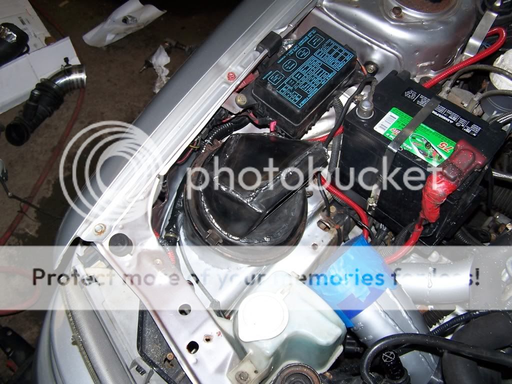

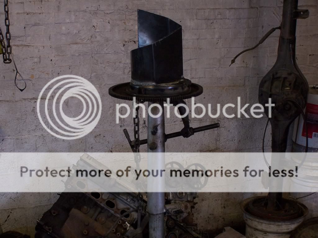

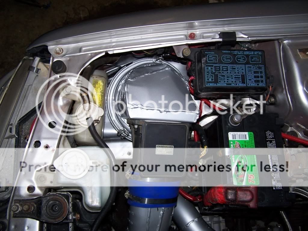

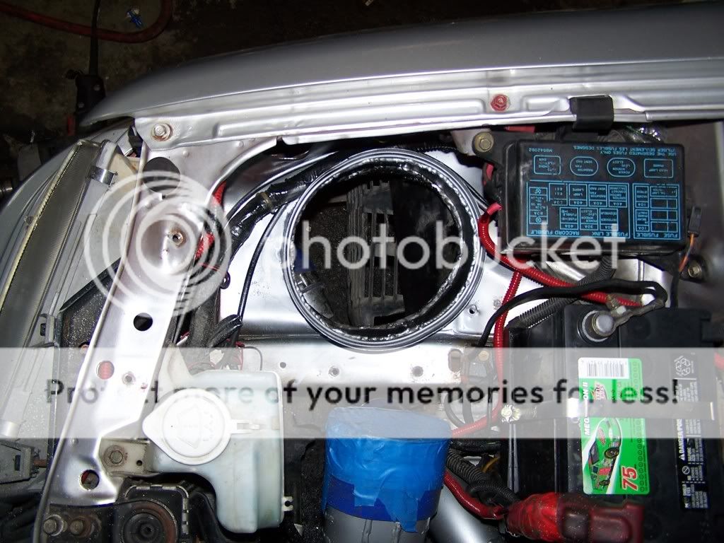

Here are some pictures of what I did for Memorial Day. It's something I had been mulling around in my head for awhile. I really thought it might be a mistake, but the more I thought about it, the more I thought, "You only live once right?"

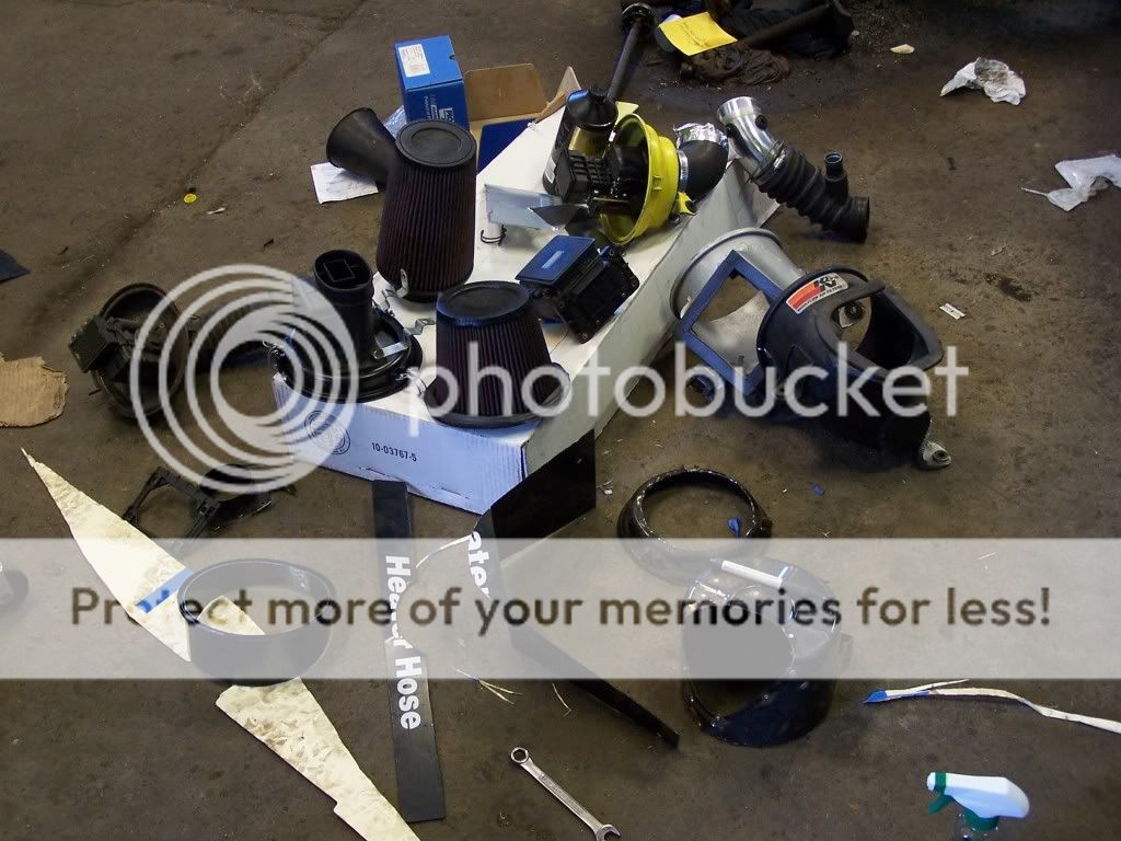

I recently made an intake pipe, and upper IC pipe, and it made my car about a half second faster and all, but it was kinda, Eh... Whoopde doo right?
Tried this, it sucked. In fact if it sucked any more, it could only be better.
Tried this, Meh...
Decisions decisions...

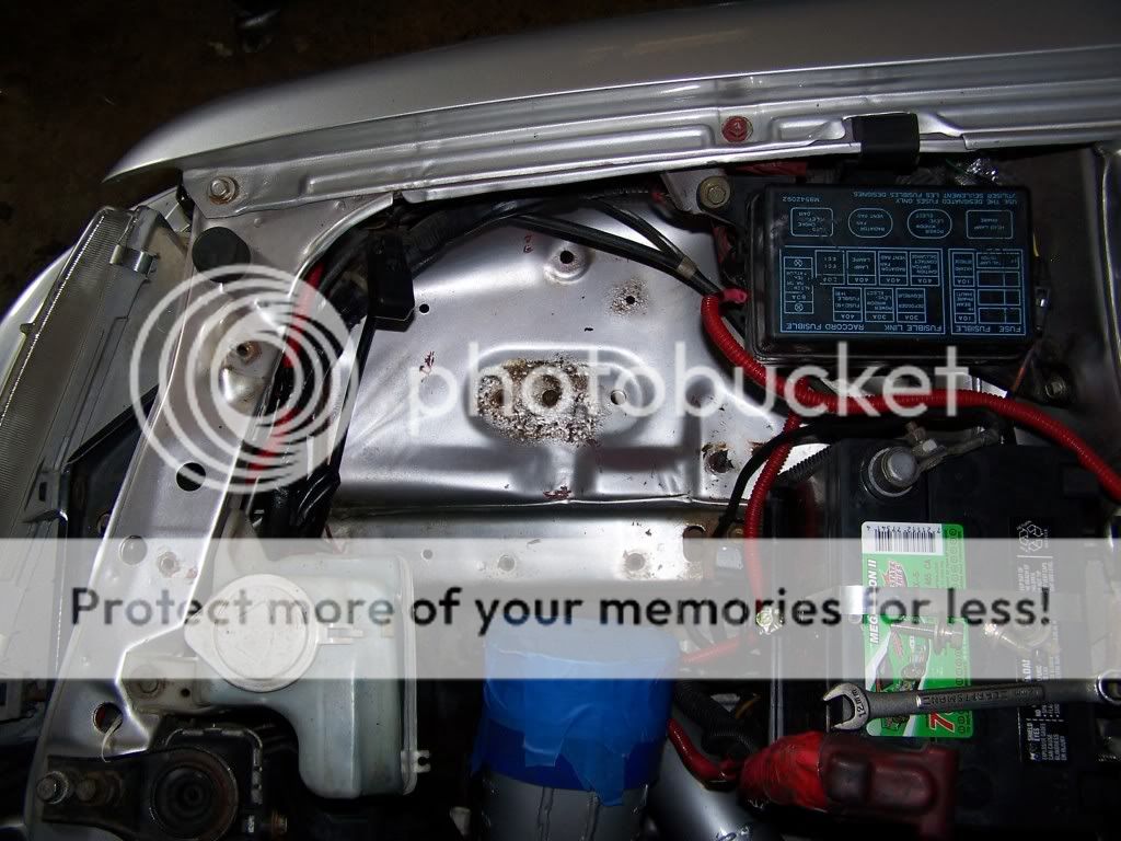

There has to be some better use for that rusty spot!

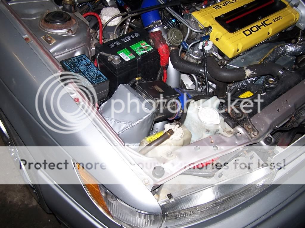

I don't know if this is possible, but it seems like my intake air temps are colder than it is outside now. DSMlink showed as low as 59F at one point! :supz:

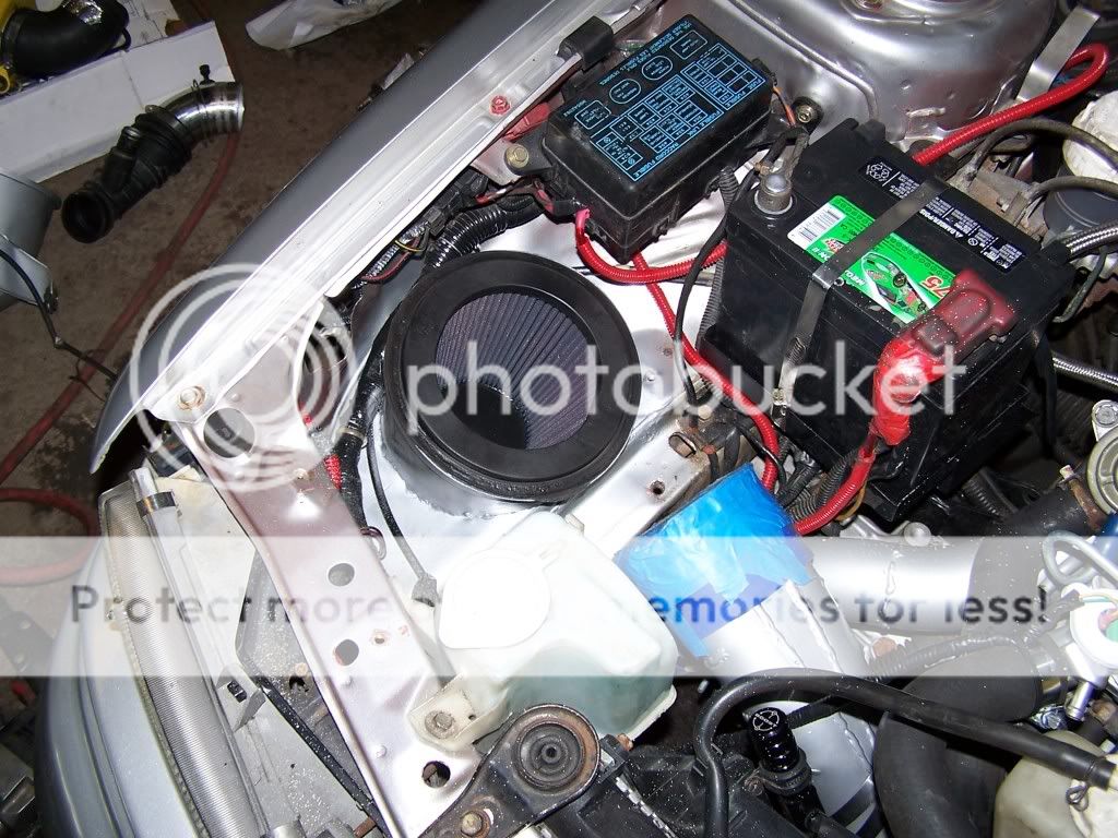

Looks pretty cool. I don't doubt the intake temp difference personally. I do wonder about vibration to the MAF unit though and the twisting motion of the motor. Hope it doesn't break off or come apart from the hose. Cool idea tho. Pun intended.
PostPosted: Tue May 26, 2009 11:35 pm
Yeah you're right. I've been a little worried about the force against the MAF and turbo inlet too. I'm going to order those silicone couplers with the bulge in the middle, to replace both of the ones on there. The MAF and intake pipe are about an inch apart inside the coupler so the more flexible couplers should help a lot.

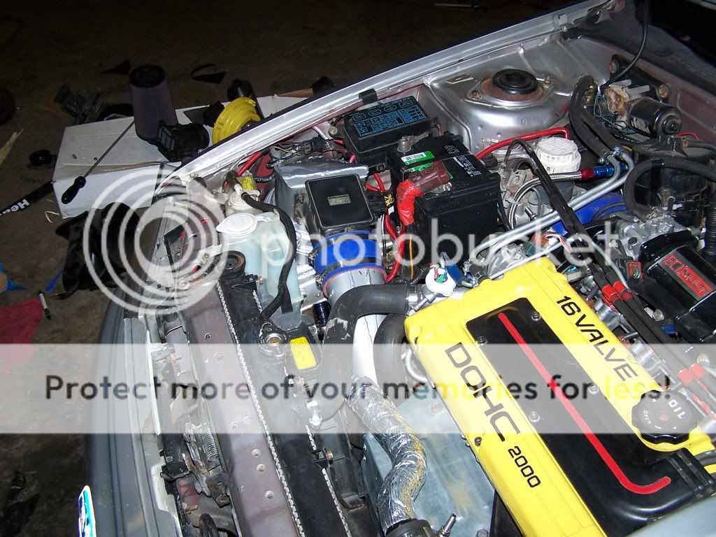

In other news, I attached one of those long K&N filters to the end of my 1g K&N filer today. (the two from the previous picture) Combined, the two filters reach to the bottom of the bumper cover. I shouldn't have any kind of restriction caused by my filter media. There's probably enough filter media to make a car cover if you stretch it all out LOL.

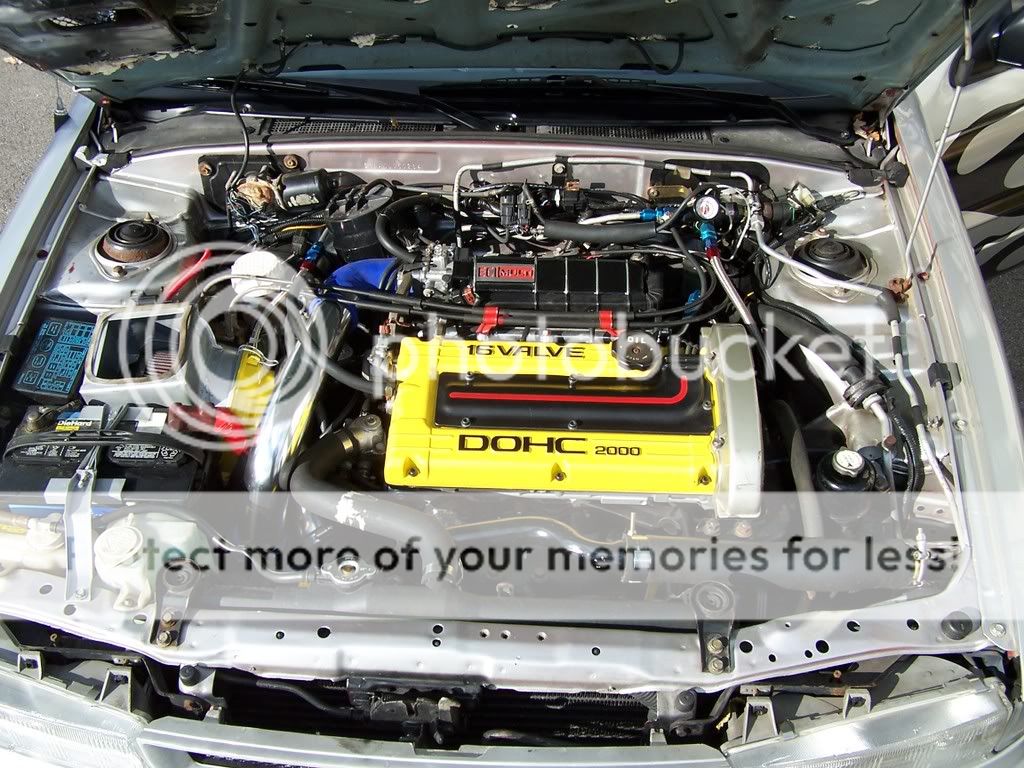

Looks good! I always enjoy watching people do things differently on their cars as it inspires me. Completely off topic but I would sand and paint the strut tops and the windshield wiper motor. That would add the finishing touches to the engine compartment in my opinion.

I think that's a decent idea putting the filter in the way you did, but you should grind down those welds. It looks kinda cheap and takes away from the fact that you did something functional. And yes, you should get some kind of flex in that thing since the motor itself will move and cause issues in time.
