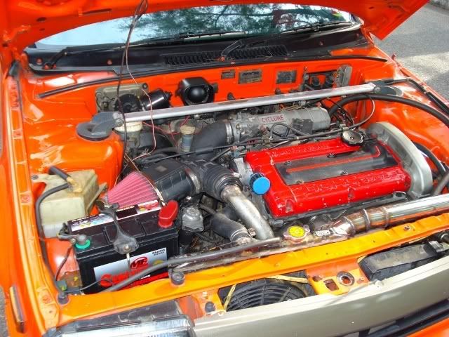

my car is a 1992 proton saga (similar chasis as the japanese mitsubishi lancer fiore c12)..owned this car from 2002 onwards...the original engine was a 1.5 12 valve single cam carburetor...getting bored of this engine, i decided to convert to a 4G91 electro-carburetor, getting bored again...i upgraded the carburetor to a dcnf 36 weber carburetor...after a quite some time playing with this engine...decided to go for a fuel injection system which offers more room for modification...i transplanted a 4g61T and have been using until now..
Mods:
mirage 4G61T
1. TD04L twin blade from mitsubishi lancer GSR 4G93T
2. mitsubishi 4G63T evolution III throttle body
3. mitsubishi 4G63T evolution III cranksensor
4. mitsubishi 4G63T evolution III full engine wiring with coil and power TR unit
5. mitsubishi 4G63T evolution III 510cc injectors
6. mitsubishi 4G63T evolution III ecu
Future Stuff:
1. would love to add a waste gate...but i don't want to upgrade my turbo..TD04L is enough for me as I'm not a racer.. :D
2. walbro fuel pump maybe....
3. full custom made drive shafts..
4. redo my intercooler piping as my current piping now looks poor

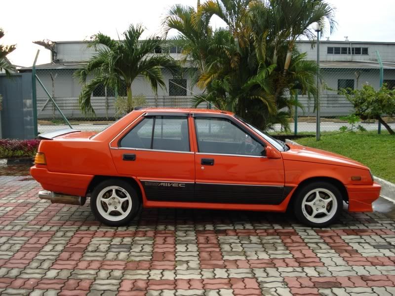

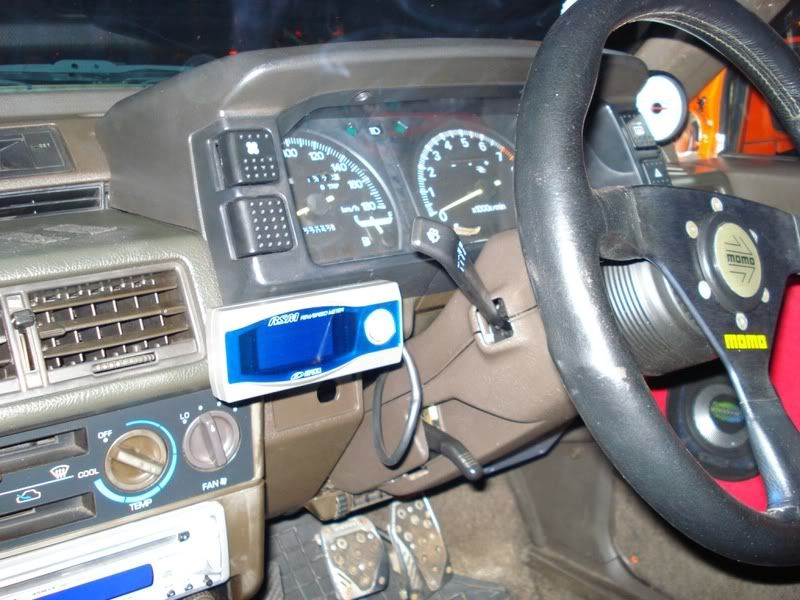

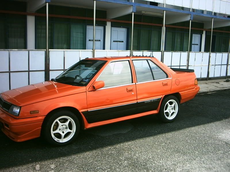

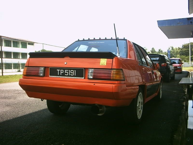

pictures of my car:

That really is a nice car. Was the swap easy?

Thanks for stopping by and keep coming back if you like what you see here. The one thing I don't understand much is the high end on the Protons, it must be hard to lower them without much of an issues with larger exhaust still having clearance to the body right?

*EDIT* Love the black and orange color combo and the vortex generators on the roof.

actually its not that hard though to lower this kind of car...its just that some kind of trend here in malaysia to have a high end (people goes for the looks....sacrificing car stability when cornering)...anyway this car doesn't have any hi-lo adjustable abs for the rear, as the abs and springs are separated...option is only for soft-hard.
you know something...there are even much more higher end compared to mine..up to the point that, if u were watching it in front of your eyes...you'll find it bizarre and peculiar :rolleyes:

turbomirage89: the swap was quite easy...because this car nearly shares the same chasis as 4g63 vr4 and 4g61 mirage...just a bit of mounting modification..no modification on mounting points at all...mounting points remain the same..i would say a plug and play transplant...
there are plenty of people here who transpalanted a 4G9 series to this type of car...but not plug and play though...

I love the way it looks with the rear end a bit higher!
