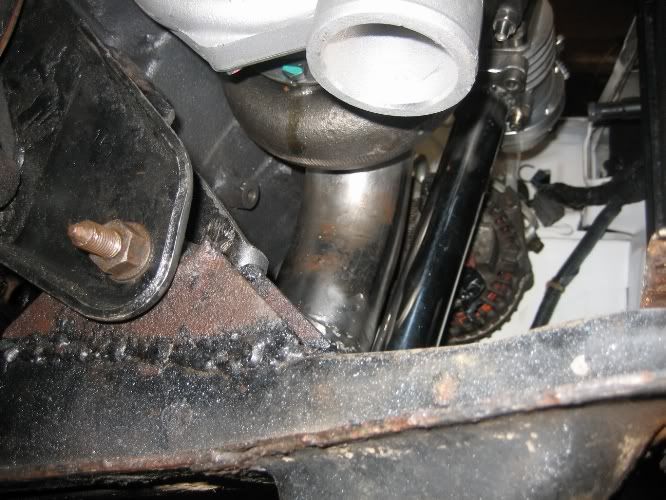

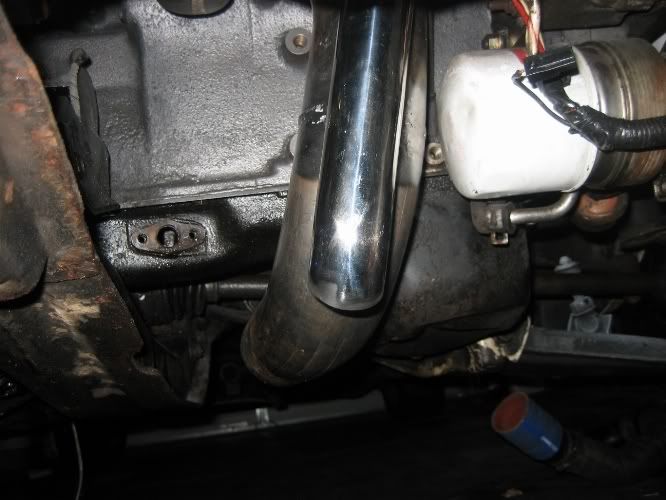

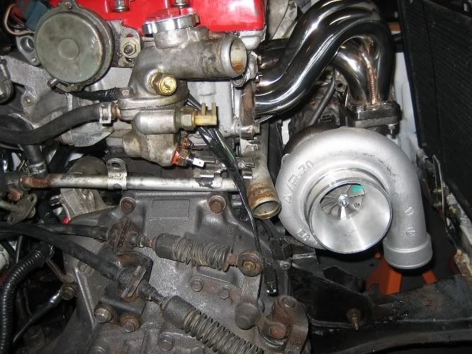

I didnt have to work yesterday, so i decided to bust ass on this thing, and get it done. I started working on it about 1pm. and stopped about 12pm.
i put the flywheel/clutch on. then put the trans/axles in. Had to wait on the gf to bring me New oem strut tops.
i then put the manifold/turbo on. made a down pipe. put the wastegate on. and then made a dump tube. Started making the upper IC pipe, then realized what time it was and decided to call it a night!
The set up is.. garret 60-1 with .82 a/r exhaust. SSAC manifold, and 44mm wastegate.
I need a few feet of straight to finish the DP, and put a muffler on it! hopefully i'll have it in a day or so.
Saturday is the last day the track is open. So i'm tring to get this done, and go down and see what it'll do. I'm thinking on 15psi. about 110-115 traps. I think the stock cams will hold it back for a bit!
Also had the GF clean the hood too. The left is clean, the right isn't
