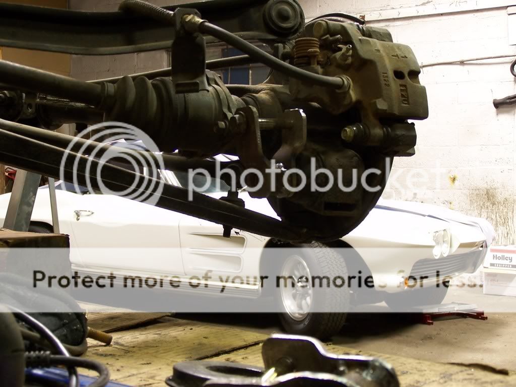

Looks good, I'm with Trev on this one though, I don't think you needed to move the bottom mounting point that much if you already modified the top, esp if your running the coilovers I see in the background.

So these struts were also 8 inches shorter than stock?
Yeah I had the new Struts on the car and the wheels bottomed out in the wheel wells. This was what I had to do to make them work. I dont think both of these mods will be needed to be done by everyone maybe just one of them. But this is what I had to do. The new Struts were all the way extened also. This will give me the adjustment I need.

Holy bejesus batman! Where do the calipers go?

I have mocked up the caliper and all I have to do is "notch" the new strut mount and it should work.

That's good you're able to make it work still! Although you probably could have gotten away with some big front brakes, sense most of the braking comes from the front anyway.

So I've been lookiong at what I did and I think I'm going back to the way it was.

Alright I picked up a new rear end for the car and putting the strut mounts back to original DSA specs.

Here we go, new parts all around. Rotors and calipers are on. So are the rear axles.
