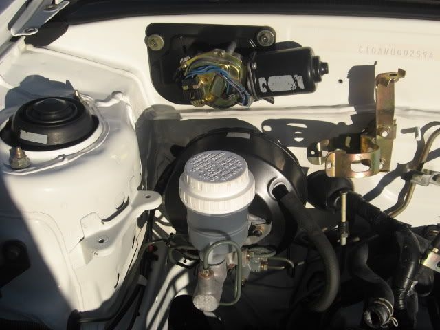

It was almost 70 today and clear so it was the perfect weather to break out the pressure washer. Armed with some purple power degreaser, some old rags and a scrub brush I went to it. About an hour later it was looking like new again, even the underside of the hood.
Now I need to pull the dash and get the wiring harness out and finish building my engine. Once that is done I can drop it back in and the rest should be easy. I'm not sure how well it will run but I can promise that it will be clean. :P

Your car is far cleaner than mine but then again you don't have to deal with salt and snow. I will try to make mine that clean.

:o :o :o :o :o Holy!! Mr. Clean!!!! :lol: Dude, somehow clean just doesn't quite cut it. I think that I saw God in that engine bay! Good luck on finishing the swap, Chris. I haven't acknowledged your work yet.

I got lucky finding this car as it is 100% rust free, even the bottom of the car still has the factory undercoating. I felt it would be a shame if I didn't take my time on it and get it perfect, well as perfect as I can get it.
