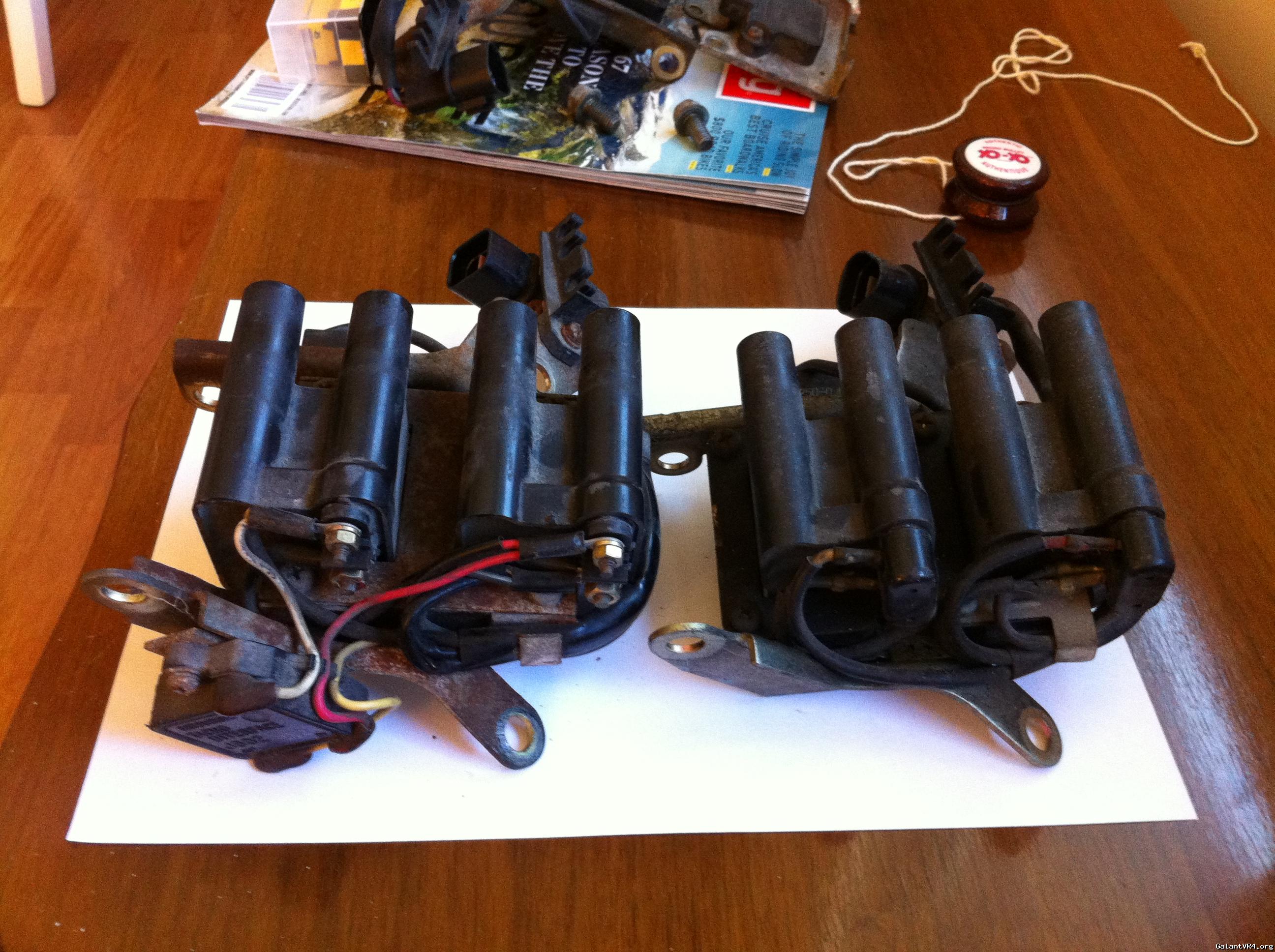

Yes, the Cyclone coil bracket modded to work with the 89 wiring setup. This means that I had to make some threaded holes on the thin lip at the base of the coil bracket, to mount the tacho interface module in place.
Like this:
More pics and larger pics located here in this thread: http://www.galantvr4.org/ubbthreads/sho ... ost1144366

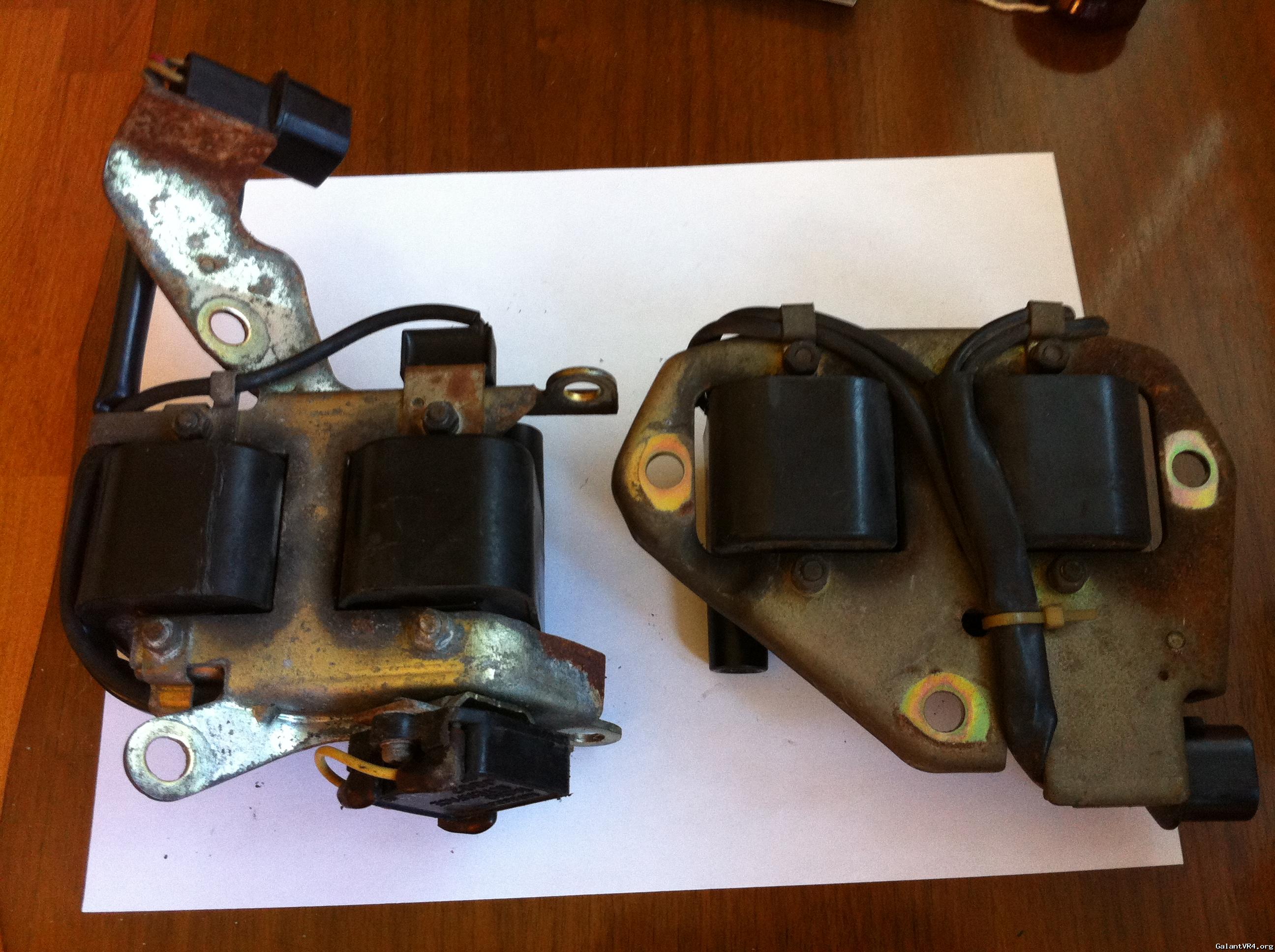

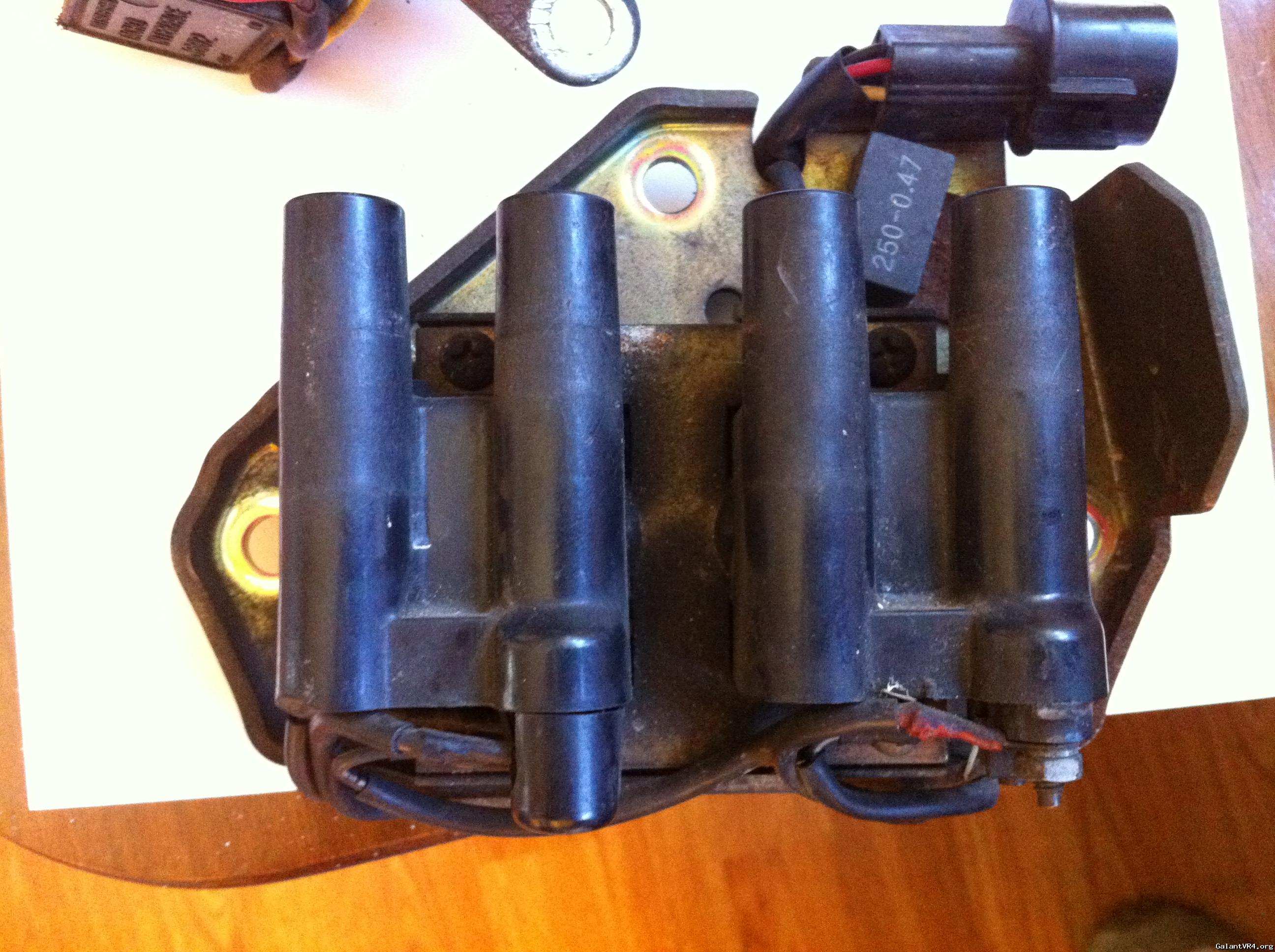

Cyclone coil packs and Power Transistor arrangement per ASA Japan.
[image]http://www.galantvr4.org/img.php?id=150874&width=400[/image]

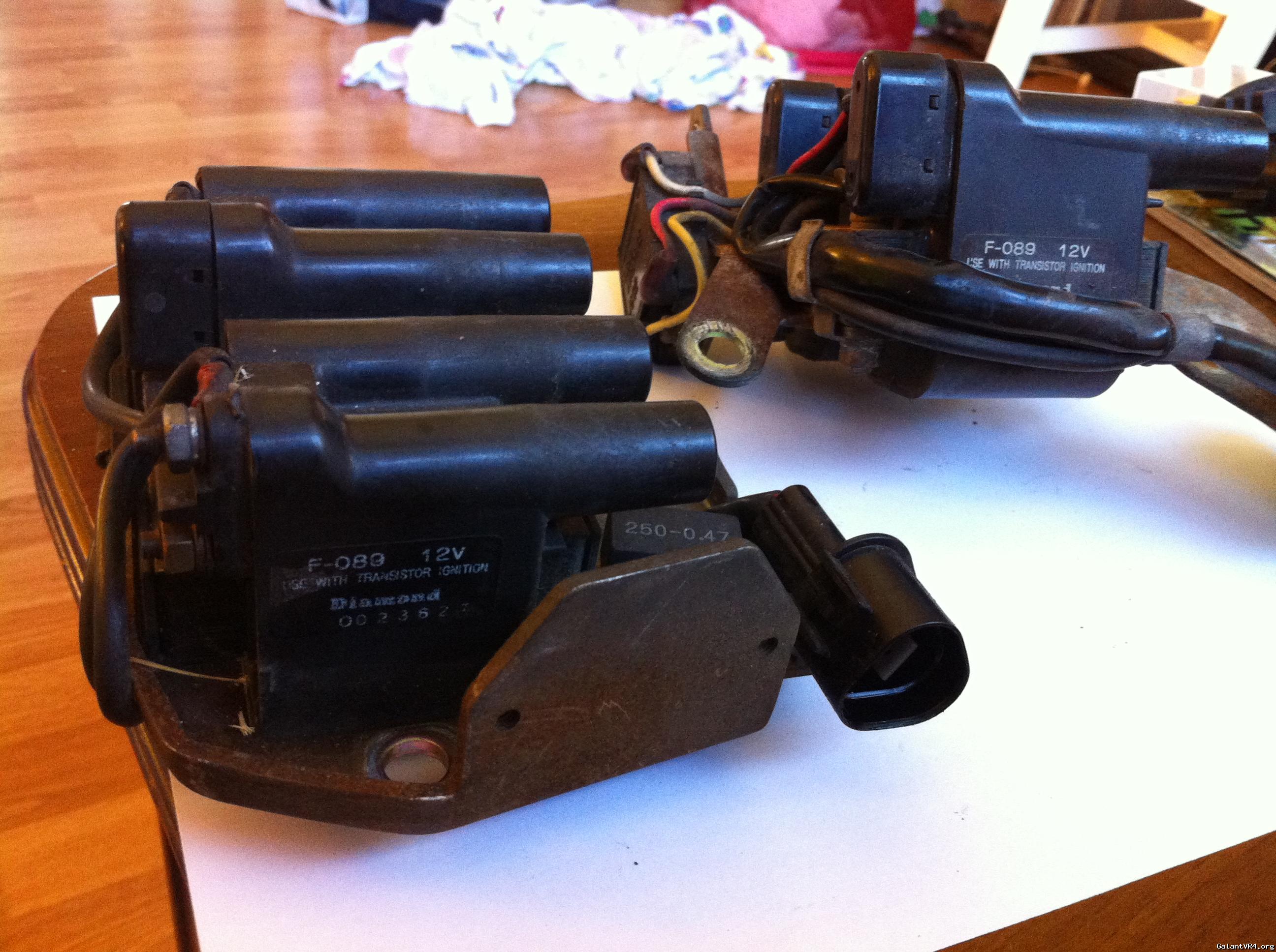

Coil pack comparison: USDM 89 Colt/Mirage 4G61T with Tach Adapter for proper tachometer operation (90 DSM essentially) versus 90/91+ JDM Cyclone/ECI Multi Dual runner
Side by side --> JDM left - USDM right
Notice the small plate area with two screw holes, already tapped and ready to accept a Tacho Interface module .... surprise, surprise! Different era clusters getting that same bracket. I figured this out late in the evening, while wondering where to place the tacho interface. I mounted the tacho interface to this plate, but wires whether in original orientation to the coil studs, would not work, nor would they work with the wires switched at the tacho "IN" terminals (there are two terminals), and switched at the studs.
Solution : extend wires - which I am not a fan of doing, or drill two holes in the base plate, on the lip that comes up from where the coils mount, and directly centered below the two coils. I'll post pics when I can get that drilled and tapped to accept the stock screws.
[image]http://www.galantvr4.org/img.php?id=150875&width=400[/image]

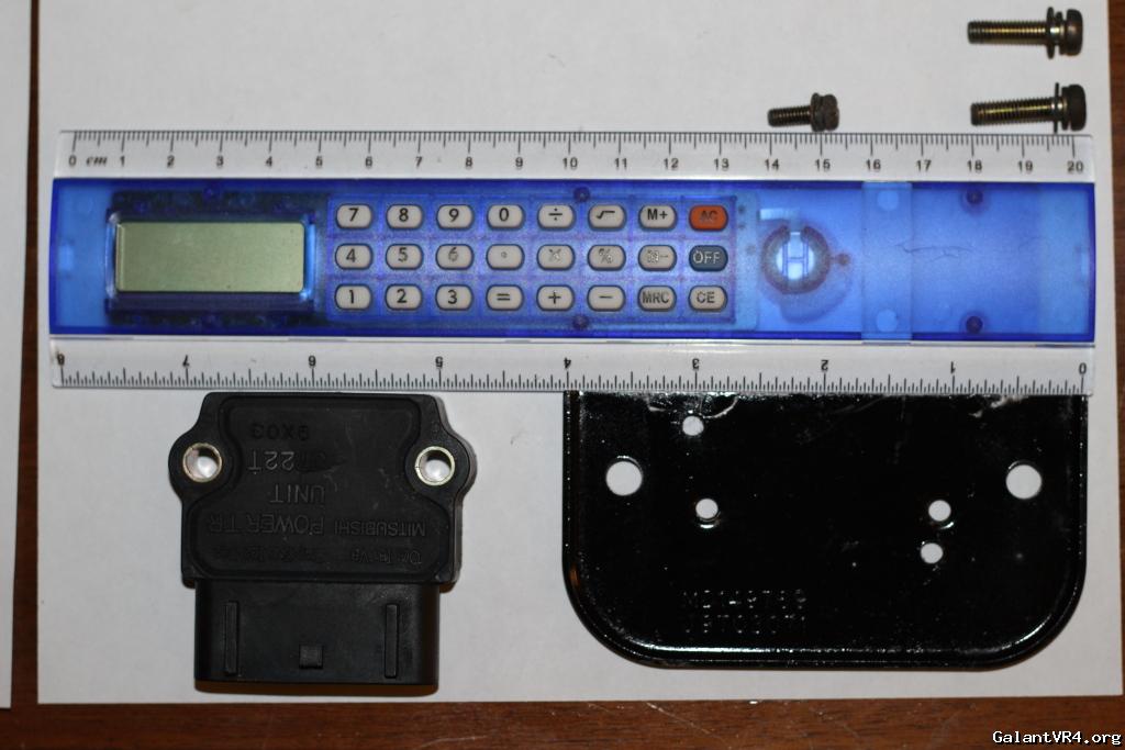

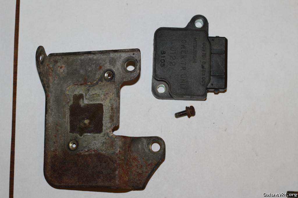

Dual runner transistor plate and transistor appears to be 91 USDM style.
[image]http://www.galantvr4.org/img.php?id=150990&width=400[/image]
Plate drilled to accept 89 Colt/Mirage 4g61t/90 DSM style transistor
[image]http://www.galantvr4.org/img.php?id=150992&width=400[/image]
89 4g61t/90 style transistor with original plate
[image]http://www.galantvr4.org/img.php?id=150993&width=400[/image]

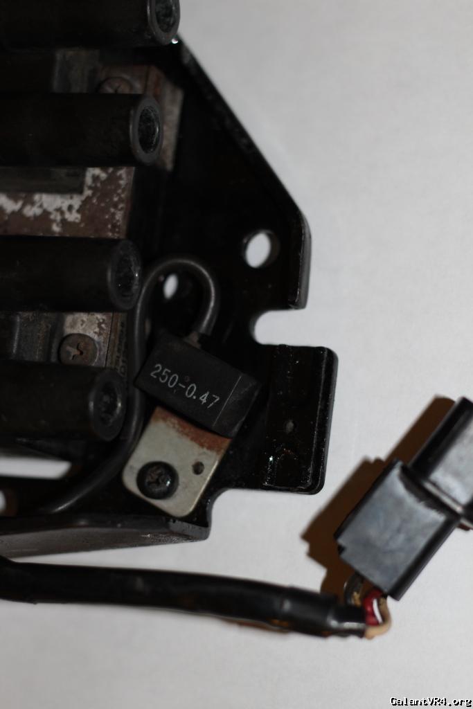

Newly drilled holes at base, allow tacho interface to be installed in close proximity to coil packs. If you want to lengthen your wires, you can use the original location that the tacho interface would have been installed on the side plate. Holes are already drilled, but the wiring on these models wasn't meant for this plate, so it was modified to work.
[image]http://www.galantvr4.org/img.php?id=150995&width=400[/image]
[image]http://www.galantvr4.org/img.php?id=150996&width=400[/image]
[image]http://www.galantvr4.org/img.php?id=150997&width=400[/image]
[image]http://www.galantvr4.org/img.php?id=150999&width=400[/image]
The 4 wire connector does slide right onto the mount rail beside the black box labelled, "250-0.47"
[image]http://www.galantvr4.org/img.php?id=151000&width=400[/image]

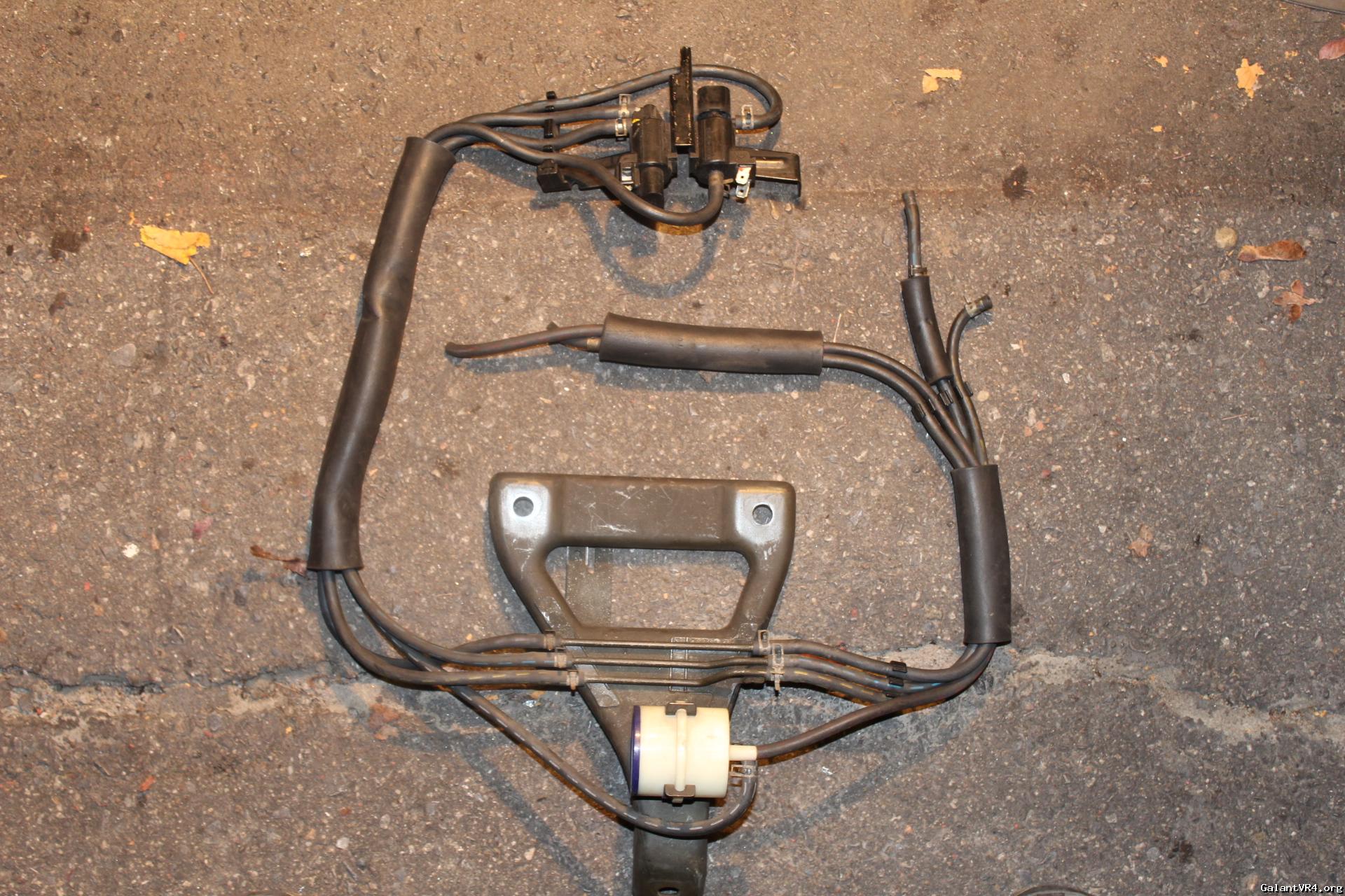

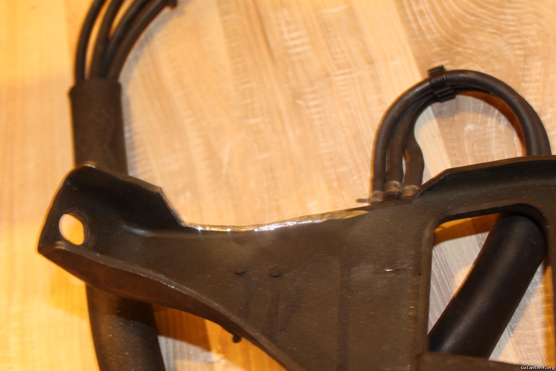

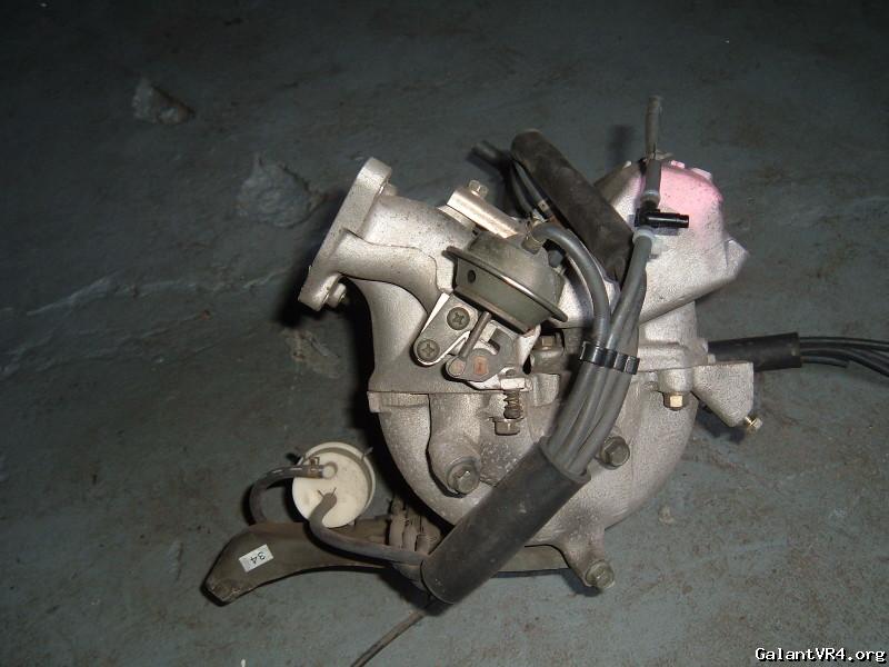

Last night I modified a few things to fit the Cyclone support bracket into my engine bay.

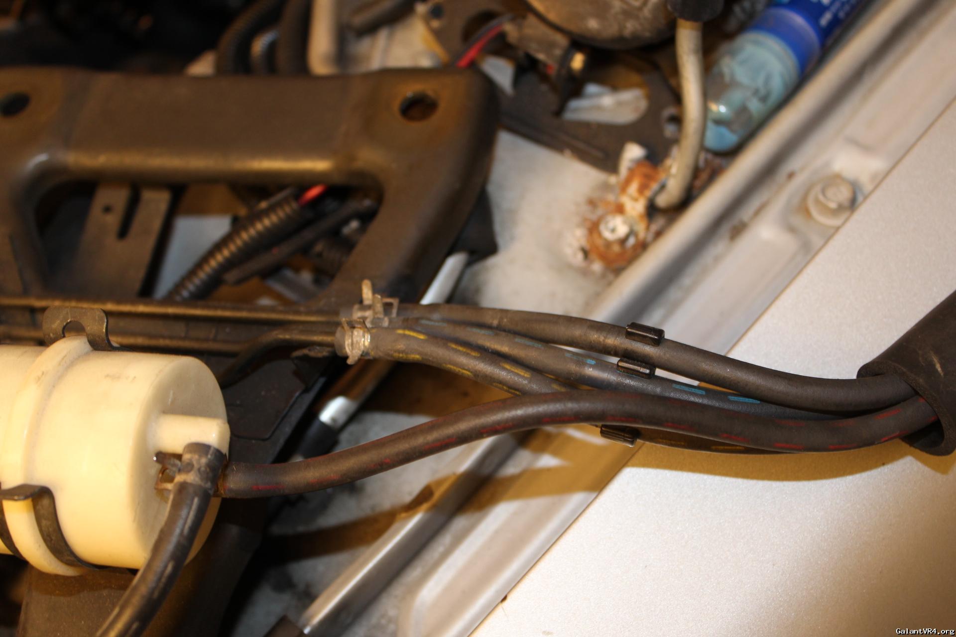

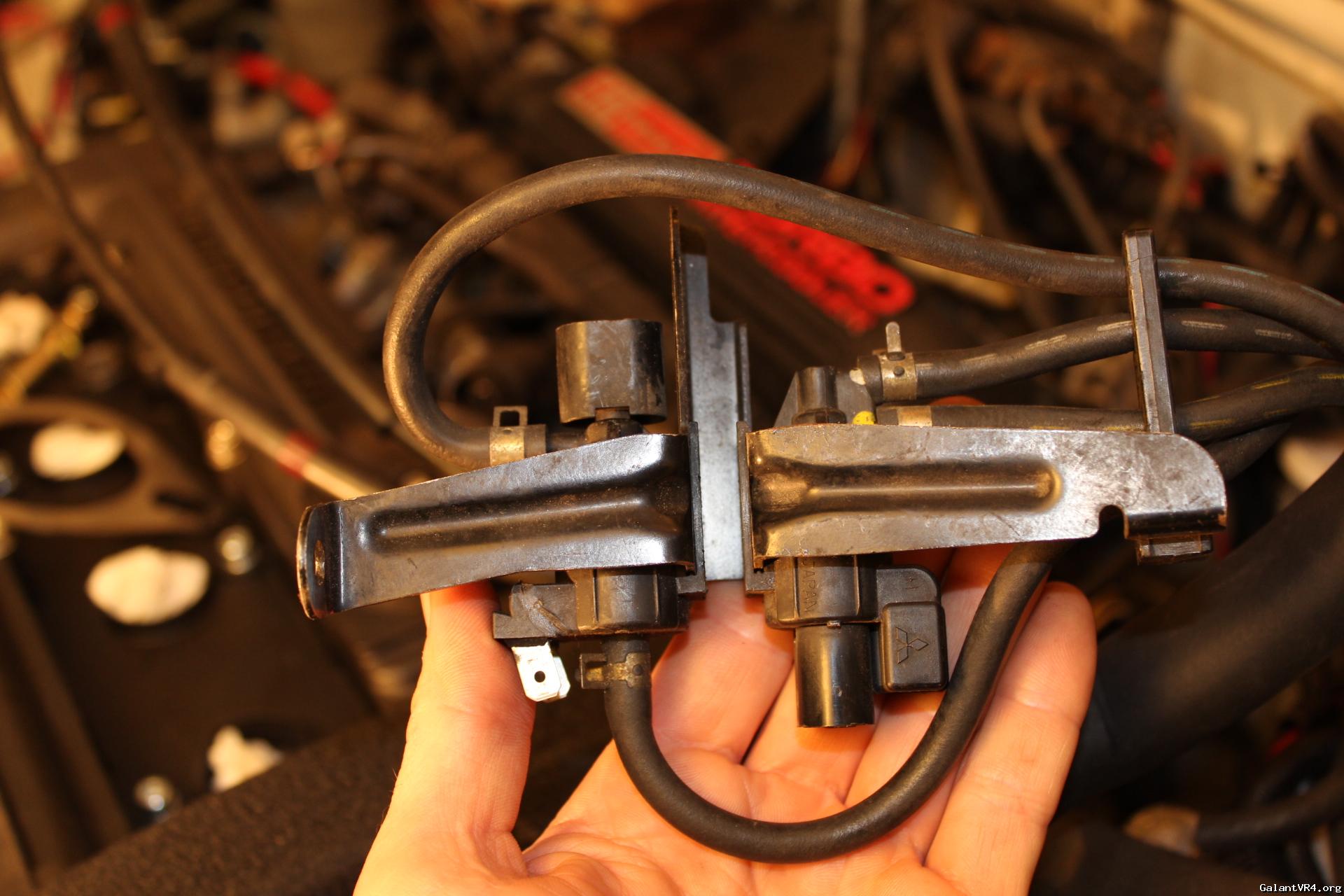

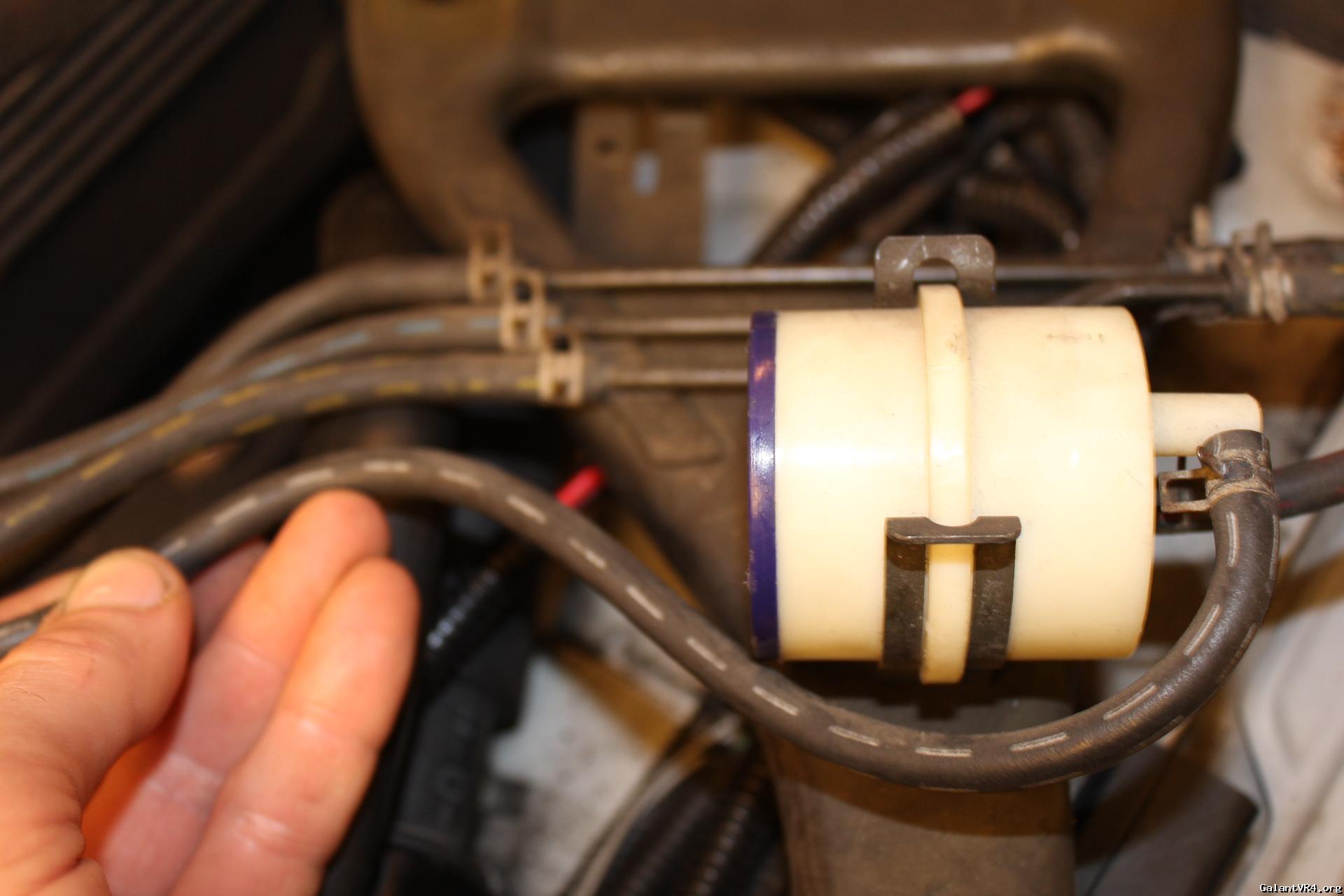

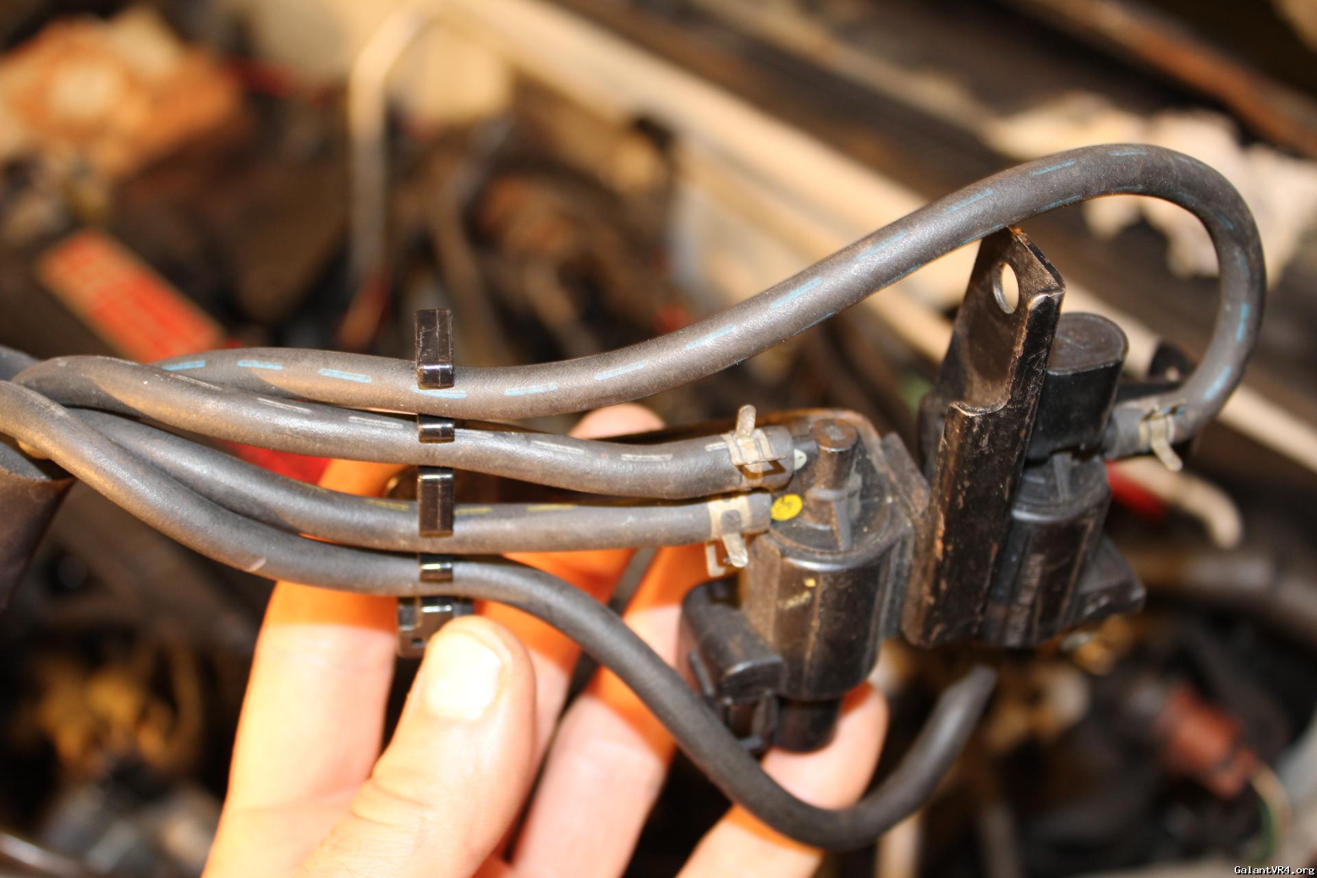

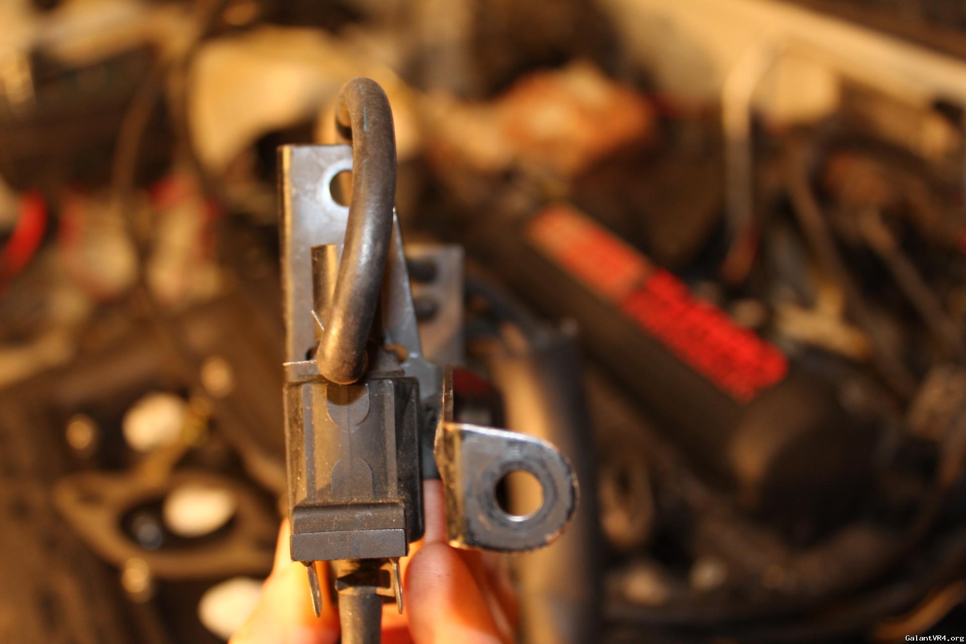

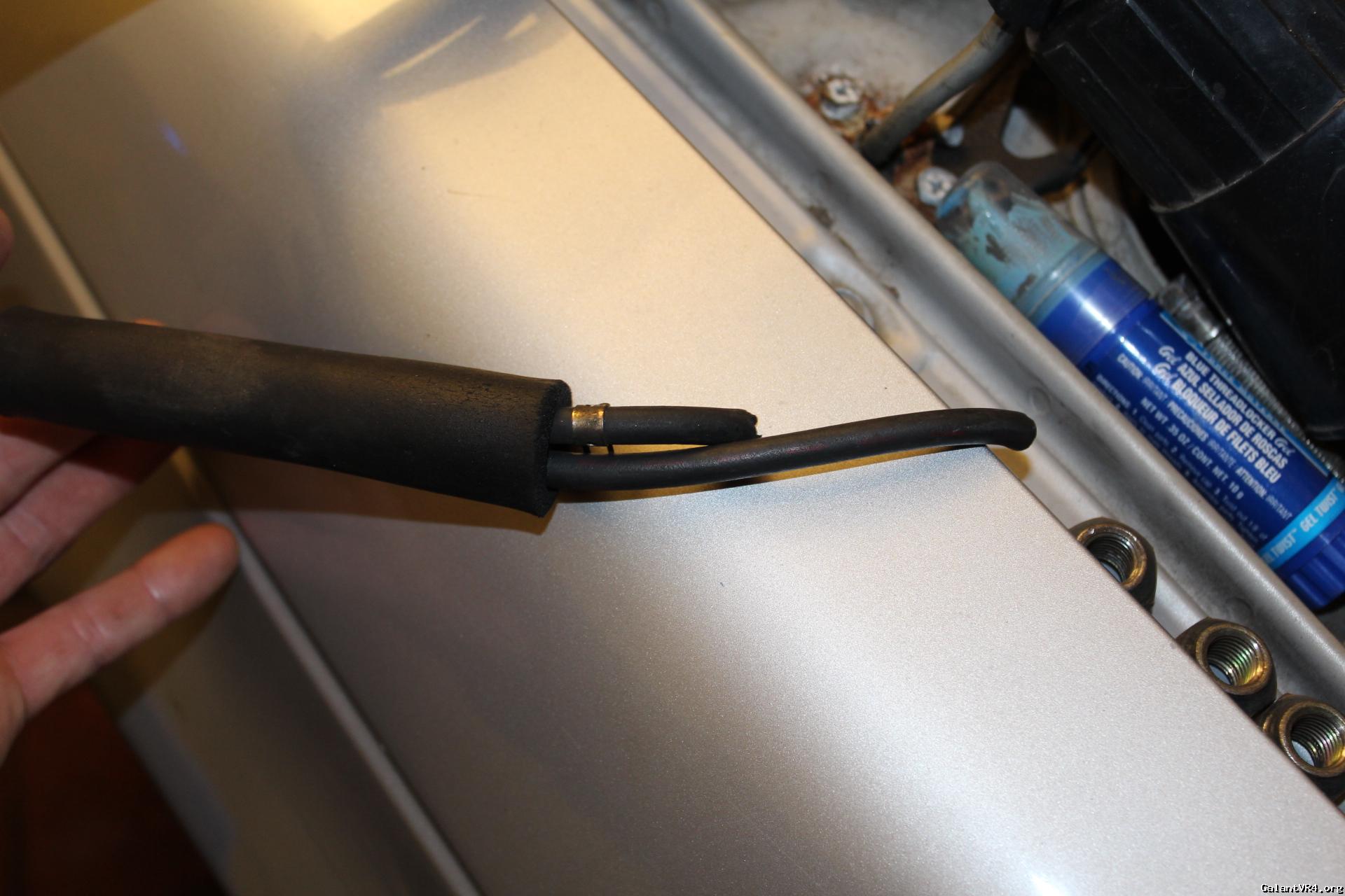

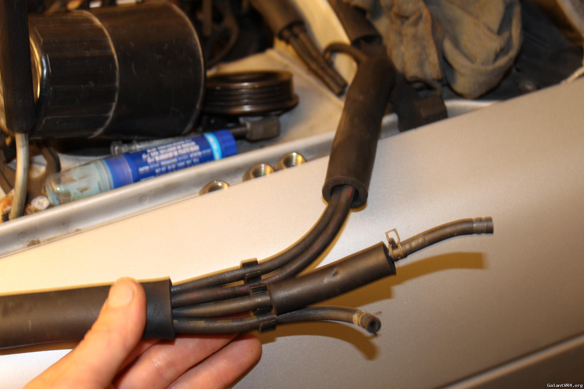

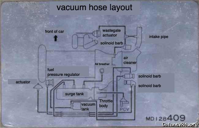

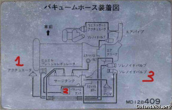

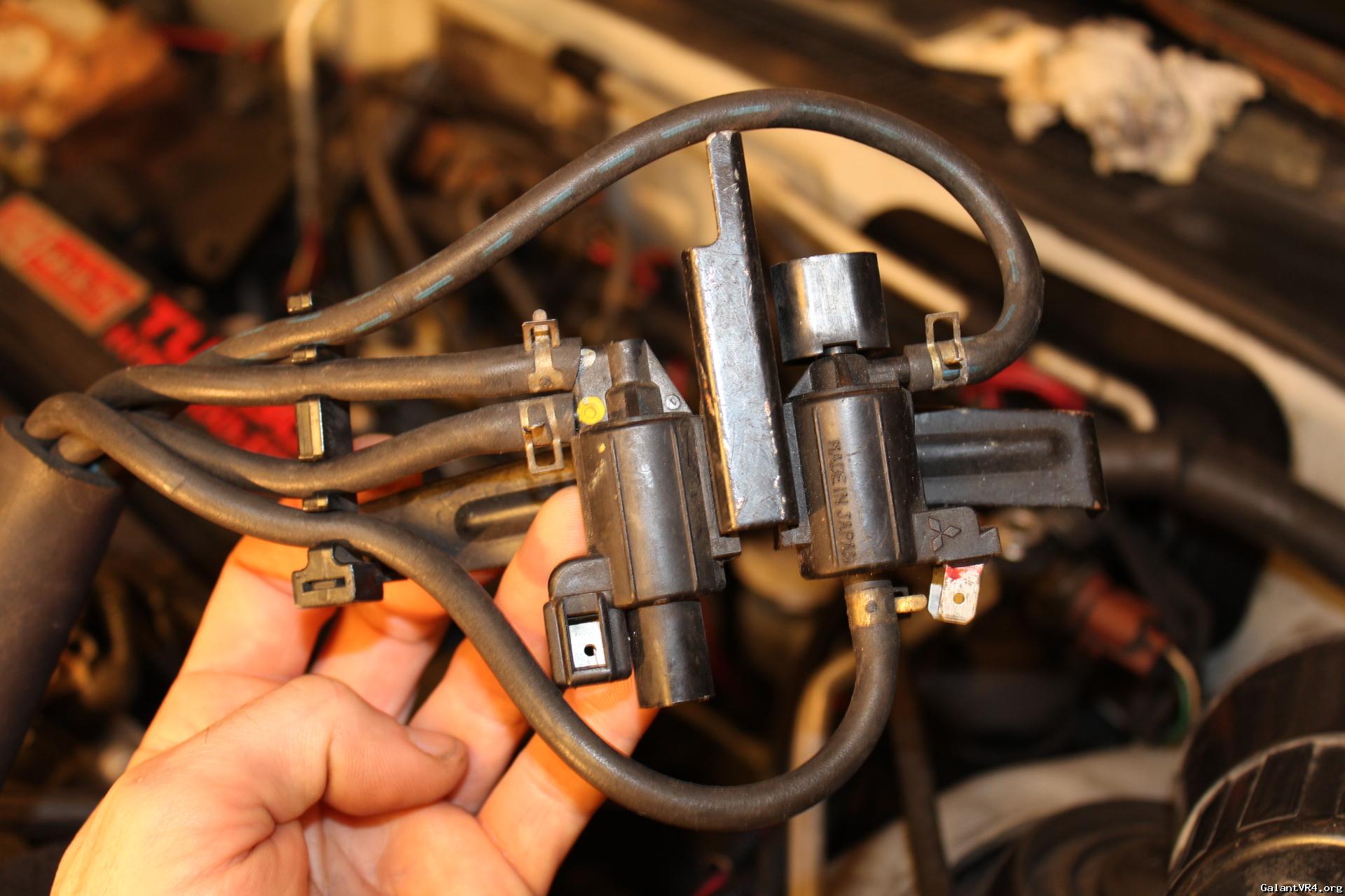

Here is a basic rundown of everything you need to see for tracing out vacuum lines on the cyclone setup.
Further cutting to the support was required due to contact on one small bolt head at the compressor housing. I likely cut out a little more than is required, but nothing is moving on the back side of the motor. Not compromising structure, but it will be painted to keep it from rusting.
This will be like a color coded, adult required for assembly, kids play toy. The vacuum lines are color coded, making their installation pretty easy with the correct diagram.
You will see color dots on the sensors - likely only original Mitsubishi sourced sensors are color coded this way, but now you know the solenoids to look out for, or that can be matched to look original/work the same way. The color dots match the color code hash marks on the vacuum lines!!!! :P
One vacuum line or two do not have color codes on them.
More of Cheekychimps Cyclone manifold views and diagrams via Misterfixit:

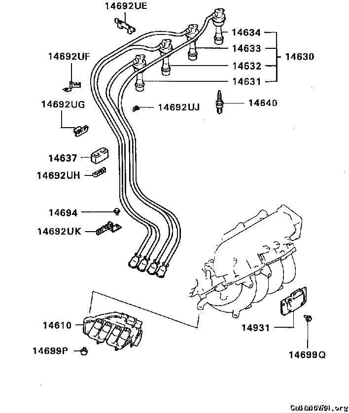

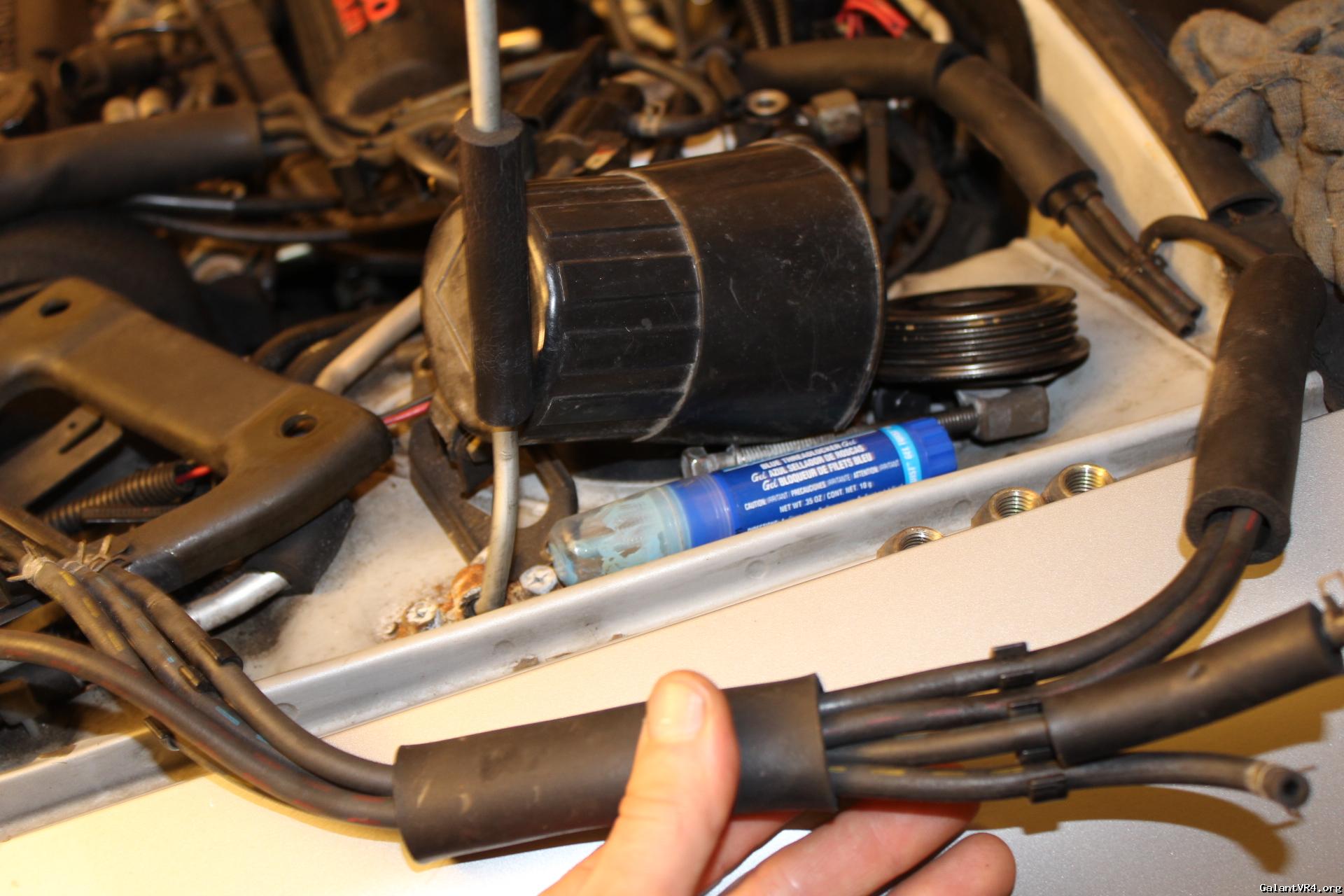

Using NGK Blues for plug wires, you do not need longer spark plug wires unless you wish to preserve the original coil pack wiring orientation and subsequent swap of the coil wiring and plug wires to suit this.
I shall elaborate.
NGK Blue 7mm wires that are probably the most common standard wire for our 4G6X engines will not fit, lengthwise in their labelled positions or otherwise, when using the Cyclone manifold, original Cyclone coil pack location and standard spark plug wire bracketry located in the spark plug/head cover area. SOLUTION! You can manipulate the system.
I now have the pictures to show what you need to do, saving much time and headache for someone wanting to jump right into this installation scenario.
Okay, using a Cyclone manifold, original Cyclone coil pack bracket and Cyclone Transistor plate all these pictures will make sense. If you do not have the Transistor plate, you simply need to make a plate. If you do not have the coil pack bracket, EHMotorsports just showed you in the last post, a HOW-TO on creating one.
Let the pictures begin!

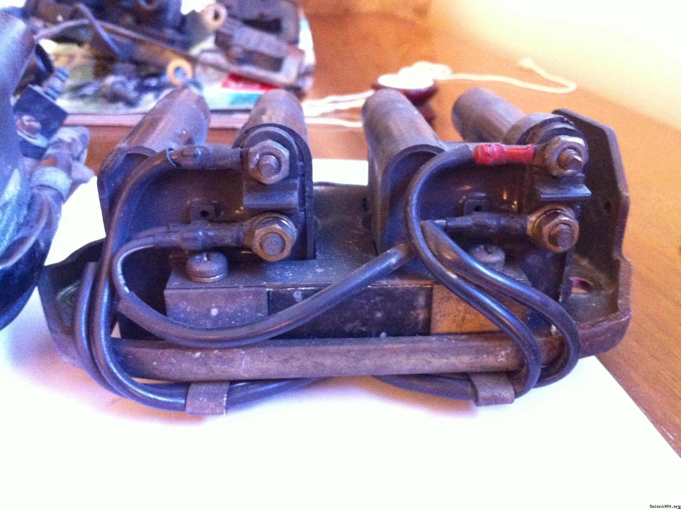

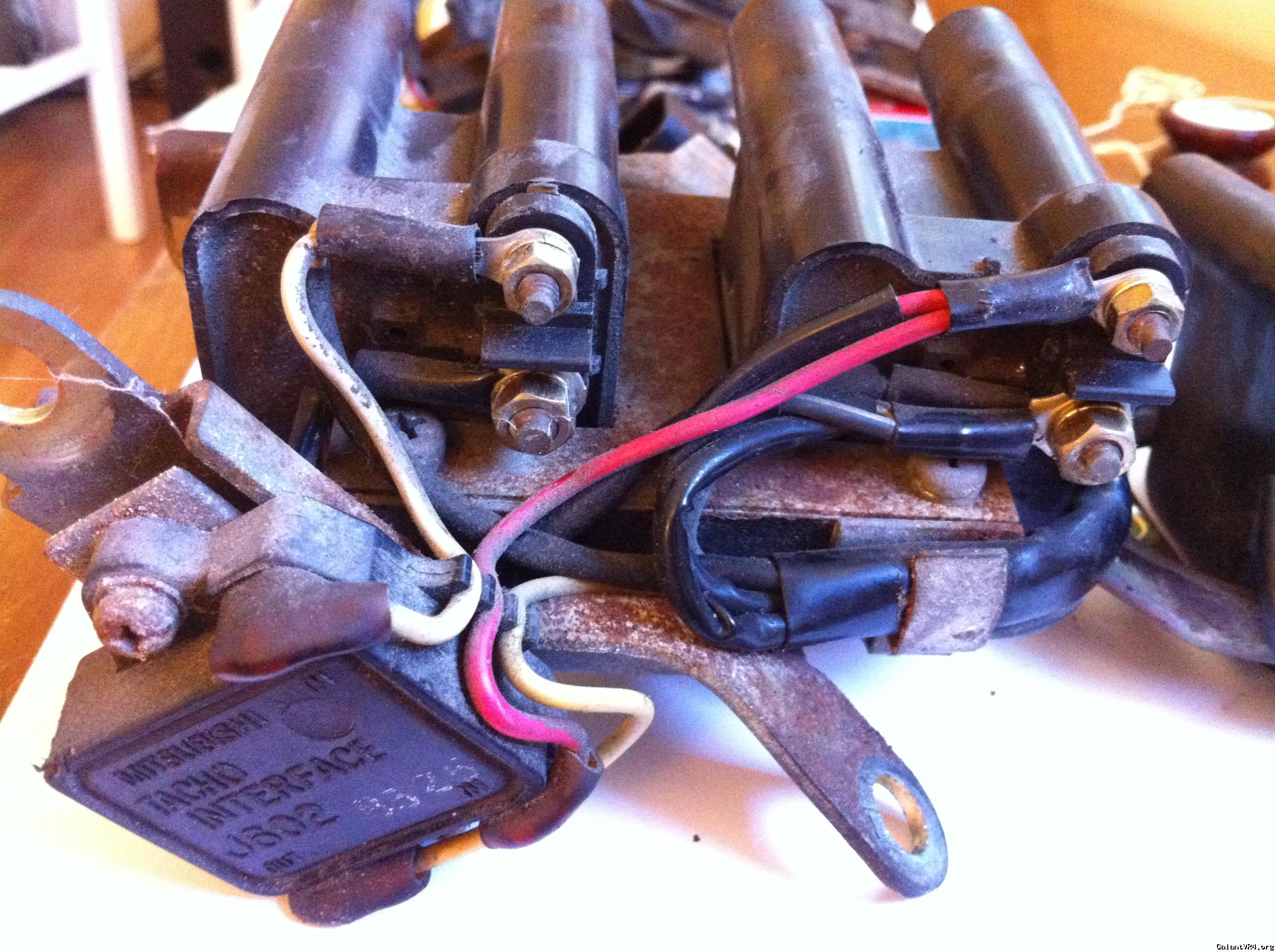

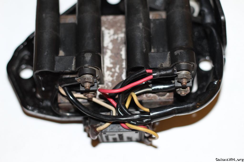

Re-wiring the coil packs, essentially swapping the wiring from the left coils, to the right and vice-versa, leaves the spark plug locations as follows:
Visual on the wires. First photos will be PRE-SWAP (ie original orientation as you might find them fresh from the factory. Pictured is the 1989 Mirage/Colt wiring, likely identical to the 1990 DSM.
Original positions as follows:
MODIFIED locations and wiring schematic, just in case anyone is color blind:
Notice the covers in the background, you have to notice that they have different sized holes for the wiring to come out from the towers, they must be switched side to side.

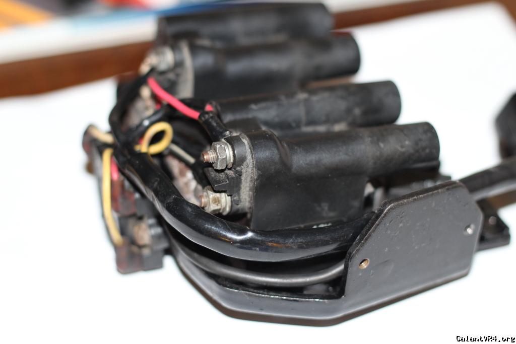

Final note for the coil wiring towers. Seems Mitsubishi liked to change the nuts that were used between the Mirage/Colt and DSM posts. They used 7mm nuts and 8mm nuts for the smaller of the posts. If you can get 8mm nuts, it will make working on the car much easier, should any wiring ever have to come off again, because what else on this car is 7mm!! 8,10,12,14,17, 22mm .... haha. Saved you the headache of not having brought the correct tool home.
So, you now have the coils wire locations figured out, but you need to disregard the plug wires orientation going over the rocker cover because the NGK Wires are not long enough to achieve proper fitment if you use the coil pack in the stock Cyclone location. Pics will show what you have to do, to make them fit snugly.
First attempt - COULD NOT FIT THE WIRE COVER IN PLACE IN THIS ORIENTATION, but it does look pretty. If you had longer or custom wiring, the old throw back thought to King wires comes up, or a call to NGK, you could use this orientation. Coil pack wiring is still swapped to achieve this.
This is the wire orientation I found worked best, and everything fits, including the spark plug wire cover! NOTICE THE WIRE FLIP NEAR THE OIL CAP AREA!! The wires extend straight down after that.
Coil pack nearest the fuel rail. Going from the front terminal to the back, NGK wire #1, then #3.
Coil pack nearest the firewall. Going from the front terminal to the back, NGK wire #4, then #2.
Final outcome with all covers in place.
