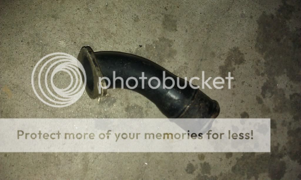

yeah come off the turbo with a 2 to 2 1/2" coupler..then run 2 1/2" pipe to the IC and up to the throttle body...the 2" will clamp down onto the J pipe good just use 2 hose clamps on it..
this is the J pipe.. as u can see there are 2 bumps.. put both clamps in between them and it will seal up good..
http://i548.photobucket.com/albums/ii33 ... AG0438.jpg
as for the intake.. u can make it however u like.. im going from 2" up to a 3 1/2" filter.. this is not as crucial as the IC piping so you can make it however large you want to.. alot of people use a 4" filter
