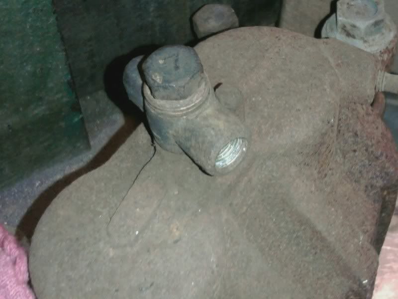

I am swapping to twin piston diamante calipers and gvr4 rotors, and want to upgrade to braided stainless lines during the swap.
do i need these adapter lines from roadrace engineering? or will the regular 1g gst stuff work like the rest of the swaps? need to know soon so i can order parts asap

Depends on what you got the caliper from and if it has the screw in style lines or the banjo bolt style like the rears.

For what it's worth I picked up these banjo adapters off the rear of an na laser at Pull A Part,saw them on a na Talon too. A 1g brake line will thread into the adapter. Calipers were off a Diamante with banjo bolt-style lines. I haven't used them yet but they appear as though they will work out fine.

good lookin out guys. i havent pulled too many brakes apart on alot of mitsus, other than csms and 1g dsms. the calipers i have are the inverted flare 1g style, so i just ordered brake lines for it.
fyi extreme psi has 1g lines for 115 plus shipping. sure beats the 190 for goodridge.
