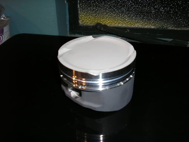

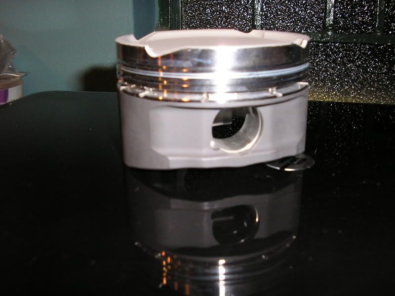

Hey guys, good news. For those of you wanting to source forged pistons for the 4G61, CP Pistons makes a forged 9:1 compression piston for the 2.2 liter 94mm crank DSM. This can fit into a bored out 4G61 block, and not protrude from the deck. You end up with a 1.7 liter 4G61. The CP Part number is SC7212.
I had mine ceramic coated.
