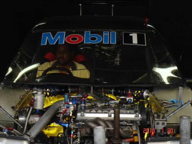

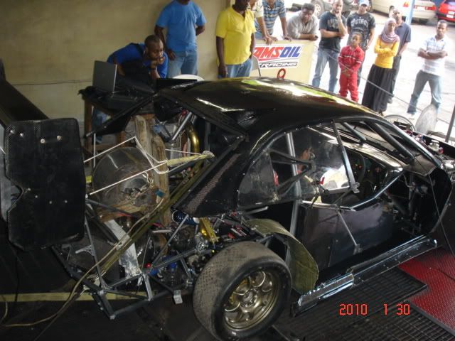

Update guys, finally got the motor on the dyno. Had a serious problem with the OEM Mitsubishi Ignitor, so I could'nt get the engine to run smoothly. Switched to an MSD DIS 4 and got two untuned runs before the rear diff casing cracked. Managed 275 whp @ 13 psi @ 5500 rpm.
Problems now fixed and should be back on the dyno this weekend.

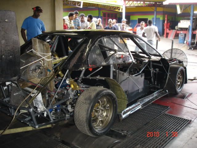

Got it up to 380 whp at 18 psi @ 7000 rpm, before the boost control solenoid quit. We mapped it to 9000 rpm and got 357 who @ 15 psi (wastegate spring pressure).

also, what is that wood for?
PostPosted: Sun Feb 07, 2010 2:11 pm
Looks like the dyno fan for the rad is hooked in to be aiming into the rad's sweet spot?

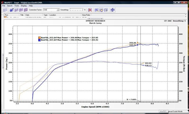

This was a 14.5 psi dyno run. I was unable to capture some of the higher rpm runs, but the power and torque pretty much follow the same trends as you can see below. The difference between the two is due to some minor changes in timing and fueling that we were experimenting with.
Making more whp than a stock Evo 4-10 makes at the flywheel, with less boost. And it's only 1.6 liters.
PostPosted: Fri Feb 12, 2010 4:58 pm
You need to rev that thing to like 9,500
