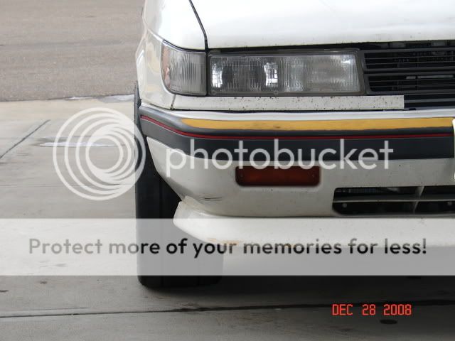

please do, and if at all possible what do you guys recommend for spring rates for drag use?
Notice the space between the tire and coil-over? It's about .5" to .75". It looks like I can still lower the car another 1.5" and still be ok.
I can't give you a spring rate for drag racing. I chose my rates for road racing and a little drag on the side.

Thanks for the pics, they are greatly appreciated, as for springs what are you guys thinking?
The consensus seems to be stiff in the rear and moderate in the front. My guess on the spring rate would be something like 450/500lbs in the front and 1200 in the back, please realize that's only a opinion. I’ve toyed with idea of making a lock out rod/bar for the rear to completely eliminate any travel while at the drag strip. Of course that’s gonna play hell on the unibody. The next suspension upgrade for me will be in the front, maybe camber plates from RRE or perhaps traction bars from DDL.

We run the 235/60/15 M&H bias ply. The circumference is supposedly 80", which would yield 25.5" dia., but at 14psi pressure I measured the tires to be about 26" even on the car. The tire width is about 9.25". I can't recall the wheel offset, but some sort of spacer is needed. On that car we run an 800lbs spring in the rear, and 450lbs up front. The car really doesn't squat at all upon launch. It has brand new struts all the way around, and though the ride is somewhat stiff, I don't consider it unbareable at all. We ride around 4 deep in that car all the time with no problems.
