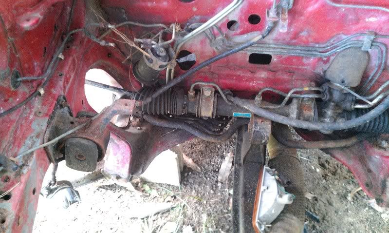

I found these mounts on the original turbo c53a mirage that i have on my backyard.I suppose if it was a 4G61t car these are the mounts i need to swap the 63T on my 1.5L chassis.

If that is an original C53a turbo car, then yes, everything will drop in using those mounts.
PostPosted: Wed Sep 28, 2011 7:23 pm
Yes sir,all this time i have the mounts that i need in my backyard.
Do you have the mount that bolts to the trans also?

Measure how thick the sway bar is, the turbo cars had thicker swaybars than n/a cars. I'll try to find what the thicknesses are for sure but I want to say 19mm for n/a and 22mm for turbo. Swaybars are one thing that many people don't change when they do the swap.
Edit-
I was close, 18mm 1.5L, 22mm for 1.6L turbo.
http://www.4g61t.org/forum/viewtopic.php?f=22&t=16167
Edit-
You can definitely tell its a turbo car by the sway bar thickness, you can also see the power rack in the pic. He has a pic of the firewall plate in another thread and the numbers come back to a turbo trim car.
