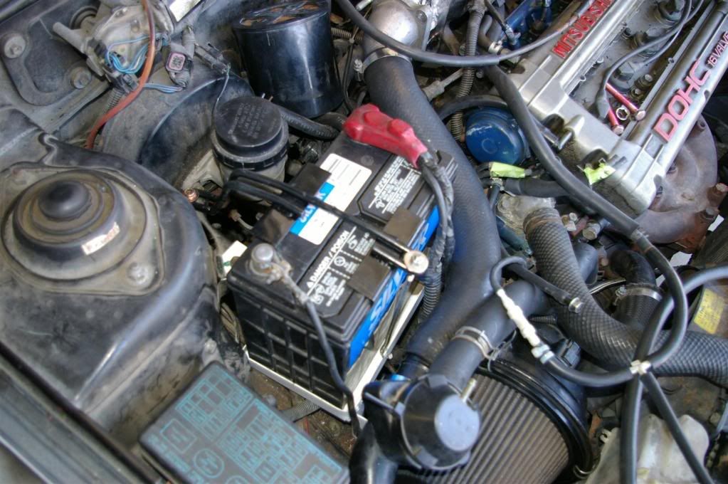

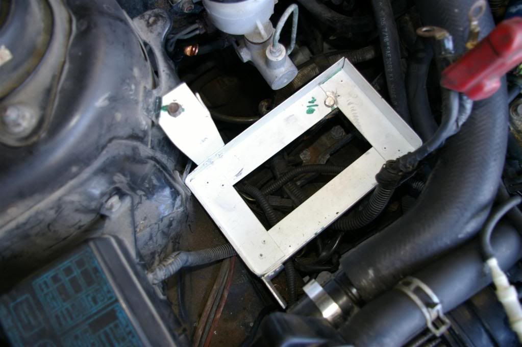

My car came with the battery in the hatch and not much room in the engine compartment with the 1G pieces. I built my own tray out
of aluminum angle. While researching I found that a universal boat battery tray might work for different applications, just not mine.

I have seen a few Civic size batteries placed with custom mounts in the location the Eclipse uses. It would need to be custom whatever you do.
EDIT: As I was writing this ^ attached the pictures lol.

PostPosted: Sun Mar 28, 2010 8:54 am
I run a Miata MX5 battery; it's tiny. I made a custom tray much like the one pictured above.
I'm bumping this one up.
Anyone know the original application for the battery in the pics above?? Or a size?
The hawker/genesis 16ep in the car will not cut it this winter.
Thanks!

PostPosted: Mon Nov 22, 2010 3:27 pm
Posts: 357
Location: St. Louis, MO
It's a group 51 battery, mine has 425 CCA.
PostPosted: Mon Nov 22, 2010 4:04 pm
Joined: Mon Jul 20, 2009 2:57 pm
Posts: 98
Location: Golden, CO
Perfect!
I have the 1g DSM goodies (SMIC and Intake) so I will be building a tray just like yours.
