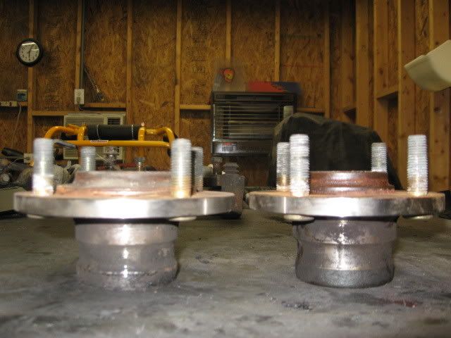

Here is the start I got today at work: ARP extended wheel studs are sweet;)
I compared the expo hub to the eclipse hub and they are the same size. I think you could also just drill out the front hub just like the rear. They are the EXACT same! I got the knuckles powdercoated gloss black tonight at my buddies place, I will post pics later tomorrow.

off a 93 mirage
Looks the exact same as the picture on rockautos site for one off a 92.... just sayin

Close but not close enough.

Not even sure what that means but I'm trying to help you and save you some trouble. If you put a 5 lug dsm hub over the 4 x 100 hub you will see that there isn't enough material there to re-drill to 5 lug. The hub is physically too small to drill to 5 x 114.3.
