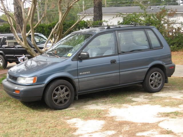

I believe these engines had an 8.5:1 compression ratio. All of the ones I owned burned their fair share of oil too, my buddy had a 95 awd eagle summit wagon with only 90k and it burned oil too. We had the head reworked with new seals and everything and it still burned oil afterwards. I believe the 2.4's suffer from stuck oil rings.
Here are a few pics of my old 93 AWD Summit:

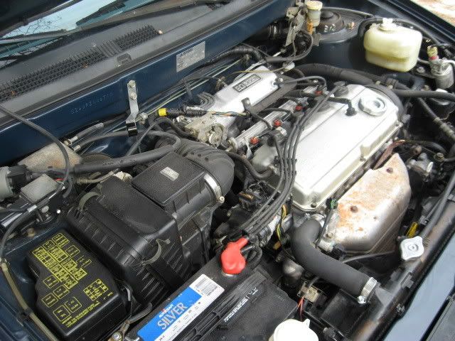

And here is a your old engine bay now (well, the engine stand is now gone ;)):
I am also doing a 4G63 swap, only I am building a more serious race/street car. I already have EVO8 syspention, EVO3 radiator. It will start out with a 14b turbo for break-in, but eventually, will have FP RED.
