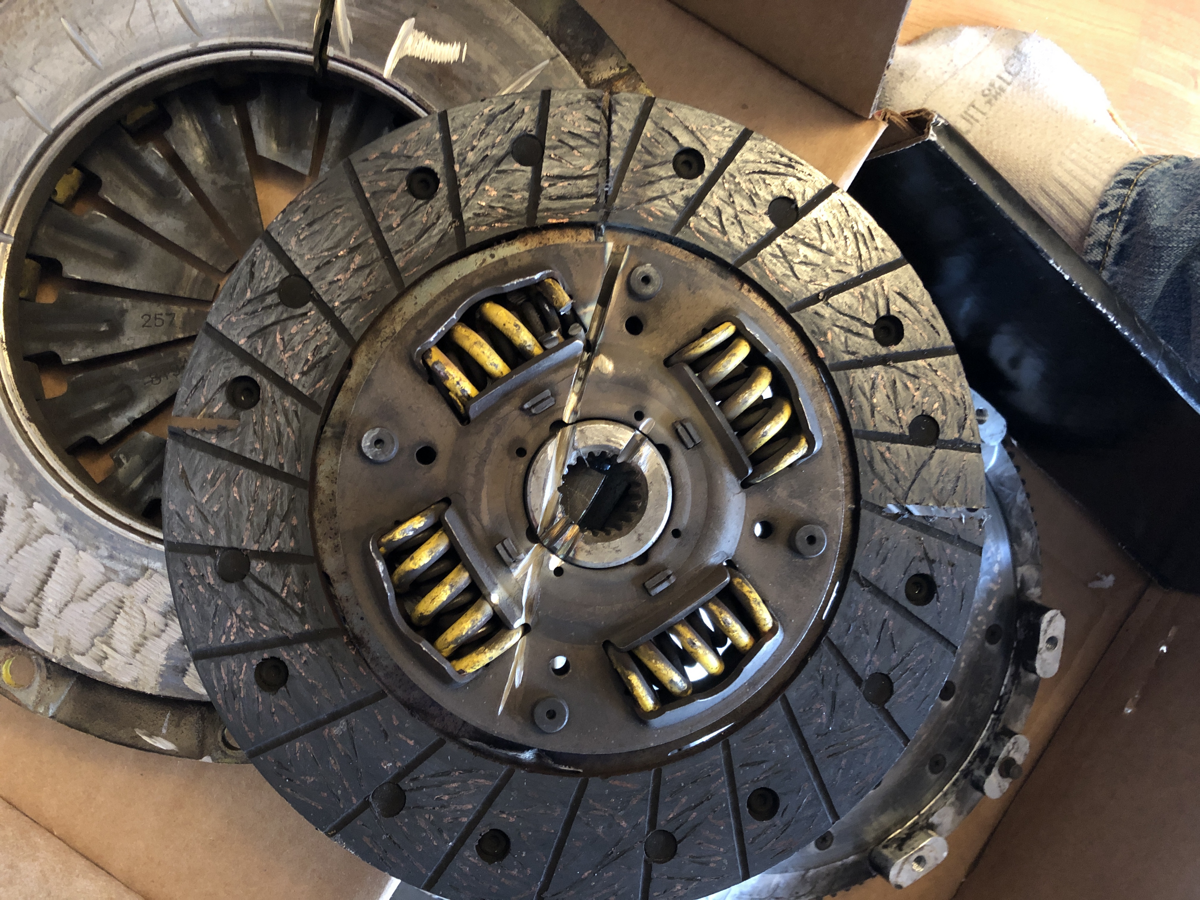

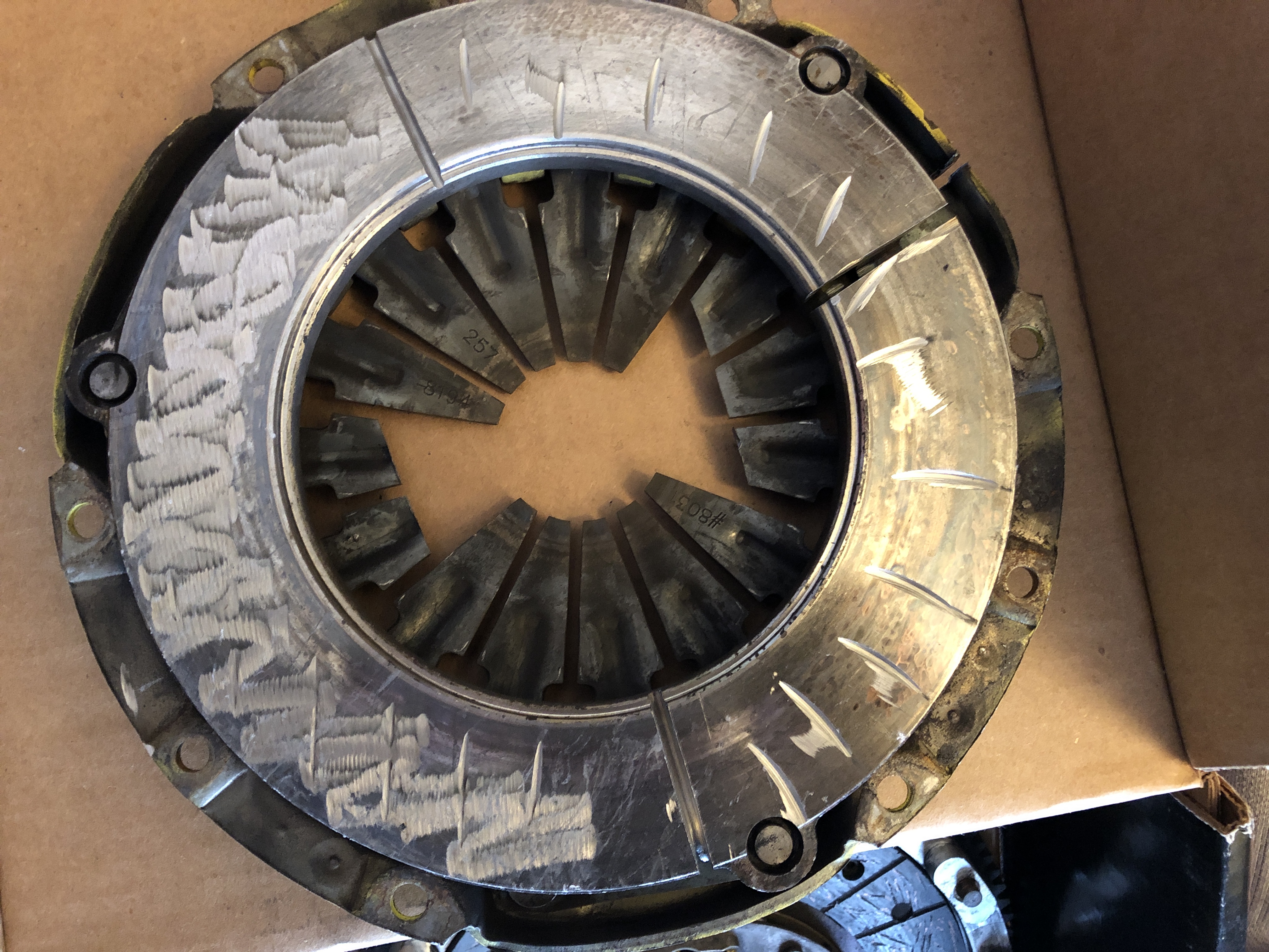

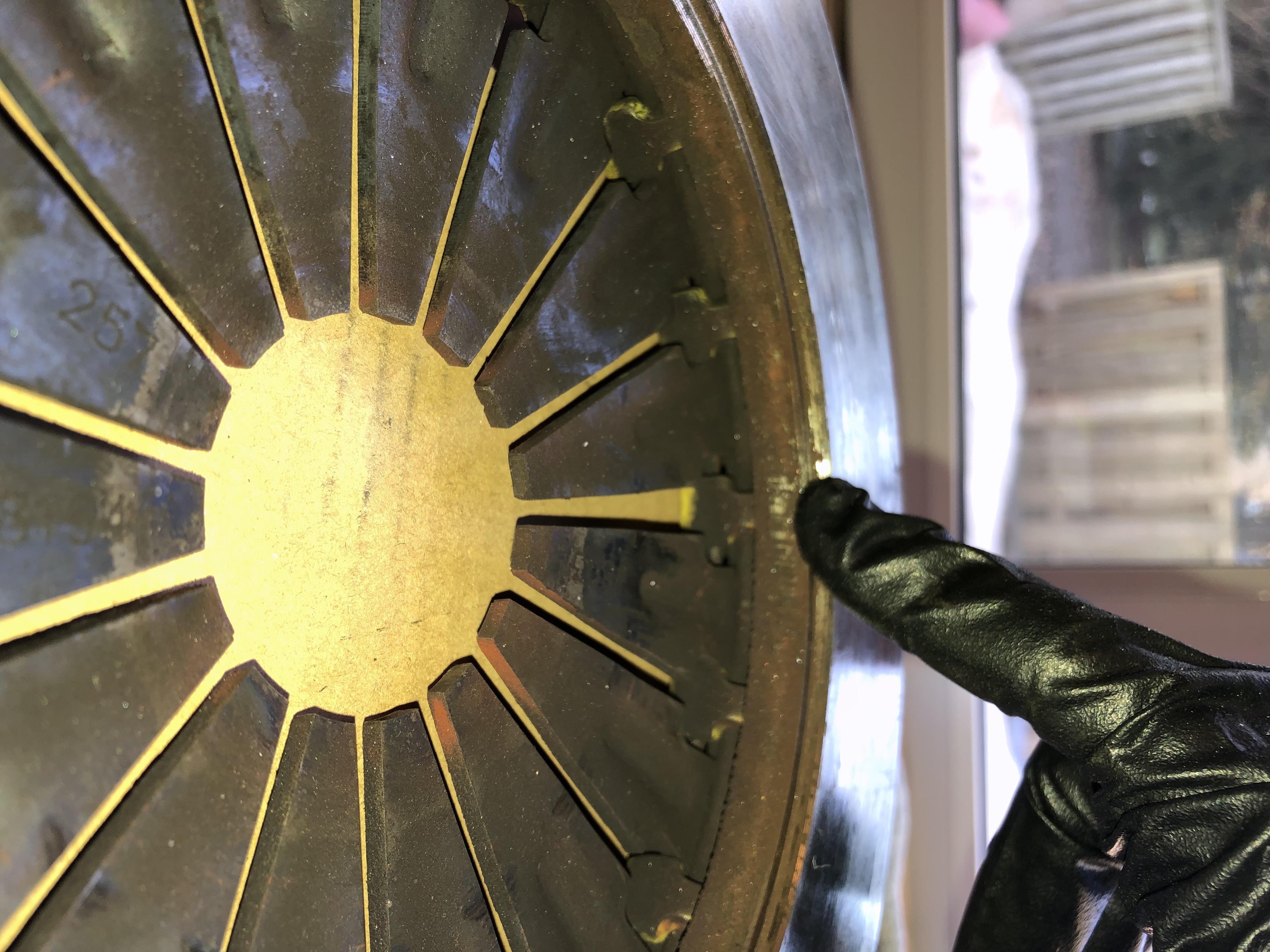

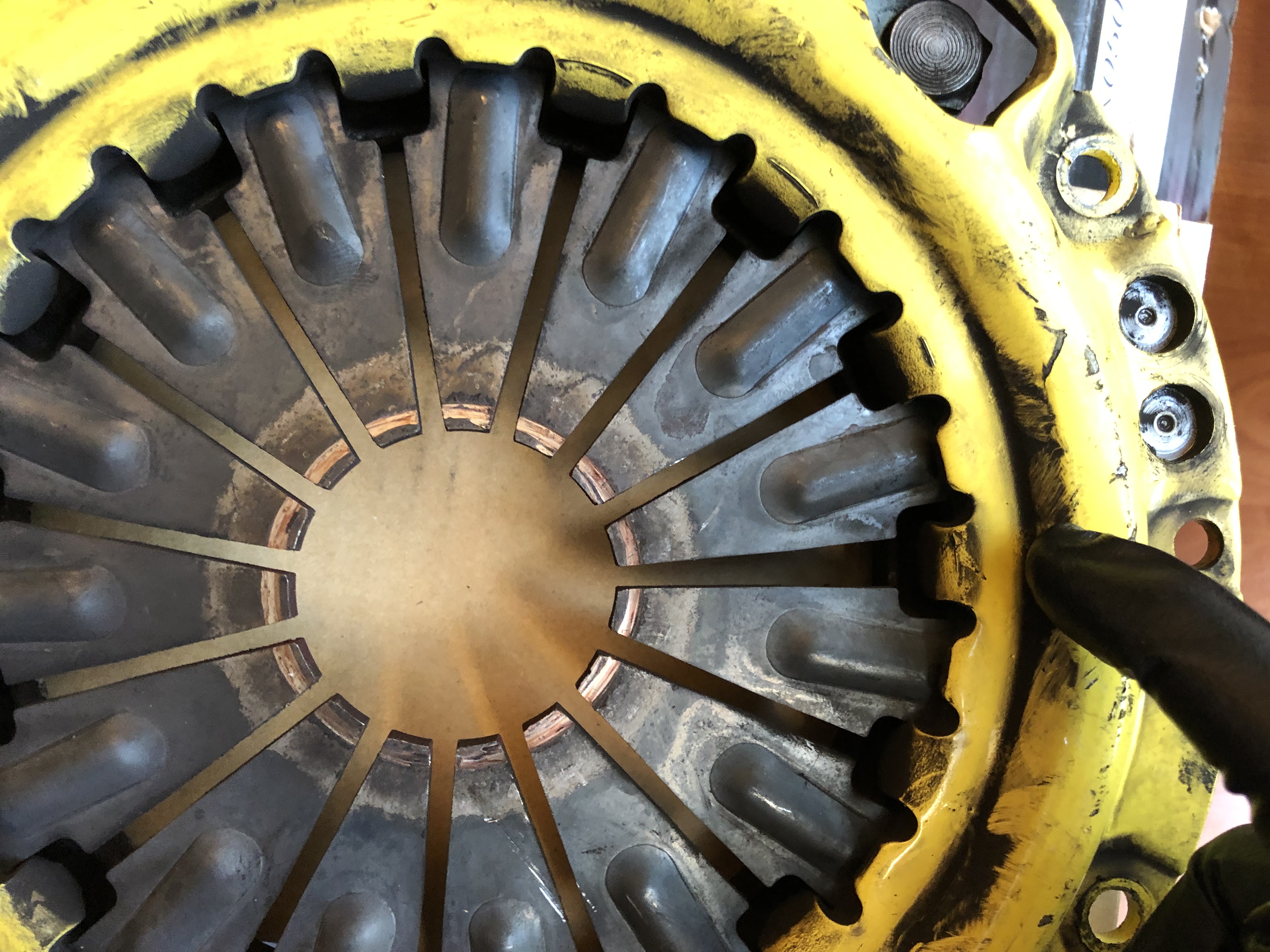

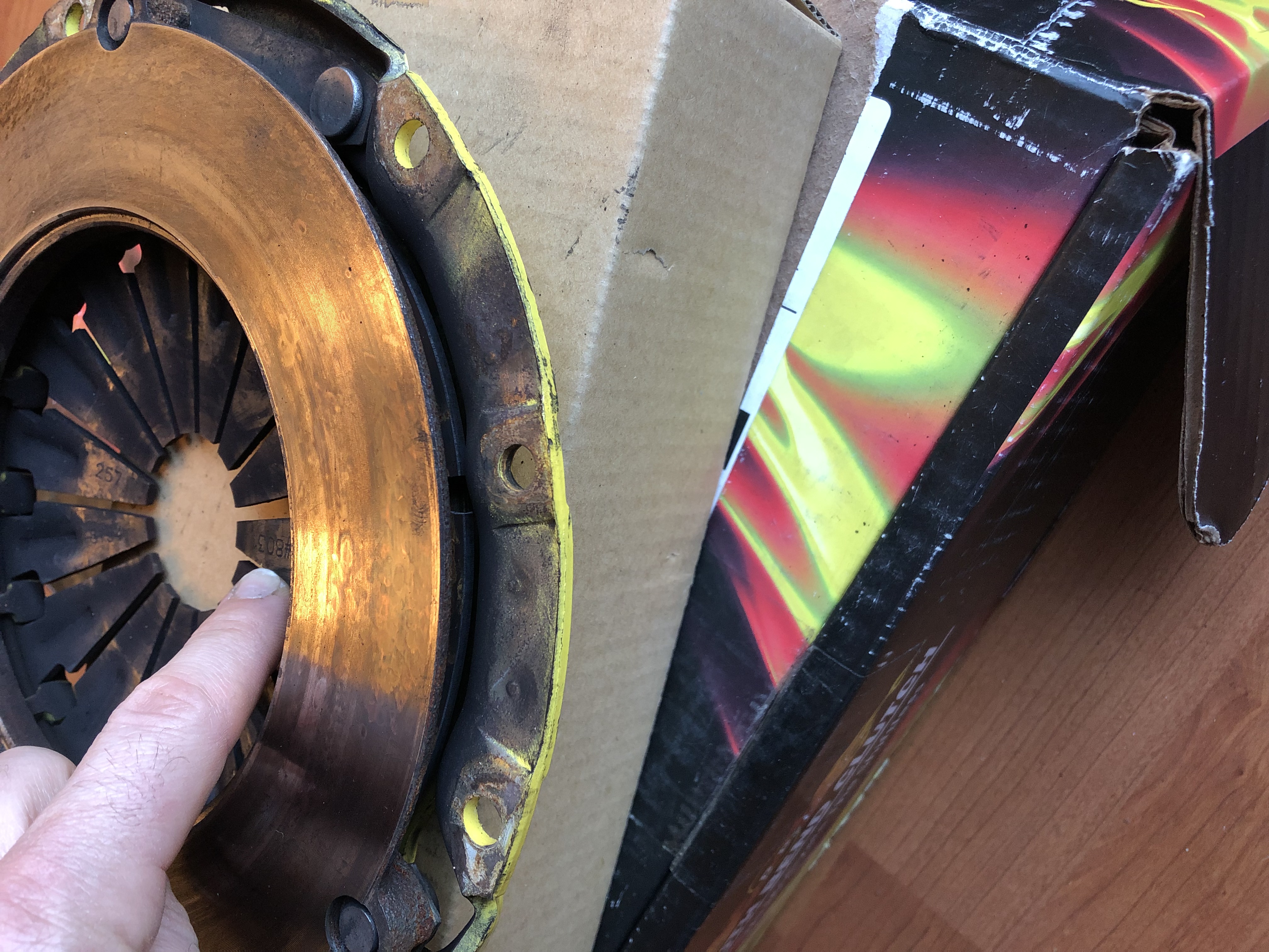

Got some good news with relation to the ACT clutch assembly.
Seems the diaphragm spring clean split - clean break. Pics to show this.
I was in contact with Eric at ACT and gave him pictures of the whole inspection process complete with serial numbers showing, and all the het copper transfer areas, nothing serious but it meant the disc would disengage and engage lopsided. Eric asked that I weld or destroy the parts in question so they could not be used for warranty/return or be sold to anyone else.
Pics to show that.
Eric was kind enough to put together a replacement kit - pro bono - IE free, with the caveat being that I would pay import fees.
Bear in mind that this clutch was purchased 04/30/2010 time frame, and ACT only covers their products "technically" for a period of one year from date of purchase.
My setup has like 5-6000km's on it to date, so given it has only ever been street driven and never been to the track or used in a racing scenario, it stands to reason that the base materials should not be affected this way - defect it should be.
This is a huge restoration of faith in the product and I am very thankful to ACT for even considering a replacement under a goodwill warranty scenario.
Again, my transmission (now 2, 1 even having newer syncros and design) was never able to shift with the rpms in an elevated range like 6K+ rpm. Was this defect present for some time? Remember my clutch pedal did go limp a few seasons back and I had to rebuilt the master (temp scenario). Felt strange after that but didn't seem to drive much different, however I was likely having to press the clutch pedal further down to offset the lopsided nature of things. My last high RPM shift resulted in gear grind, so it was there when the car was last driven.
Situation sorted for now, and product is supposed to be sent ground freight on Monday.
Pics as promised!
