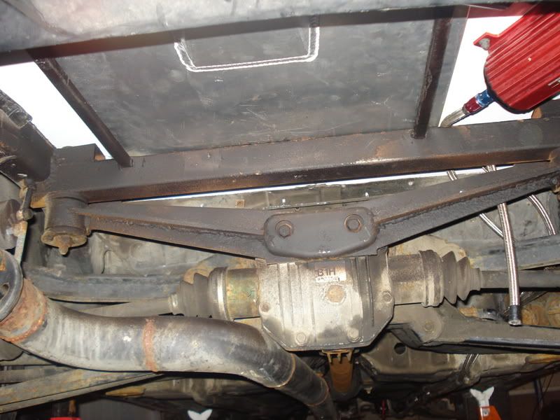

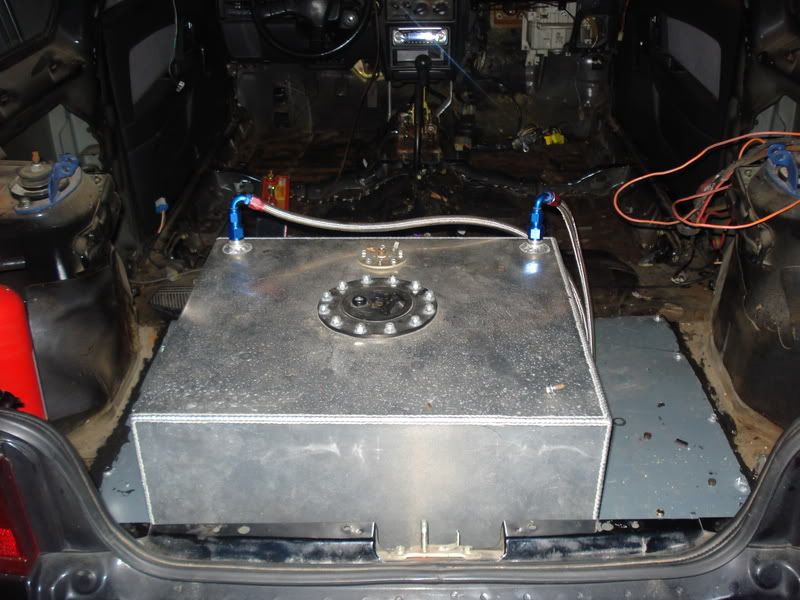

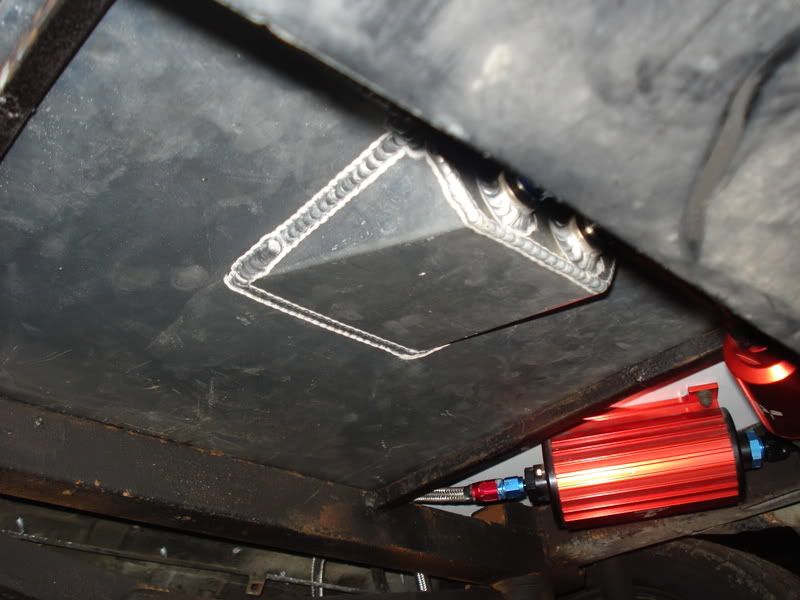

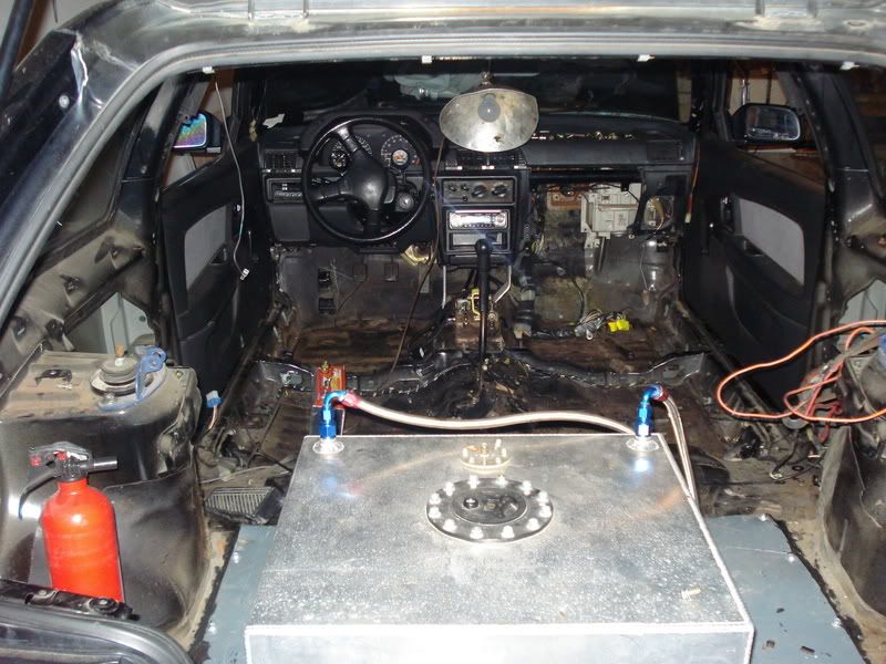

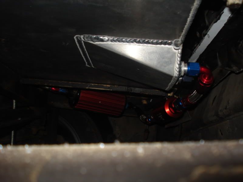

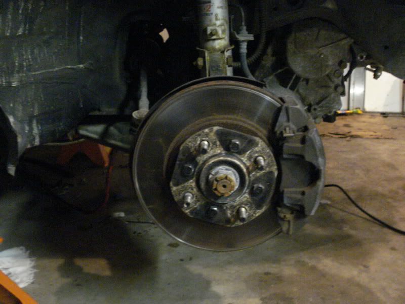

Some of you may know i decided to go with a fuel cell, and some other goodies. Such as bigger brakes, and JMF intake mani. I also did a Simi wire tuck. The harness is in the car in these pictures ;)
heres some pictures of my progress as of now.

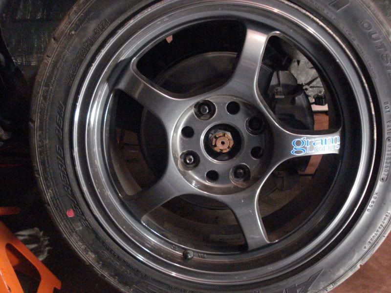

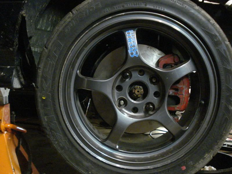

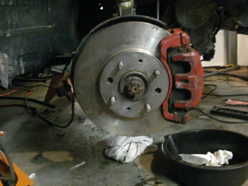

My brakes..
before
After

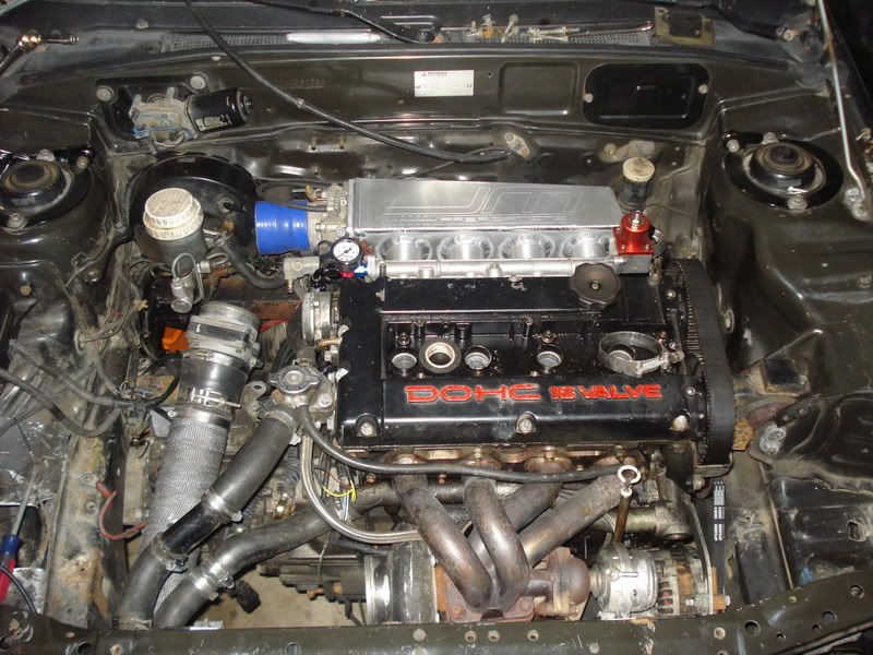

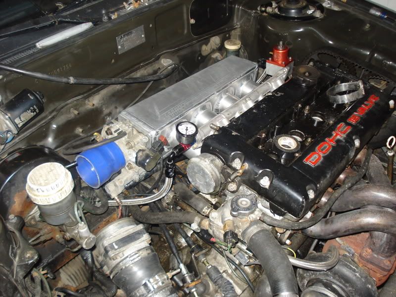

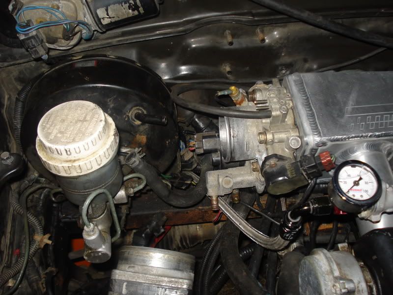

the requested engine bay.. :( its ugly, and dirty. And a simi wire tuck
Let me hear the feed back. I enjoy it ;)

Looking good so far man!

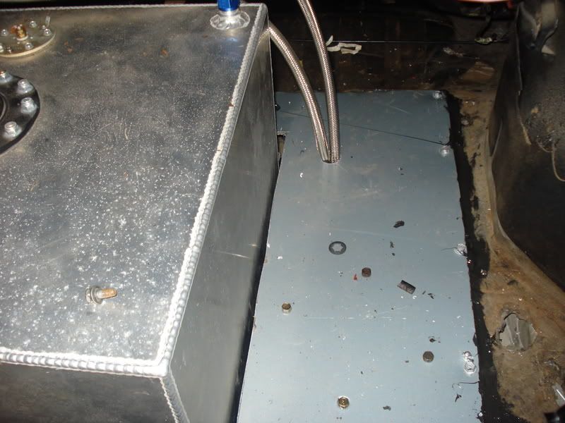

I do hope you're planning to use some sort of a grommet for those braided lines and not let them rub together or chafe against the metal plate.

You are correct. I'll probably make another, smaller hole for the breather. I havent gotten around to that part again. busy doing other things.

Looks great, I wish i had the time and welding skill to make mine awd. Stupid question here, did you use a galant rear for your 4 lug rear or use the factory turbo csm stuff on a dsm rear? Also, where'd ya get there big breaks?

Looks good John, I am looking foward to seeing the intercooler plumbing to clear the brake booster/mc.

Get a bend welded directly to the TB.
Feedback: Change the brake fluid ASAP! :lol:
haha. your not the only one. :x I dont know what i'm going to do about that yet. Its been sitting like that for a week. and i just keep looking at it and smacking my self in the forhead! I've thought about getting the elbow welded directly to it.
Dave managed to make his IC pipe fit with the JMFab street plenum.

See. i thought about doing that. But i have 3'' IC pipes from start to finish It'd be RETARDED to go from 3'' to 2.5'' right before the TB. And i know the TB isnt 3'' :x
I might go get a tight 120degree bend ubent today. and try that. IDK. I dont wanna use a silicone 90. I HATE them
Yeah, that 3" piping is gonna screw you over. Good luck.

Why would it be retarded to go from 3" to 2.5" right before the throttlebody? Its basically a velocity stack. I know numerous DSMs that do that with great success, +650whp success in more than one occassion.

Are you going to be able to run your car at the track without having a firewall sealing in that fuel cell?
'89 Colt GT - All the rare goodies
'98 TSi AWD - Clean street car
 Post subject:
PostPosted: Thu Apr 10, 2008 9:49 pm
Some call me a god
Joined: Tue Mar 08, 2005 6:39 pm
Posts: 1599
Location: Cincinnati, ohio
Its not completely done yet. I plan to make a fire wall. Thats once i get the interior and what not back in.

Quote:
Try a 2g dsm throttle body elbow.
