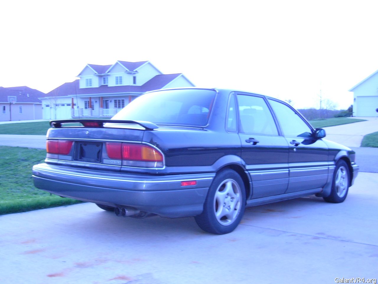

Oh, here's a pic of my '92 Galant GSR.
http://www.galantvr4.org/img.php?id=47954
