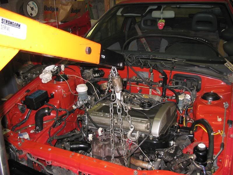

r bought a 1992 dodge colt 200e I fell in love with this little things and when I've learned there was a turbo version, I badly wanted one. Finally i found one in 2002 wich was in pretty good shape, it comes from california (no rust :wink: )

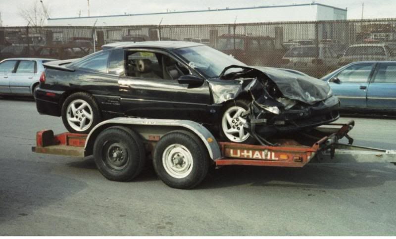

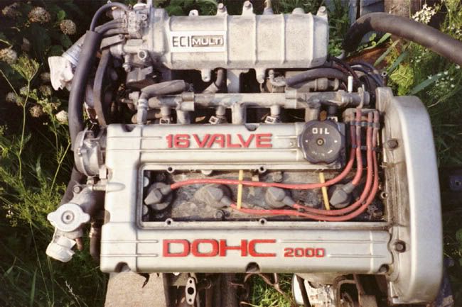

    1992 Eagle Talon TSI FWD donor car(4g63t)[i:2zq9jil4](engine removed and sold the car)[/i:2zq9jil4]

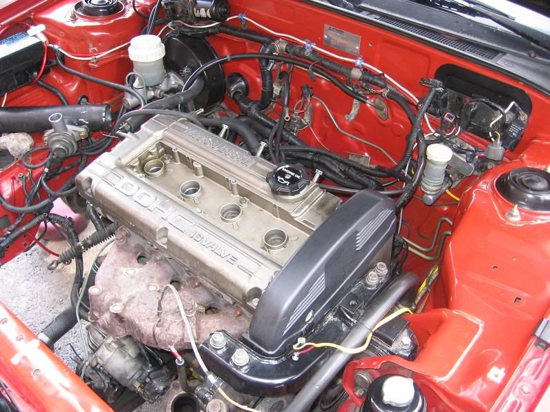

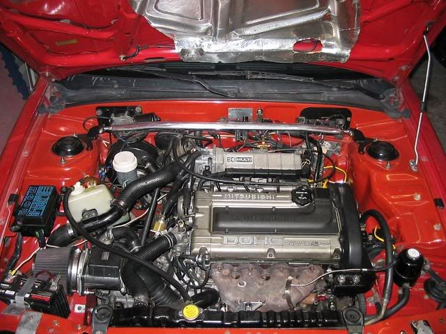

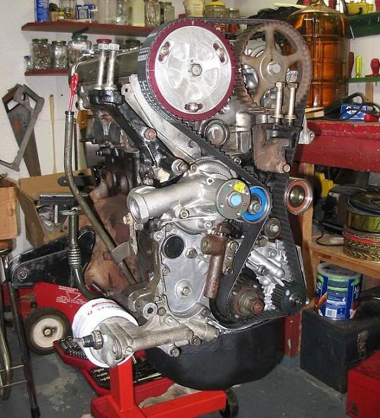

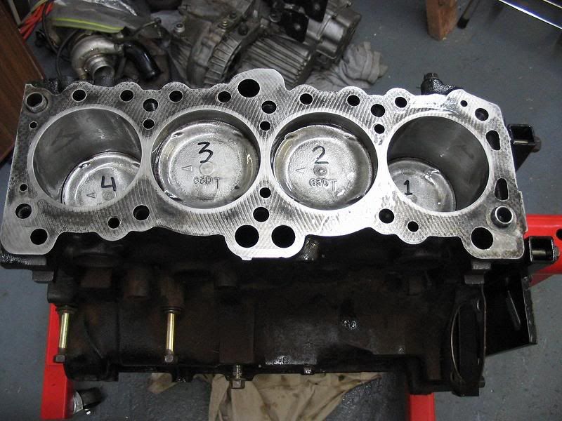

[b:2zq9jil4]Engine[/b:2zq9jil4]
- 4g63t
- AEM Exhaust adjustable Cam gear
- Balancer shaft removed

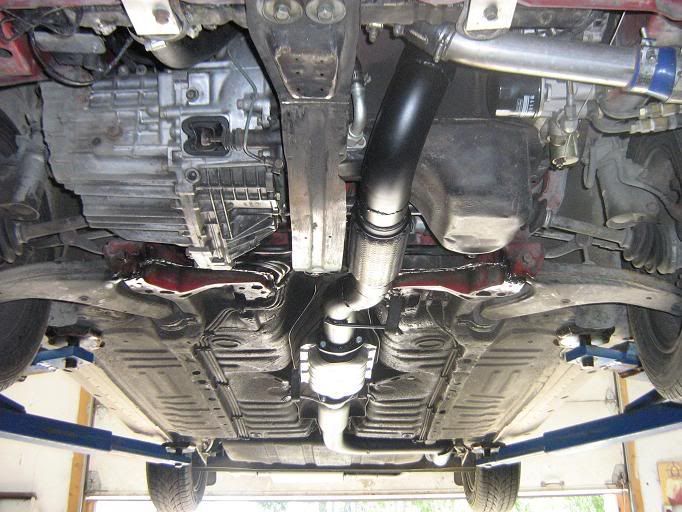

[b:2zq9jil4]Intake and exhaust[/b:2zq9jil4]

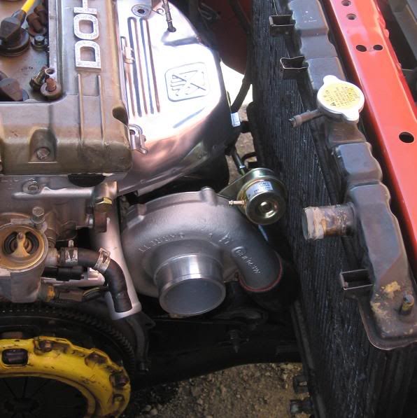

- PTE Trim 50 Turbo ball bearing Internally gated
- Hallman Manual Boost controler
- 2G Mass air flow sensor
- O2 Dump

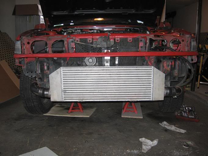

- Front mount intercooler Spearco
- 2.5 inch intake piping
- dejon tool BOV control

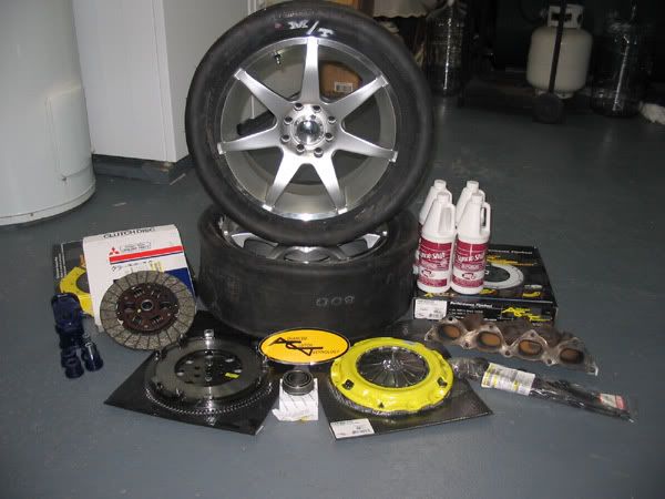

[b:2zq9jil4]Drivetrain[/b:2zq9jil4]
- OEM km210 tranny
- Shepracing Chromoly shift fork
- Quaife lsd differential
- Act Flywheel
- Act 2100 pressure plate
- 2G AWD clutch disc

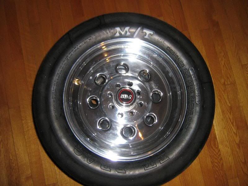

- Mickey Thomson Slicks 24.5*8*15
- Weld wheel (Dreglites)

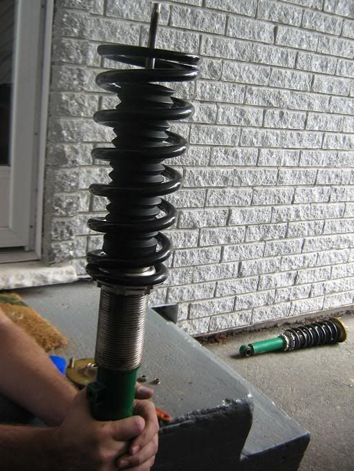

[b:2zq9jil4]Suspension[/b:2zq9jil4]
Front:
- Ground Control Coilovers
- Kyb GR2 gaz struts
Rear
- Tein Flex strut & coilovers
- Super Pro PolyUrethane Bushings

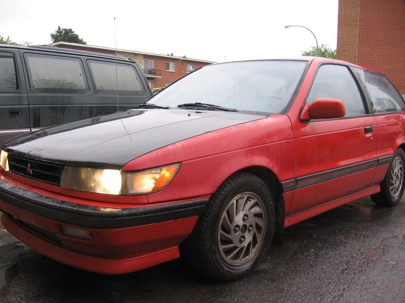

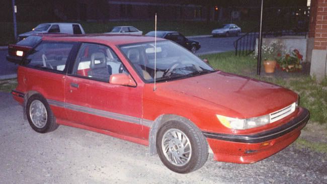

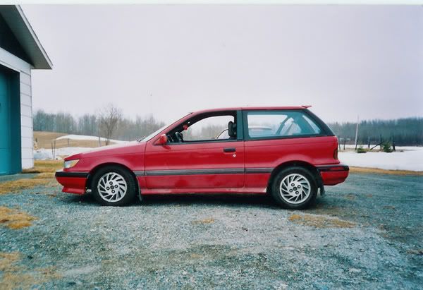

When I bought it
[img:2zq9jil4]http://i58.photobucket.com/albums/g270/ ... irage1.jpg[/img:2zq9jil4]
[img:2zq9jil4]http://i58.photobucket.com/albums/g270/ ... ebay1a.jpg[/img:2zq9jil4]

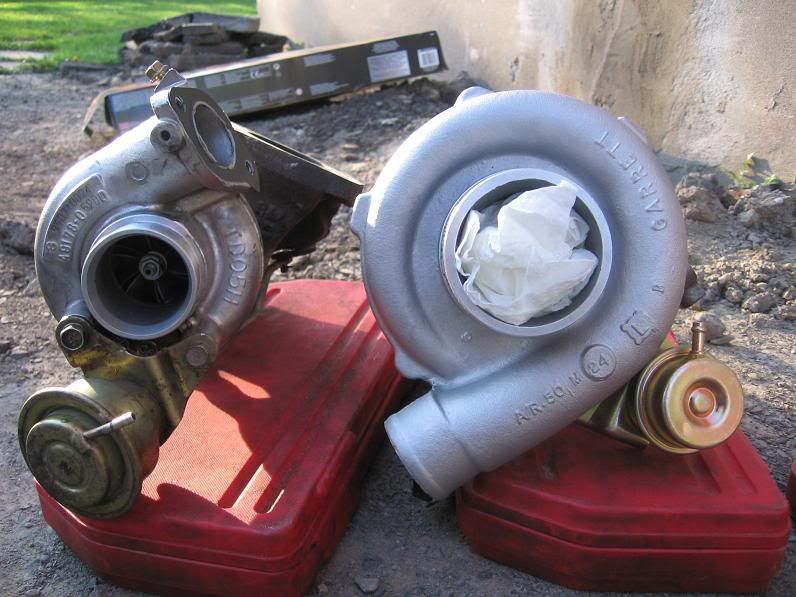

trim 50 vs 16g
[img:2zq9jil4]http://i58.photobucket.com/albums/g270/ ... 0VS16G.jpg[/img:2zq9jil4]

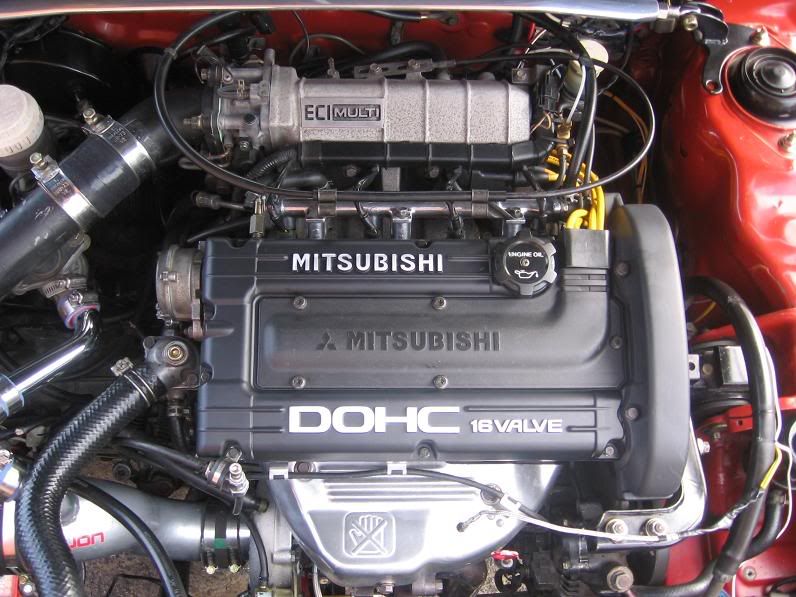

those fan style wheels are hot, where did you get them from. BTW I think you should change your avitar to your present car! like the pic of your engine which i think looks great 8)

The fan wheels are from a 1988 turbo colt. When i bought the car they were on, DRcolt swapped them.

nice clean ride! how are the slick size fitment> any rubbage?
PostPosted: Wed Jan 09, 2008 9:42 am
Joined: Sun Jan 20, 2002 7:00 pm
Posts: 767
Location: Montreal, Quebec, Canada
You need 5.5 inches of backspacing to get decent amount of steering radius.
In order to clear the strut and the fender you need coil overs.
I used GC with 6 inches spring in the front, but they are too short, i will go with 7 inches.
Apart from having a limited turning radius they are awesome!
