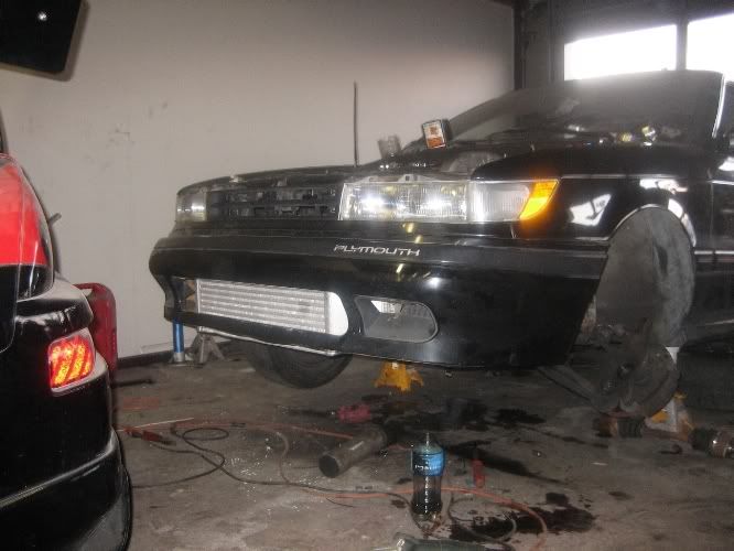

Front motor mount
Rear mount.
the goodness.
And the new Setup.
I'll get more pictrues as i go.. It should be done in the next couple weeks! Let me know what you think.

Looking good! Are you going to run that top mount setup in the colt? Looks like you are using the trunk pan out of a 1g awd.
PostPosted: Sat Jan 27, 2007 3:40 pm

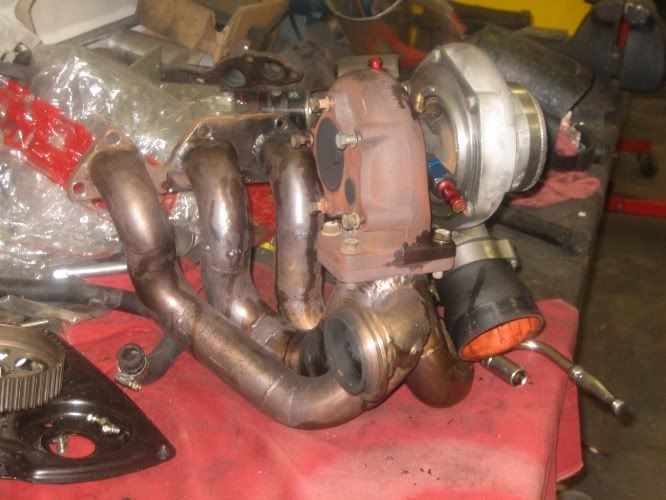

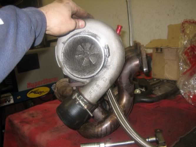

Looks nice man. I can't believe they're using a 5-bolt exhaust housing with that 35R, I didn't think that was even possible. Anyway, good progress man, take some launch vids when you get it running. :wink:
PostPosted: Sat Jan 27, 2007 3:53 pm
Yeah. its gay. I looked into getting the 3in out with v-band. But its $300 with my discount. thats unreal.
And as far as the manifold.. the set up came off our honda shop car. It made 570WHP at 24psi. he parted it out. So i traded my 30r for his 35r

looks real low you might need the Colt sky jacker kit for that thing. J/K :lol: but would it not be easer to side it out in front of the back wheel.
That?s the turbine housing we sell with all of our turbo kits. Contrary to popular belief-we have made more power with this than with e 4 bolt turbines. We have several evo customers over 700whp in a .63 5 bolt (T-67) using our turbo kit.
Red-I can get you a turbine for FAR less than 300$-hit me up.
That's actually pretty suprising, whatever works I guess.
