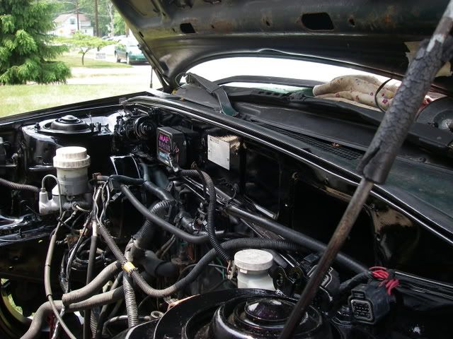

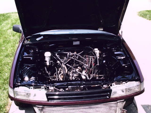

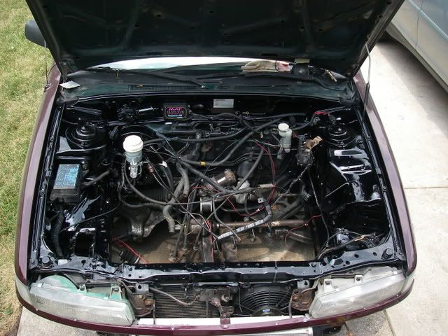

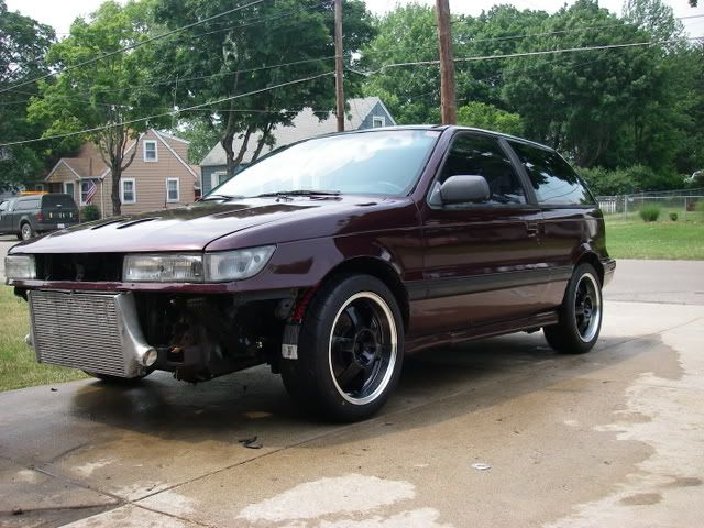

With the engine out of the car I have had some time to clean up the colt. The engine will be reassembeld later this week and installed next week along with the HX40 :twisted: . I cleaned up some of the wiring and painted the engine bay.
before pic
after

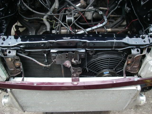

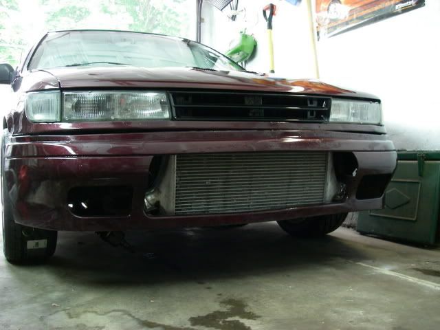

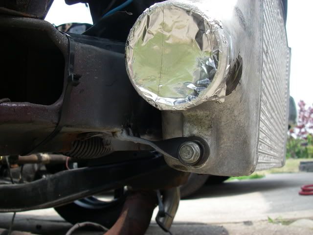

Also made some brackets and mounted my new IC

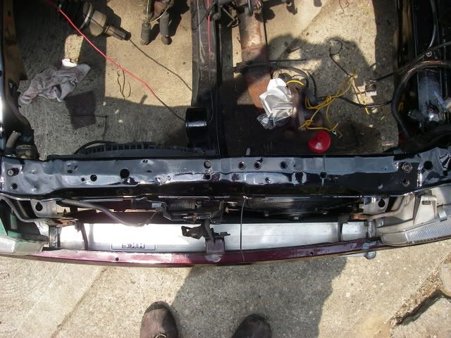

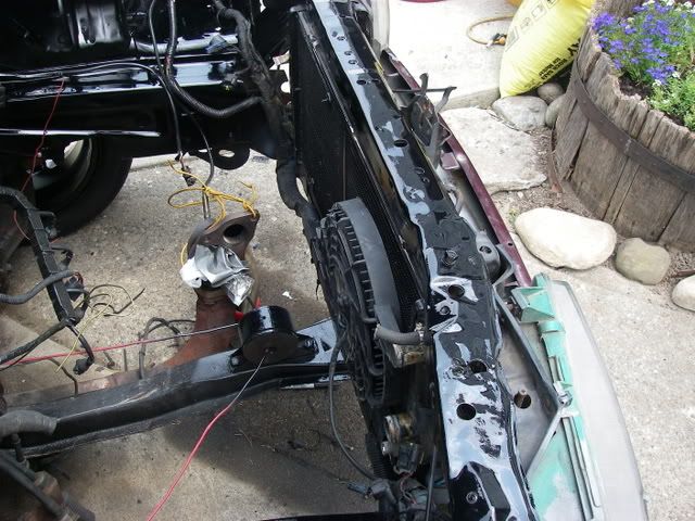

I went to the junk yard and got a audi radiator. Only needed two tools to install it. Sawzaw and a welder. I cut off the lip on the lower core support and then welded the seam. Also cut out the peice that connects the bottom to the top underneath the hood latch. I welded a peice of stainless rod in its place. Also installed two fans. a pusher and a puller. The audi radiator is great. Frees up alot of room

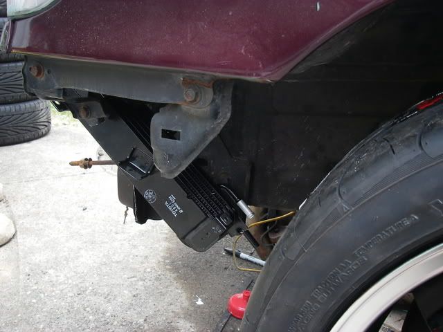

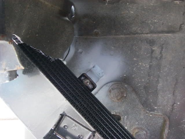

I found a oil cooler from some sort of toyota at work. It was perfect to put in the finder well. I made a bracket to bolt and unbolt it

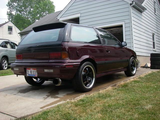

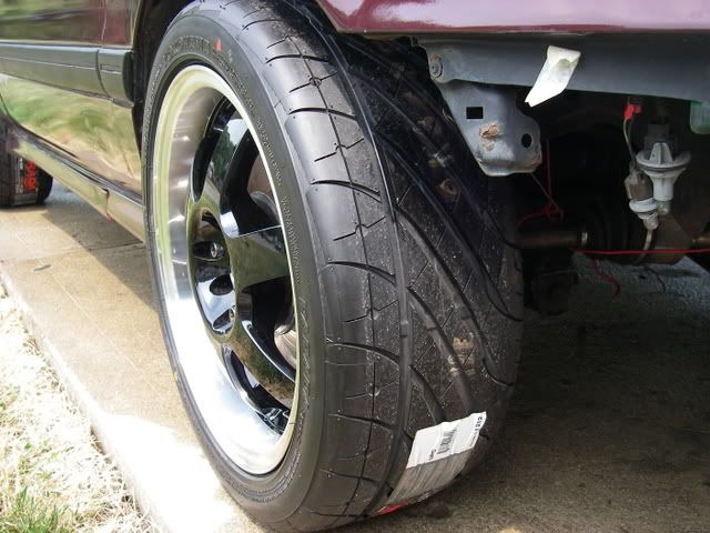

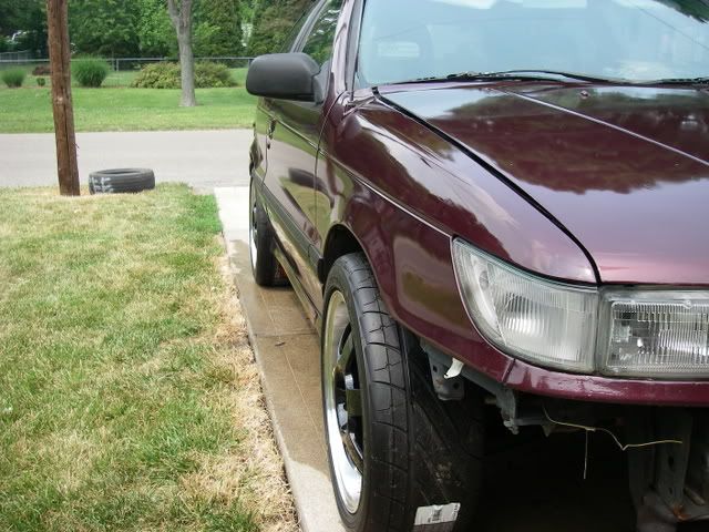

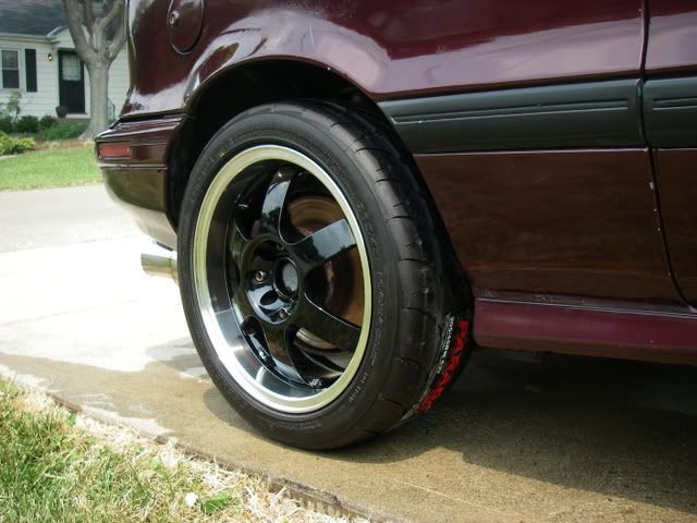

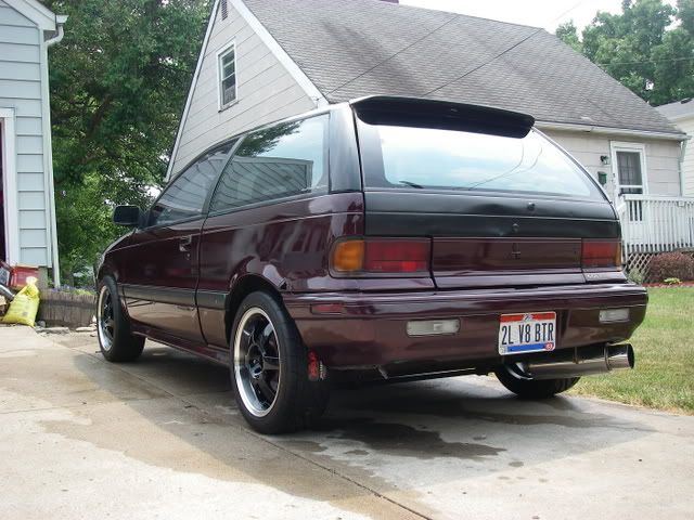

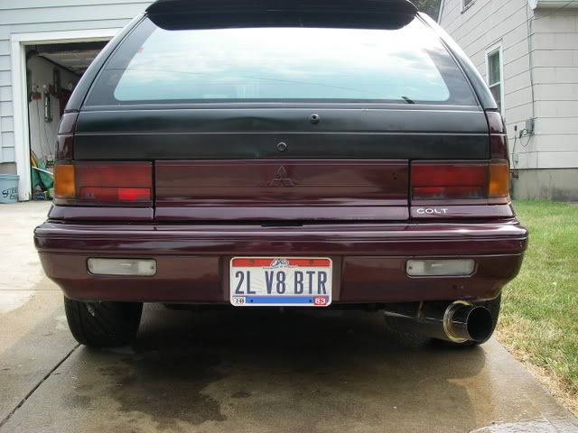

Started making a new exhaust but haven't finished it yet. You can see the muffler in the rest of the pics. Also you will see my new rims. AfterI put the engine in I adjust the coilover so it sits a little better. I plan on focusing on the interior next but I really just want to get it running for the shootout :D ENJOY!!

I like the exhaust :)

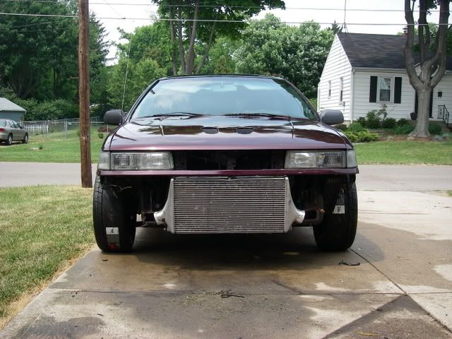

Looks awesome, but how are you gonna fit a front bumper cover over that FMIC? :lol:

My exhaust is like that, well almost the same angle, very nice colt. :wink:
No problem :wink: I just set it on to take some pics but you get the point
