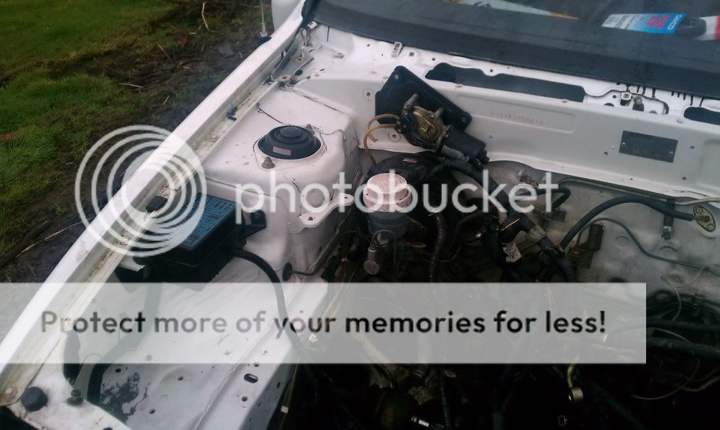

From this:
To this:

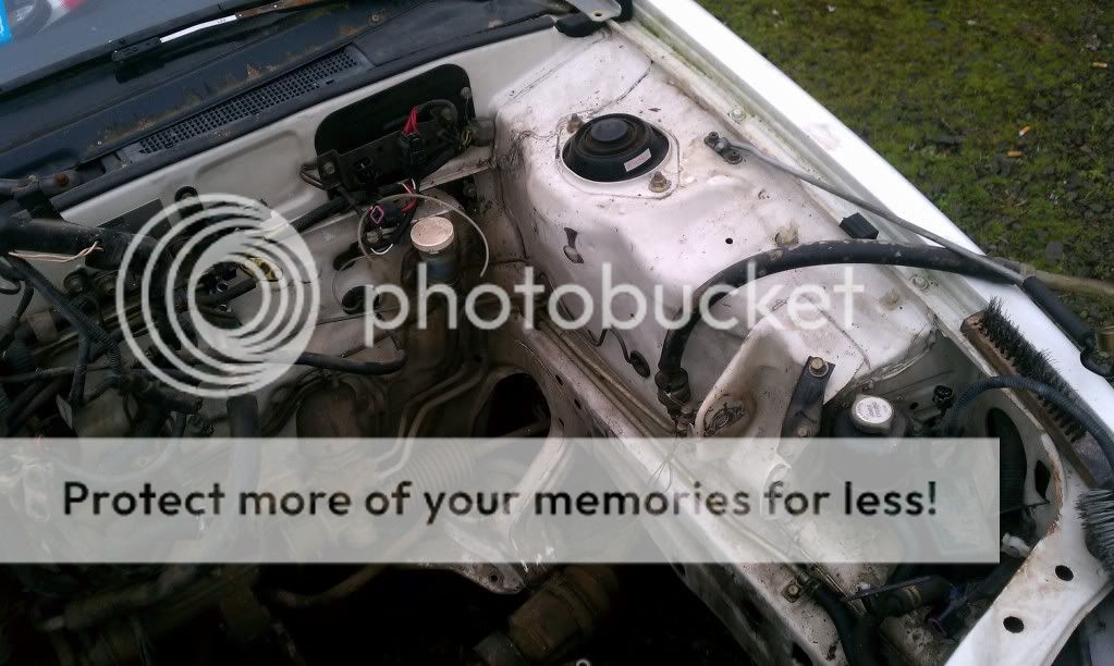

and This:
To this:
I am also eliminating some unnecessary stuff on the firewall and relocating some other stuff. In some circles this is referred to as a "mild tuck". I am keeping Power steering, relocating the alternator for both durability and appearance, trimming the timing-side motor mount and using the 1.6 (also N/T) OFH. I will keep an eye out for a 90 turbo OFH for a future project, I just didn't want to run the 91 style

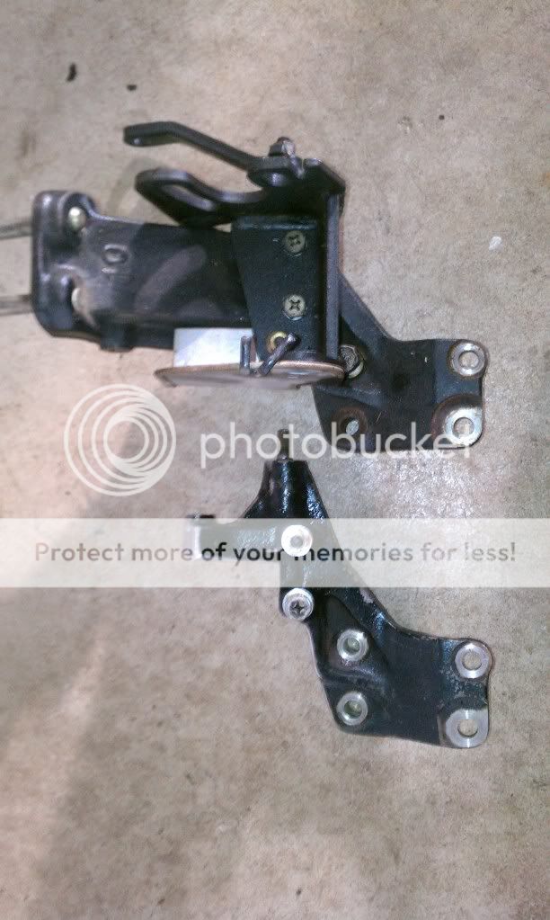

The power steering pump mount has been modified a wee bit to be less chunky.
(the topmost nipple in that pic was also trimmed off once I realized that I din't need it either)

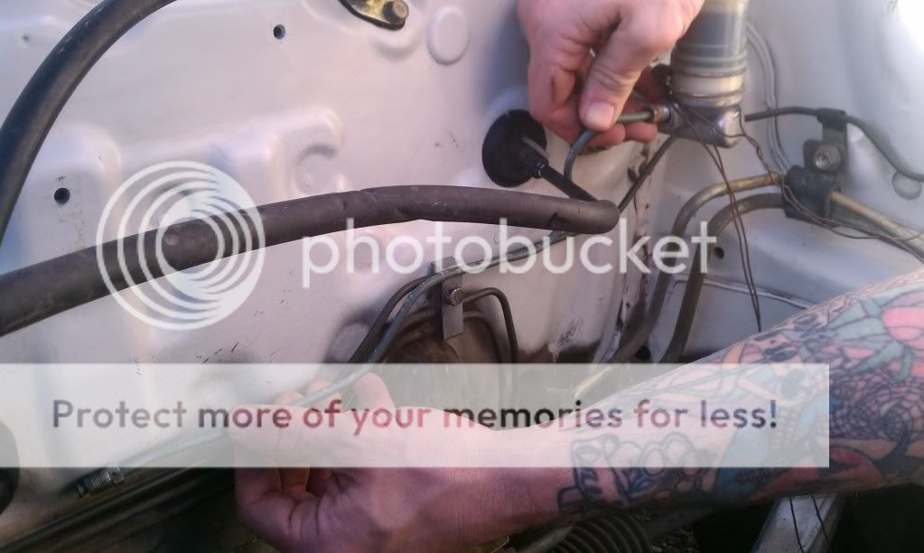

I also rebent the fuel feed/return lines as well as the hydraulic clutch line to lower points on the firewall. The clutch line will come off the firewall with the shifter cables.

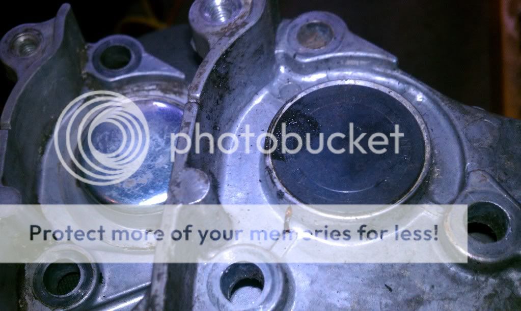

The engine was assembled initially with one of those eBay BSE kits by a friend for his automotive class. He may have gotten a good grade on it but I was less than satisfied with the results. He not only put the longer oil pan bolt in the ONE spot that is supposed to have a short one, he also managed to strip that hole so I couldn't just swap them out. OK, since I have the 1.6 right next to it I decided to swap the front cases. $10 for a Front main gasket set and a few hours later, I had the 2.0 apart. while I was in there I thought it wise to swap the OEM stub shaft in as well as the new gasket. Good thing I did because HE LEFT THE BOLT LOOSE ON THE GEAR. I can imagine the chaos that could result from a siezed oil pump so I resolved to double-check everything he touched from there on out. So far so good. I have the motor retimed and on its way to completion.
For reference, Ebay stub saft on the left, OEM on the right:

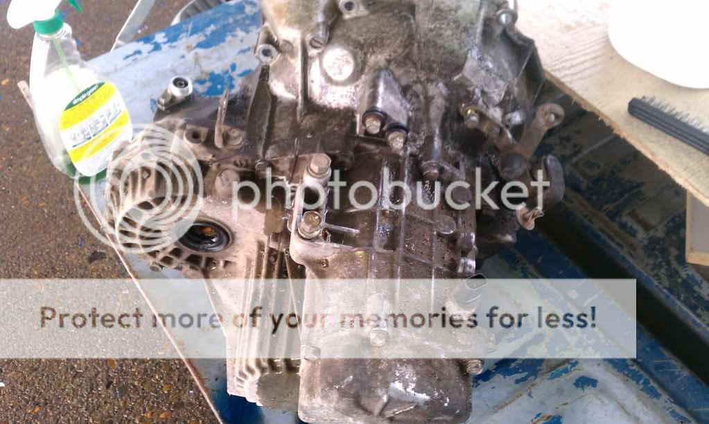

While it was out I also purple-powered, wire-brushed, and pressure washed the tranny.
Before:
After:
