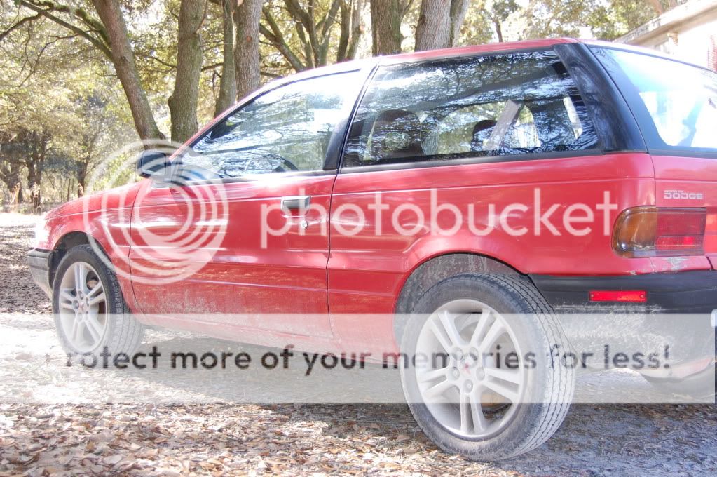

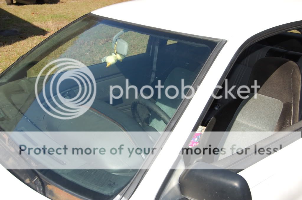

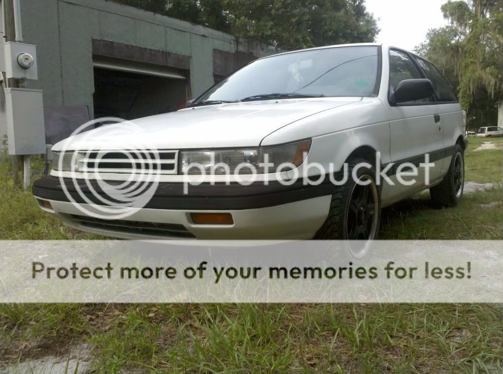

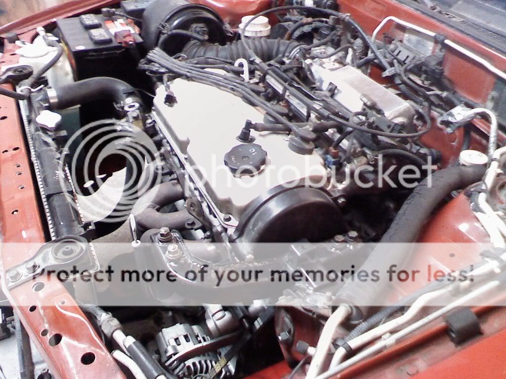

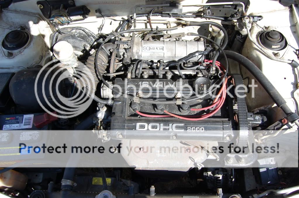

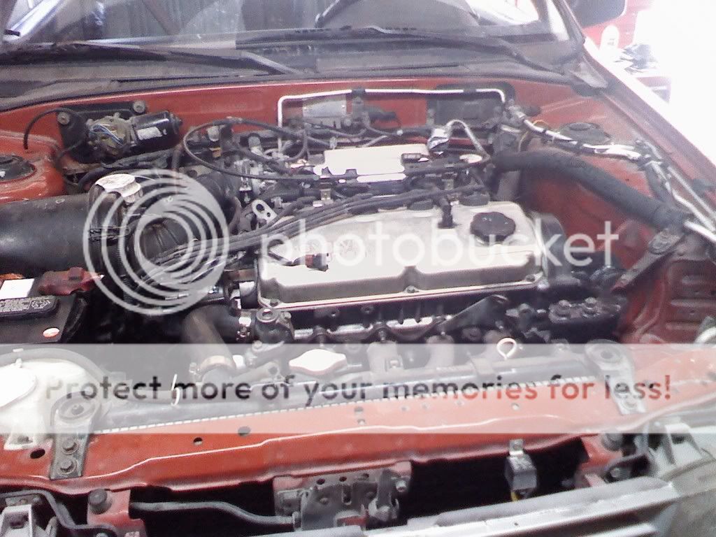

Currently the white car has a new 2.0 engine (still no turbo), Eclipse dash, Eclipse seats, Expo brakes.
The red car currently has a 5lug swap. 2.4L Expo engine on the 100% stock CSM harness/1.8L ECU/1.8L MAF/1.8L Throttle body/2.0L Injectors.
The swap was done this way to save time. This is a daily driver. The engine was dropped in and started right up in a few hours.

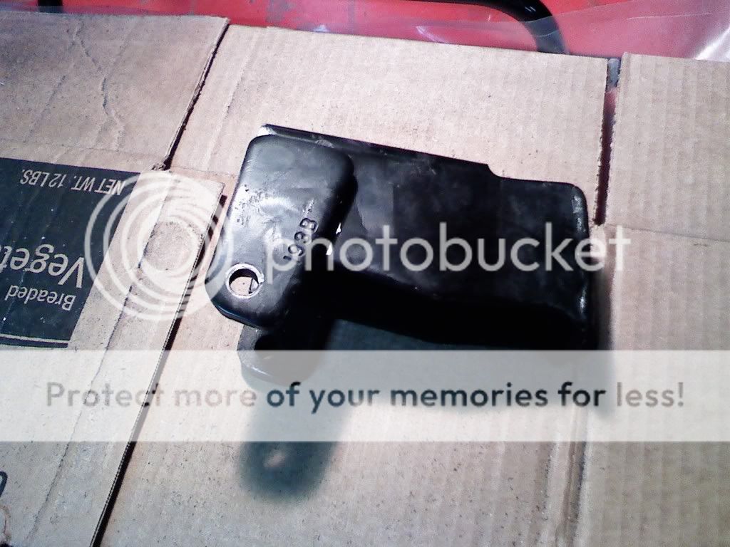

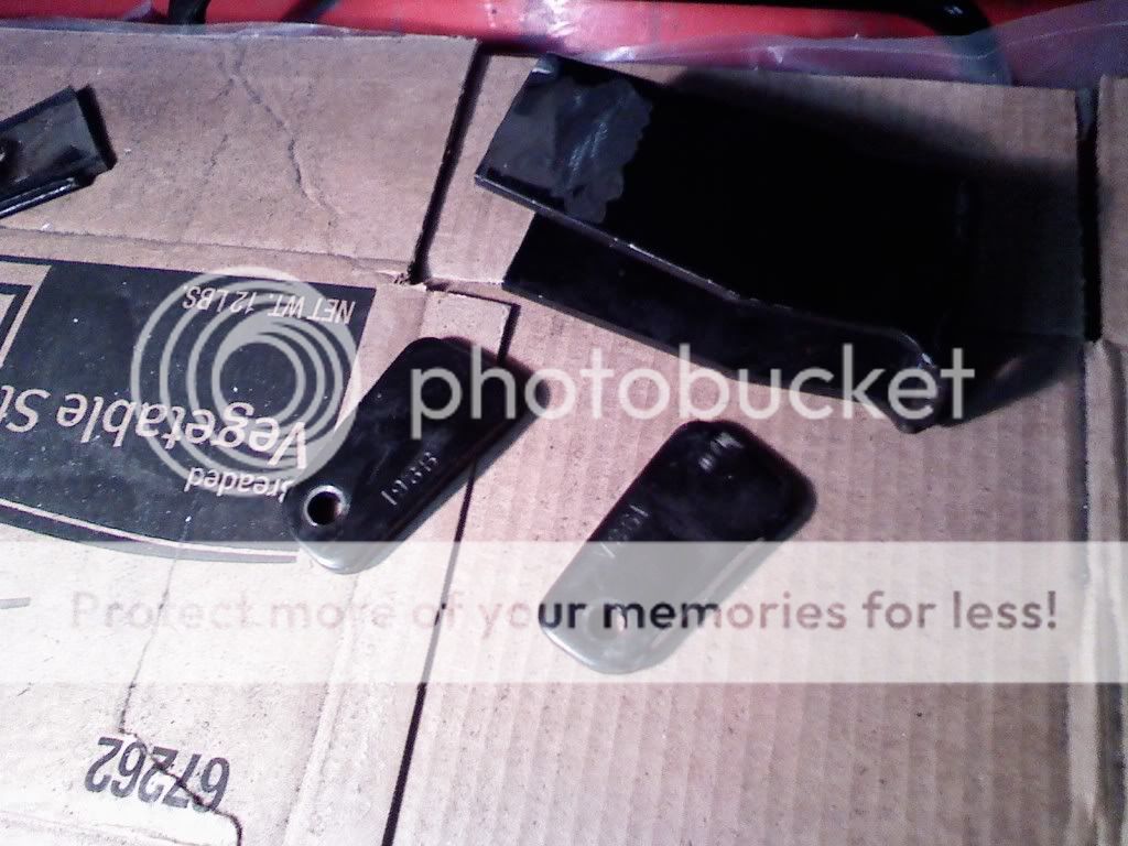

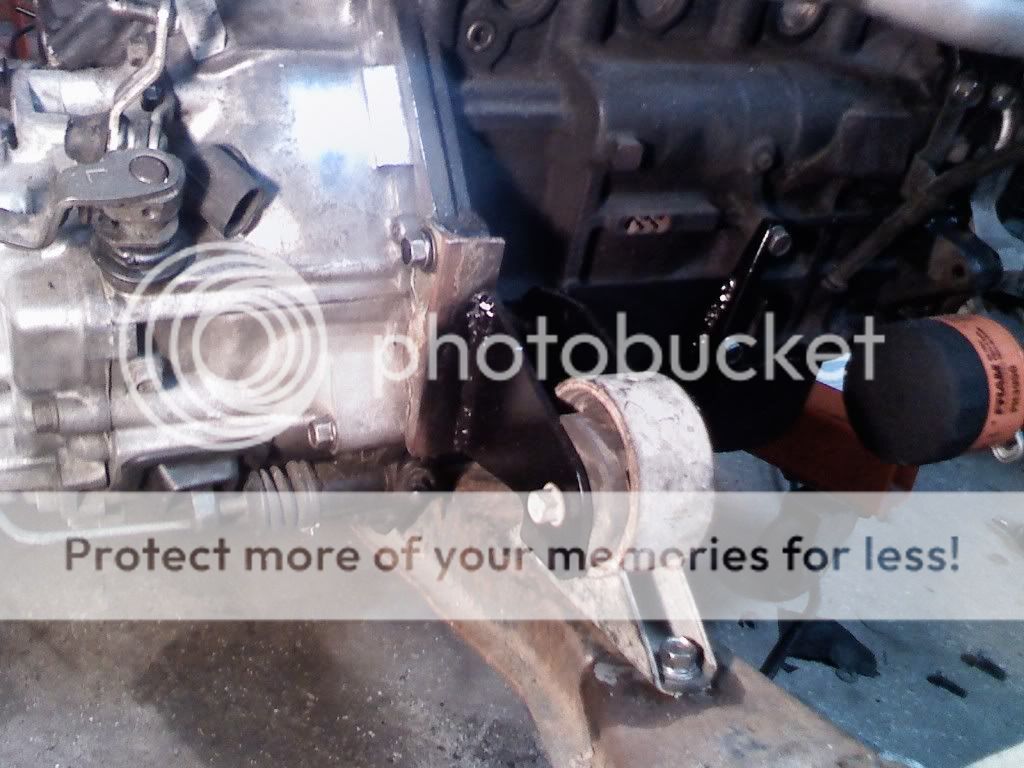

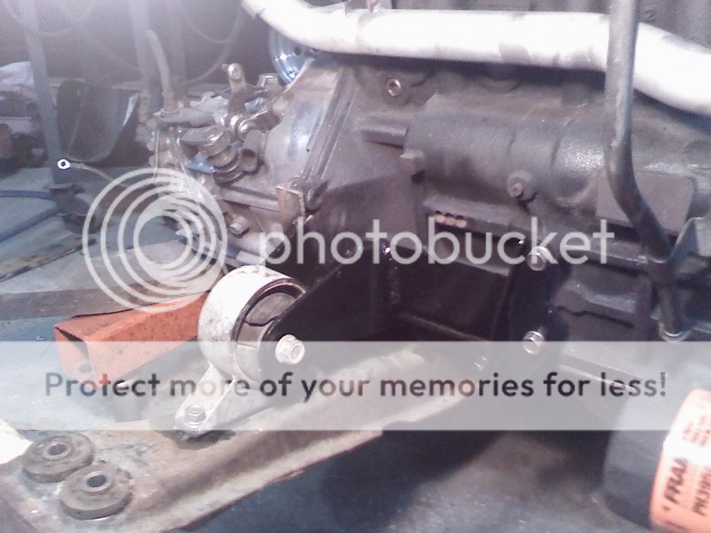

Front Transmission Mount:
People always ask about this so here are the pictures again. This mount is made using the exhaust hanger and stock mount so that things will fit a 2g style front mount. This is because the holes on the block/transmission are in different places.
Rear Transmission Mount:
Instead of doing all the funky mounting I just modified the stock mount by rotating the mounting holes to fit the stock CSM mount.

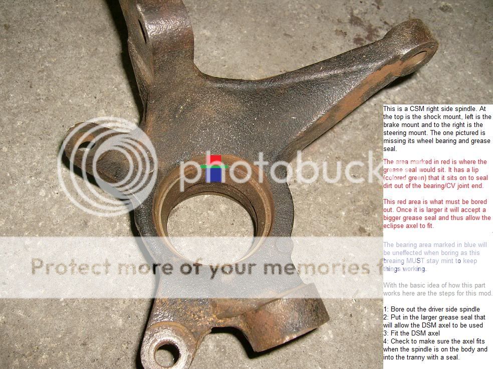

CSM Hub Mod:
This is done so you can use the stock spindle/hub with the Eclipse axles. The axle will fit just fine already, the issue is the with seal being smaller. The fix is to have the hub machined bigger to accept the seal from the Eclipse/Expo. I ran the car this way for 6 months and never had an issue. I later swapped to the Expo setup for the larger brakes. Overall the Expo is the way to go. But if you have no other options and cannot source Colt GT/Halfshafts give this a try.

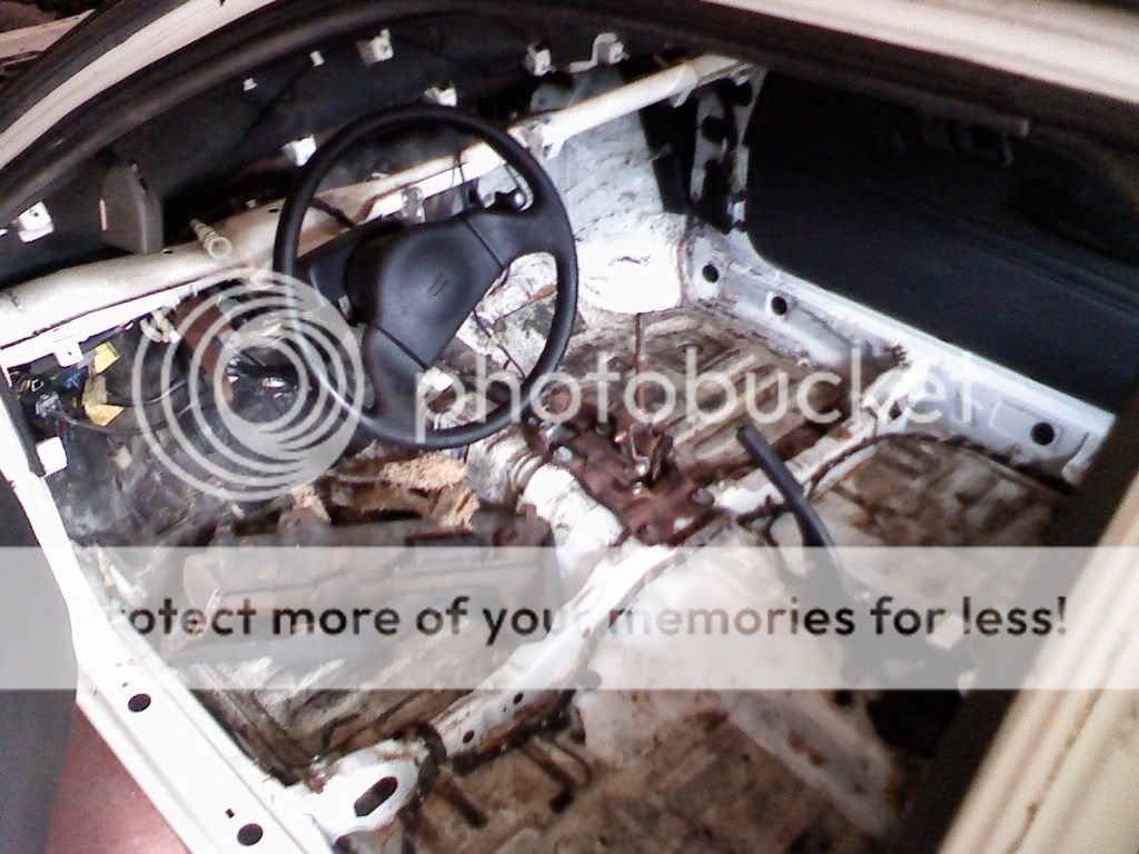

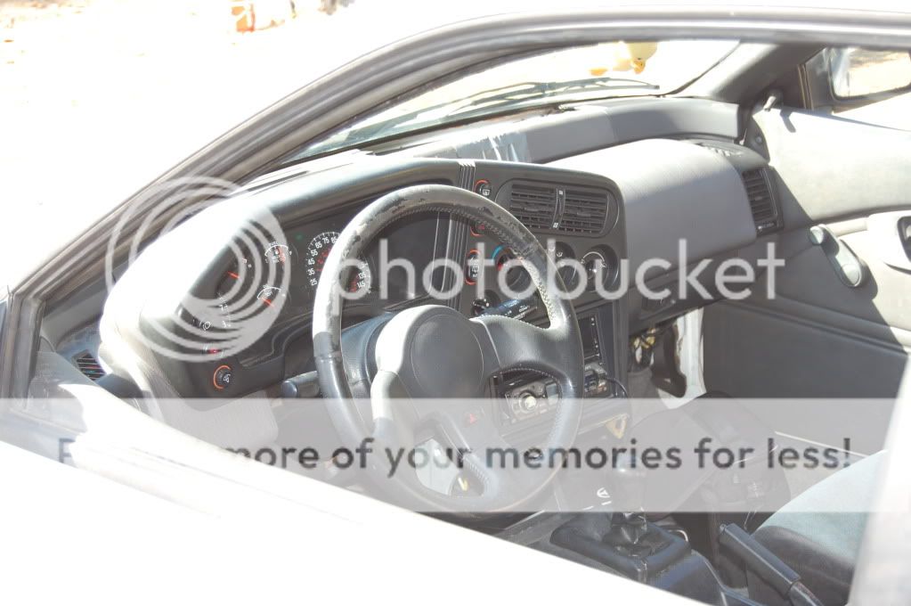

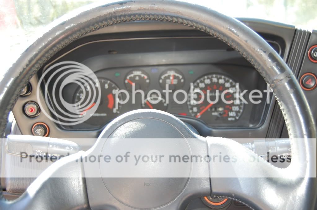

I definately like the fact that you put an Eclipse dash in a Colt. What did you have to do in order to make it fit? I'm interested in that! There's a 94 Laser at the yard right now that they're about to scrap. They might give me the whole thing for $50.
PostPosted: Mon Feb 15, 2010 5:37 pm
Posts: 399
Location: Tampa Florida
Basically it was horrible. We had to cut the crash bar out of the car and weld in the Eclipse bar. Extend the steering column a little and mount the new dash. It was pretty time consuming but those were the only real steps. The issue now is that the dash I have is in bad shape and I need to swap in a good one. Also the AC ducts don't quiet line up since we didn't put them in before welding the bar in (didn't plan on having AC but quickly learned I needed heat for the winter). The only hard part is getting that crash bar welded in the exact right spot. It must be oriented perfectly in all directions or stuff wont fit. Next time I take the dash out I will take more pictures if you are interested.
EDIT: The car has Eclipse seats mounted with new braces in the floor. We took front seat belts from an 85 Colt so I don't have to deal with that stupid auto seat belt...It made things much lighter and easier to deal with. Mounted in the stock holes with slight modifications.
