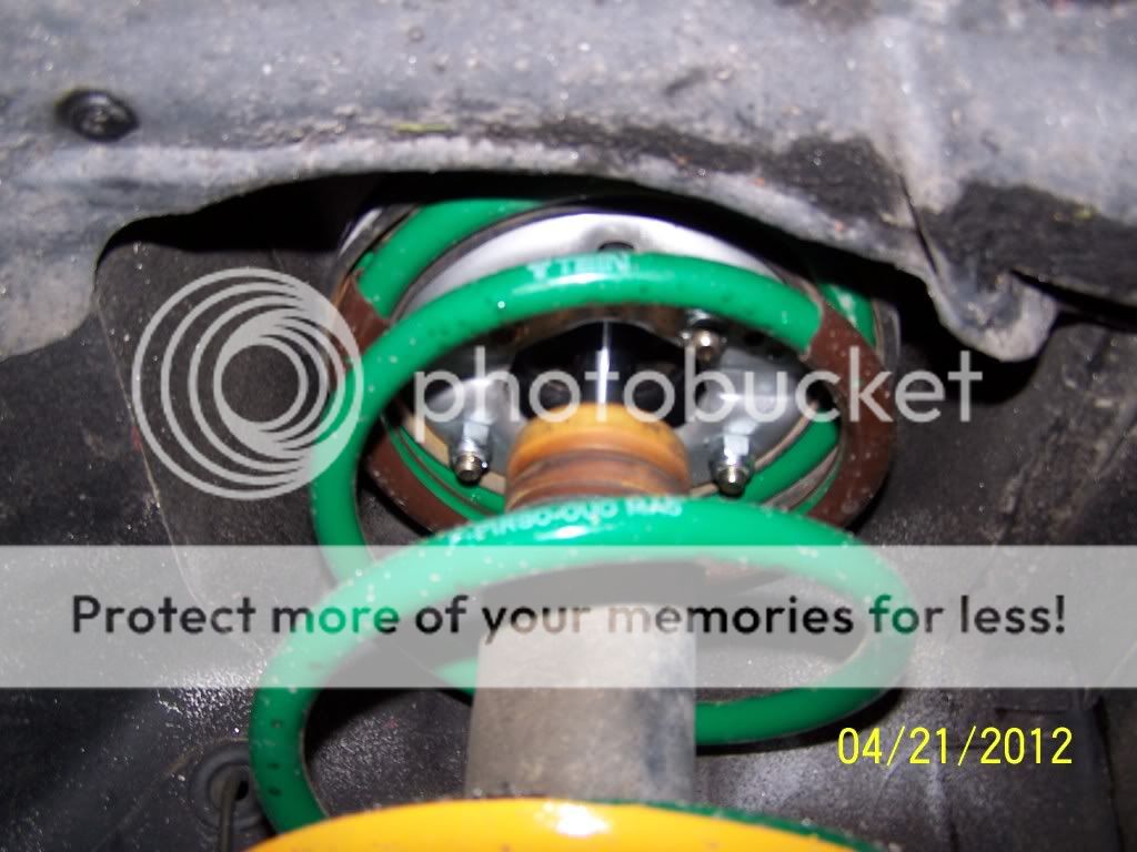

I got the Tien 1.2in lowering springs on the car last night. They basically have the same drop as the H&R but the H&R had a coil cut out. The ride raise .5inch which i was very happy with. I was not impressed by the condition of some of the strut component. I am going to order some new parts and sand and spray the seat. I might even think about new agx struts for a dsm.....Advice on this Thom. I didn't even look to see what was on it.

So after the Tien Springs settled the car is sitting too low again for the rims. The thing that ticks me off is the Tien where suppose to be less drop than the H&R. The summit sits at the same height with the cut H&R as the uncut Tien. I am calling extremepsi to see what they can do. I mean the advertise drop for Tien has to be wrong. I know they most likely will not be able to do anything but we will see. Anyone know for sure what a set of stock dsm spring ride at?
Anyone know the difference in dsm struts and summit struts? Is the spring seat at a different height?

Maybe you just need a stronger spring? The Auto is about 100lbs heavier than the maual, maybe that is making the difference. Strut part numbers are the same between the summit wagon/T/E/L

One of Jafro's videos on Youtube claims that a 3g csm strut is identical to the 1g dsm strut except the spring perch is welded on lower. According to him simply swapping a csm strut into a dsm would lower it a little. While I've never tried this or verified the info Jafro seems to know his stuff. Maybe a csm strut and the stock dsm/wagon spring would net you your desired ride height?

I made custom upper spring seats to get my Colt at the height I wanted with DSM Tein springs. I cut approximately a 2.5"-3" hole out the middle of a spare set of upper spring seats. Sanwiched them together with their uncut counterparts, then drilled four holes in them. Then I was able to bolt the cut seats under the uncut seats to make an adjustable upper spring seat. Add washers to raise, remove washers to lower.

In the rear, some brands (ahem AGX) don't even have the lower seat welded to the strut, so it's pretty easy to tap the seat off, and fashion a spacer to increase ride height.

I am grabbing a set of stock dsm springs this weekend and will get those installed to see what happens. This is kind of my last ditch effort for these rims. I was fooled last time I installed the Tien springs as Wagon sat perfect, but it settled quite a bit. I would have ordered H&R as I knew they were cut on the car currently, but extremepsi was out of stock and didn't know when the next set would come in. I am getting a fender roller ordered today as my buddy here in town keeps forgetting. I would love to be able to flare the fenders but not willing to have all that work done. So I might be buying new rims again. I am going to see if I have a POS dsm fender laying around the shop I can try and flare on the 92 half a car I have laying around. My buddy flare his fender some on his s10 with the roller and said it was not hard, but I know it was not designed for that. I am just disappointed all around.

I am giving it a weekend to settle and see where we are with ride height. I figured out I could space the top seat and the strut mount by .25 inch by adding harden fender washers. I don't see a problem with this and if anyone does let me know.
