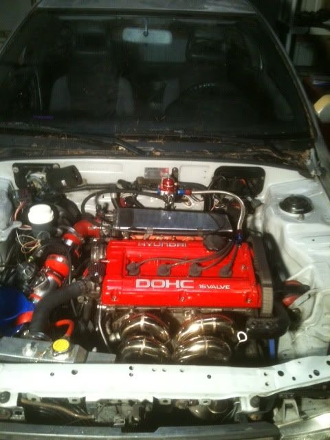

Updated pics.

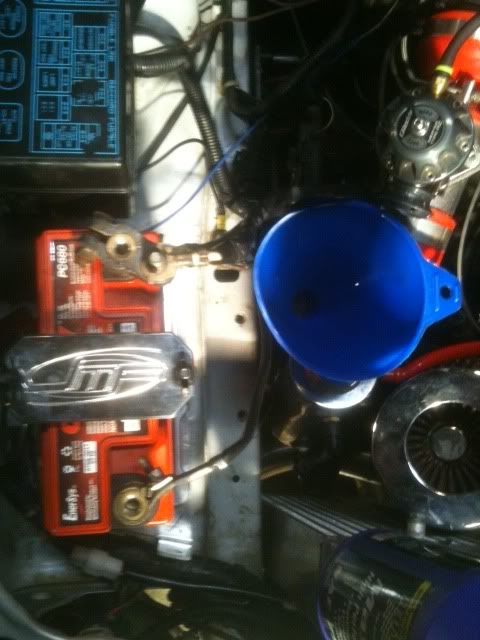

Excuse the tranny fluid stuff(2qrts. royal purple 90w125 and 1/2 qrt. of Redline 90w), it was about 20 degrees out, it took 45min. to fill :axe: So I took the time to take a couple pics.
She runs but is currently at 0psi WOT and reading -19 at idle, I think I have a large leak at the Magnus heat barrier intake manifold gasket, it warped, thought I could reuse it, guess not.
Still need to clean up some more wires and maybe relocate the GM maf and weld the coupler locations.
The COP needs some work and fine tuning so it had to go for now, I honesty just like it because it cleans up the look.
And going to cut the motor mount arm off.

Here are a couple recent pics.
I'm thinking of locating the battery down onto the frame rail area and running the intake over the top.
