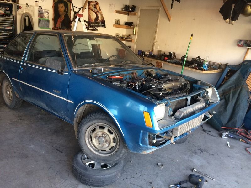

i just scored a intercooler anybody guess what its from? i thought it was worthy of posting a pic, man this thing looks better without the bumper. 28 lb bumper i might add. i do NOT want to putvit back on, looks way too good now, not sleeper enough
also relocated the maf behind the headlight now. ill remove the pass headlight and bumpers for track

Man that does look cool. What would be really sweet is to box in where the bumper was with some sheet metal. Like a rollpan for the front. Just fill and flush it out right where the indent in the fender is for the old bumper
