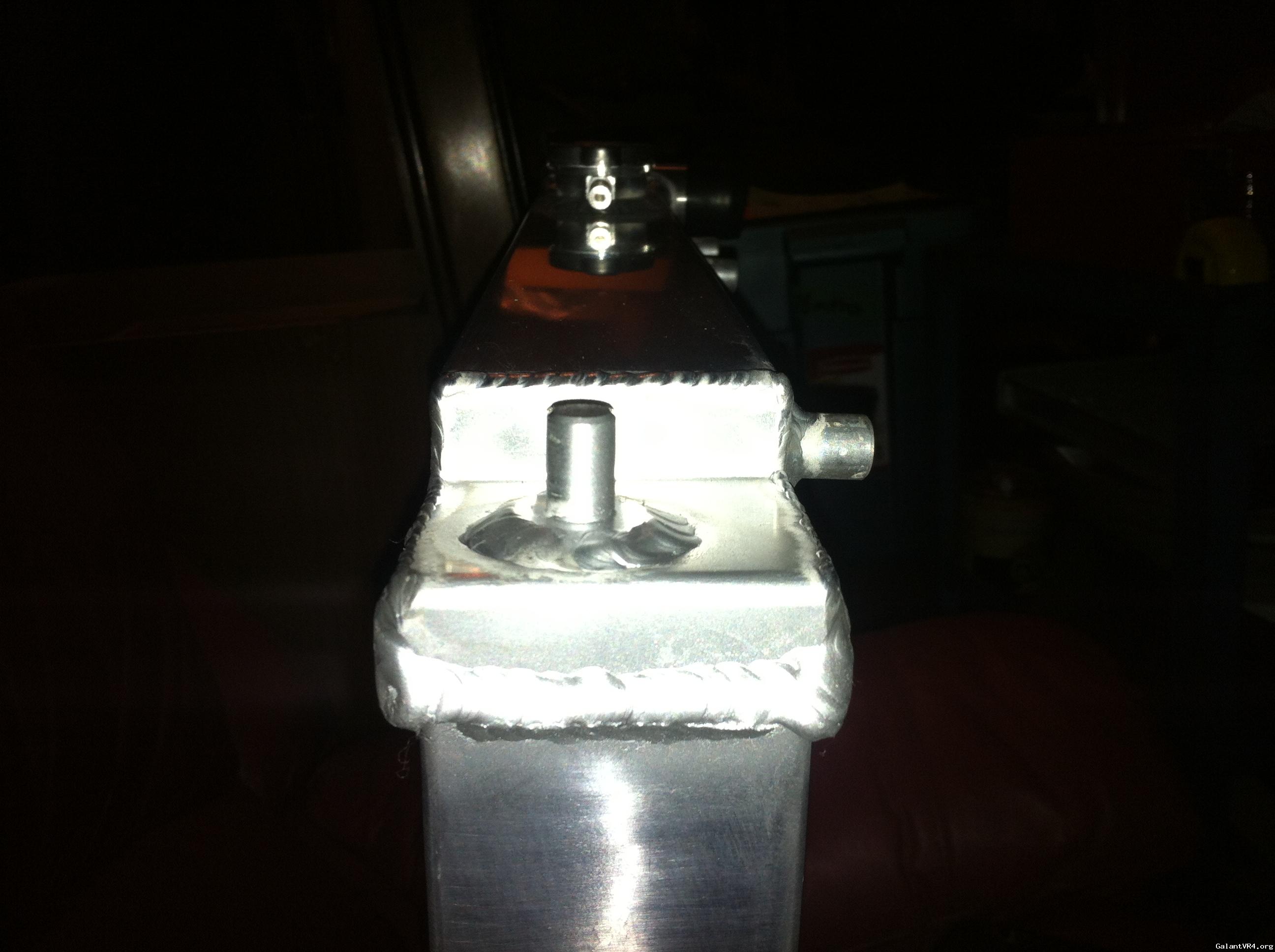

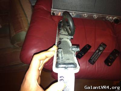

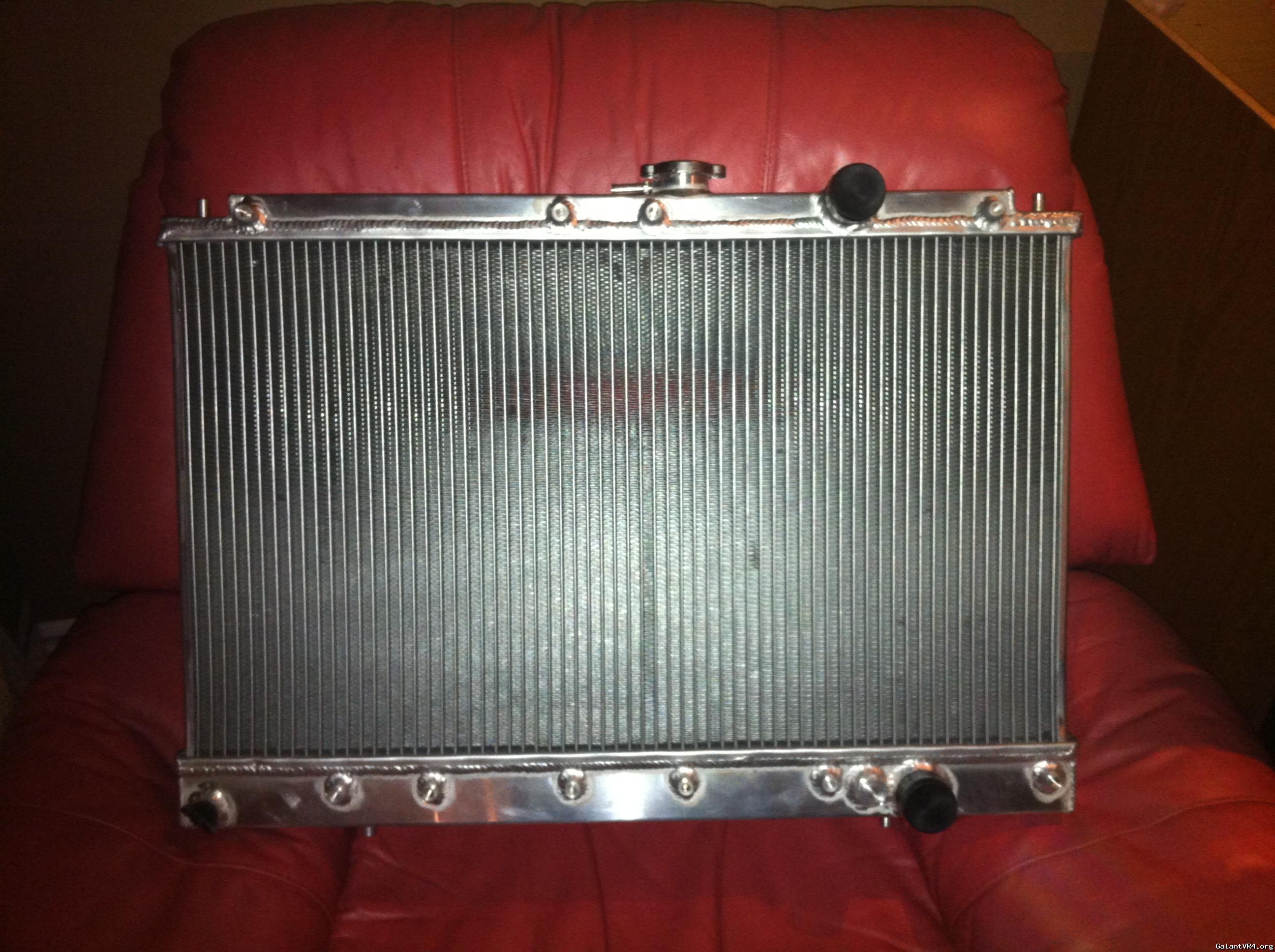

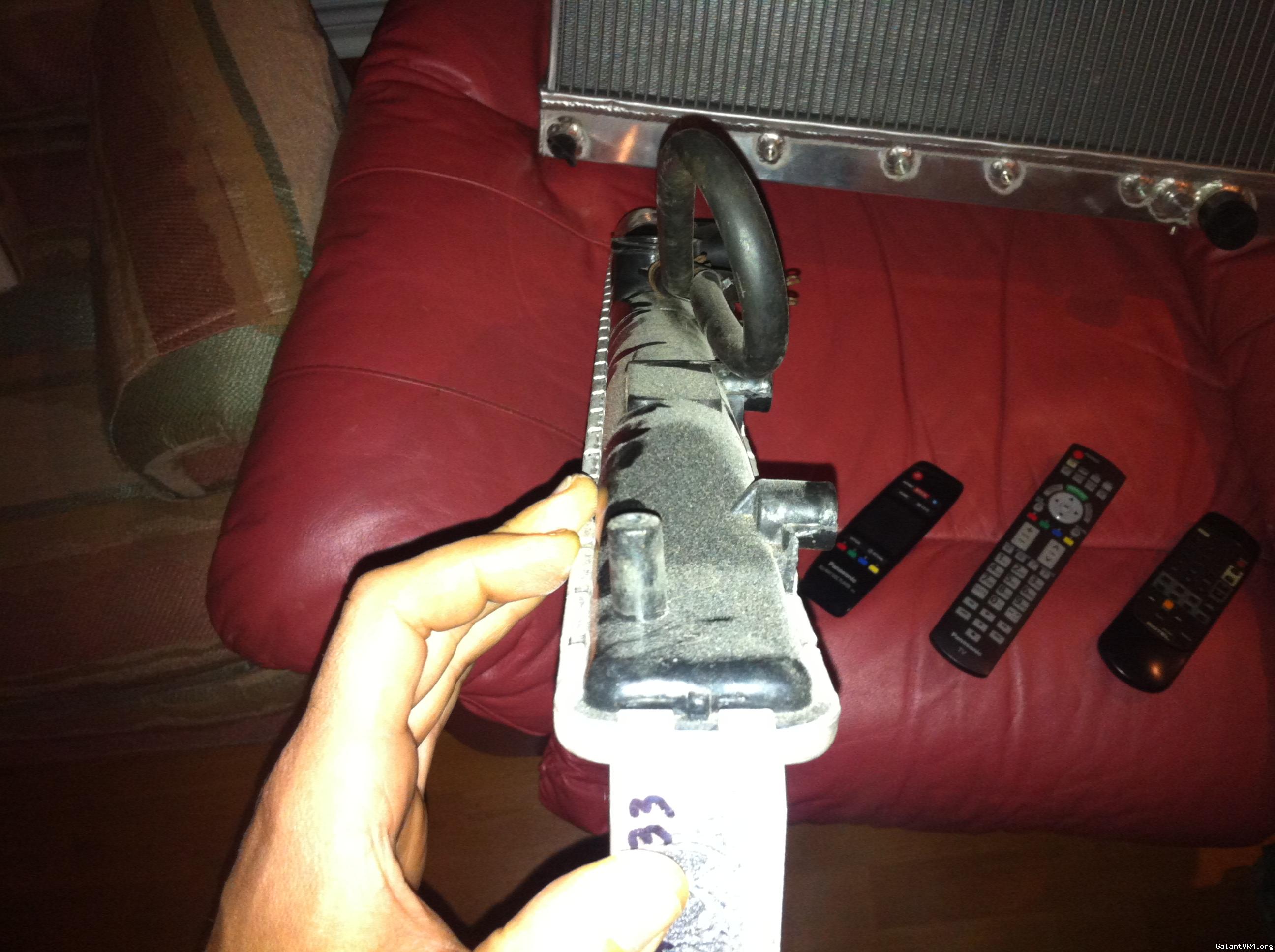

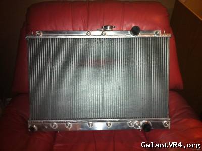

Received an Ebay all aluminum race radiator in the form of a Galant (VR4) application. Sourcing some new hoses and little things.
Started the clunk-no-go-sound again, and didn't spin that last time I went to move the car, unwittingly did have the harness apart and no coolant in it ... that was a bedtime moment if I ever had one.
The radiator is super thick and might pose a problem with fan fitment so it was a good thing I got thinner larger fans. 50mm thick to be exact.
Not sure on a shroud setup yet, but there is more room to work on that as the time comes.
