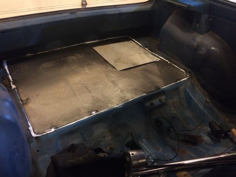

doing a carb to efi conversion one of the most difficult parts is fuel pump. there are many different ways to accomplish this, but this method was completely free, and will work excellent,
awd talon gas tank was perfect fit, with the spare tire well tsken out. i gained 10 pounds, but also gained a ton of fuel capacity. this car will be street driven a lot, not a race car build.
mostly it was free.
it would have been way easier to just use an external pump in line and the stock gas tank, but i dont know how well it would work, and they are apparenty very loud,
and this was free, like, zero dollars
