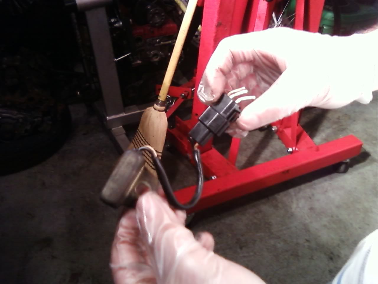

PostPosted: Thu Feb 07, 2013 2:27 pm
yes the 90 has the separate small silver tach box...
looks like this
http://img.photobucket.com/albums/v255/ ... 081402.jpg
PostPosted: Thu Feb 07, 2013 4:48 pm
Ill check that out. Thanks guys
