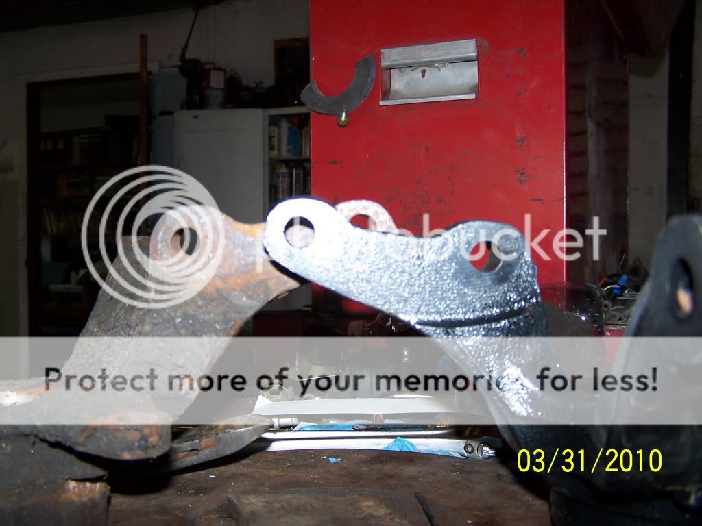

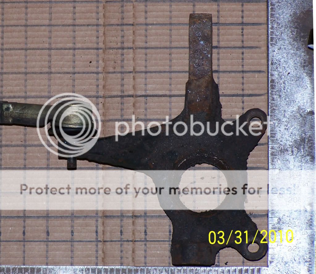

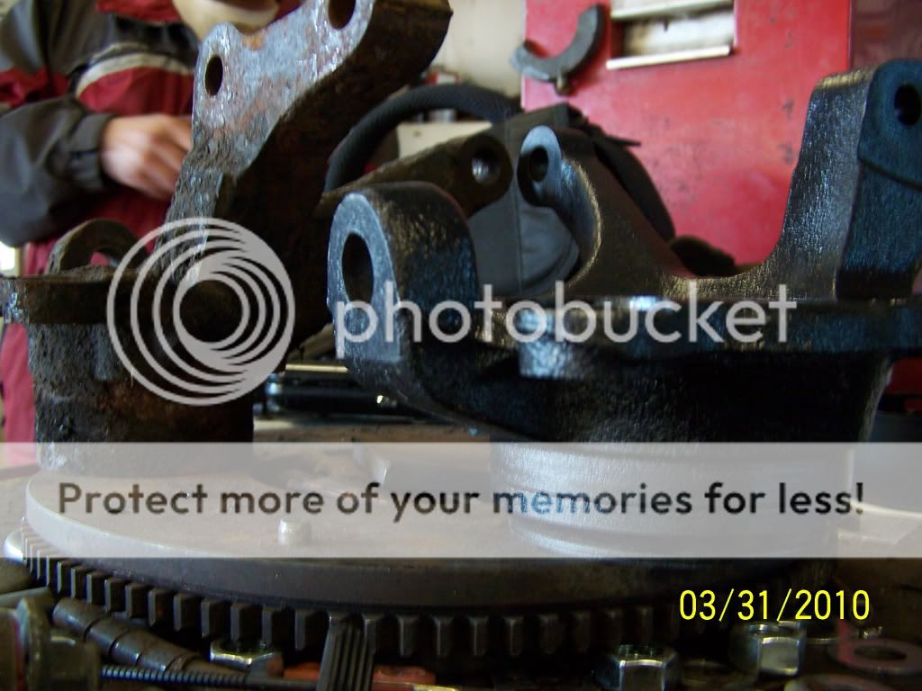

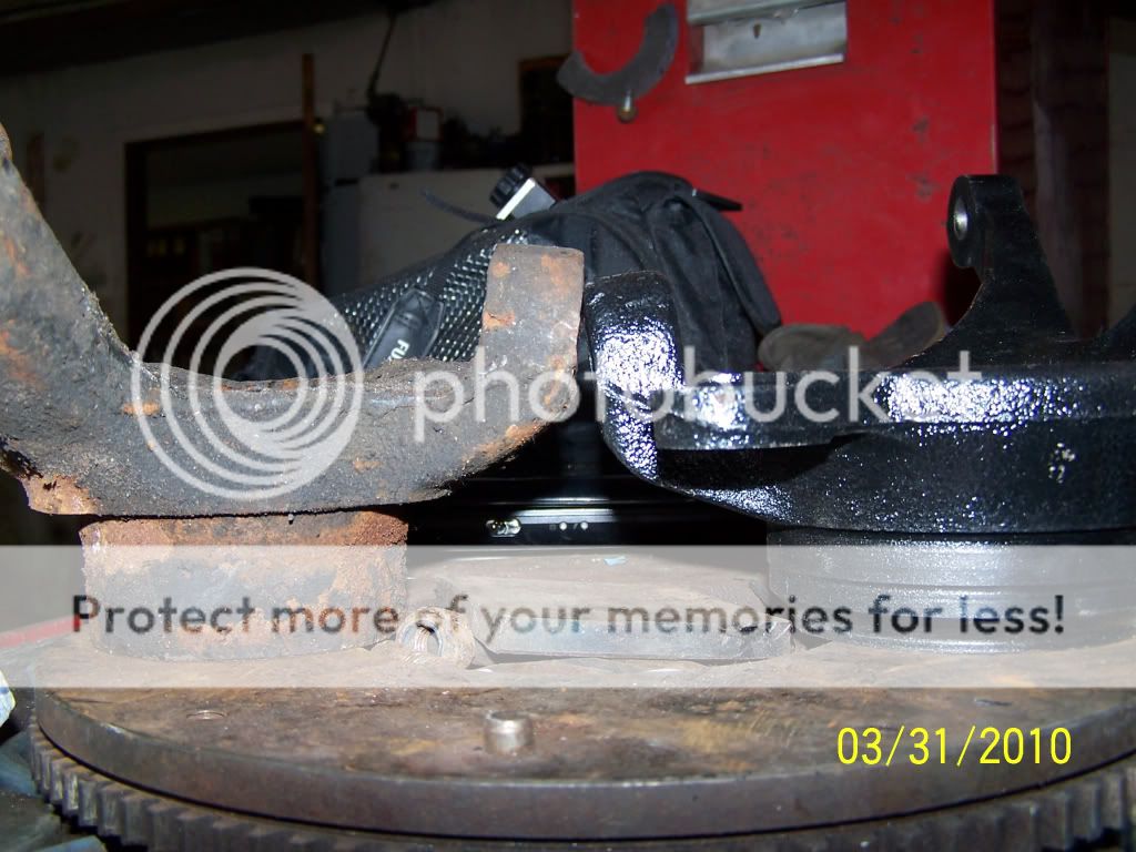

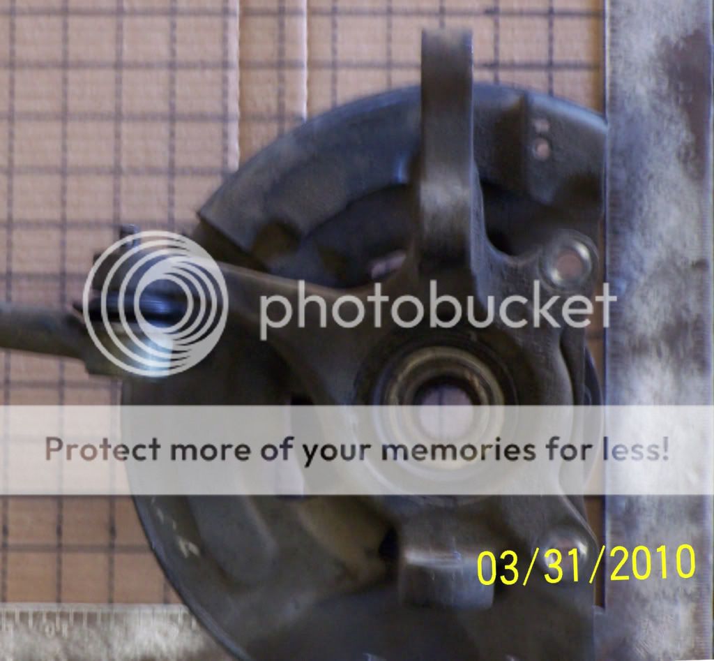

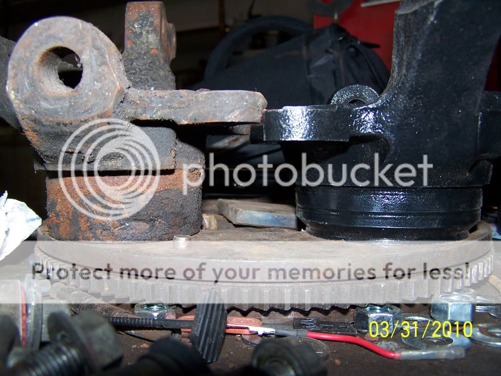

Here are the pictures I have so far. Chris is sending me the wagon knuckles, then I'll get some shots of those on the grid.
Colt Knuckle:
vr-4 knuckle:
DSM AWD Knuckle:

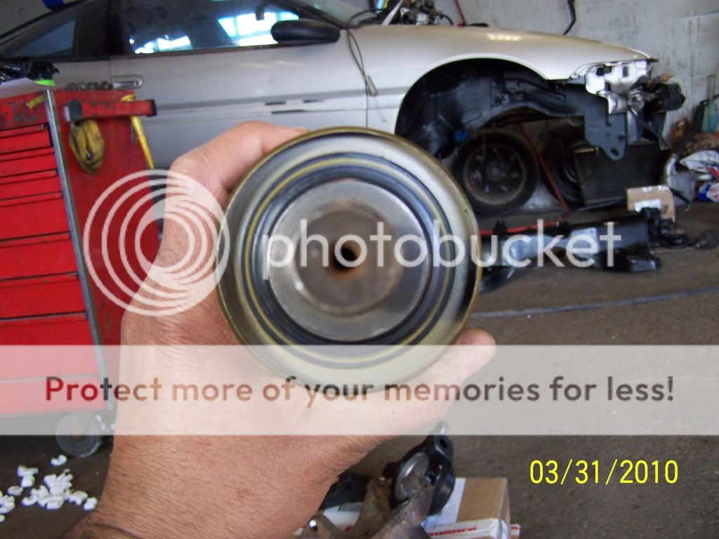

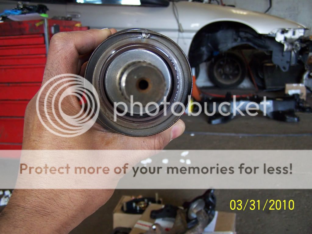

Here's how the Gvr-4 Sael doesn't fit the Colt axles:
Thefix:
Fixed:

Machining down the CSM hub and putting the rotor over it sounds like about the best idea, but I like the idea of having the beefier knuckle and bearing. Besides, I already bought camber plates.
In the thumbnails at the top of my prevoius post, it shows the difference in the hubs and bearings.
