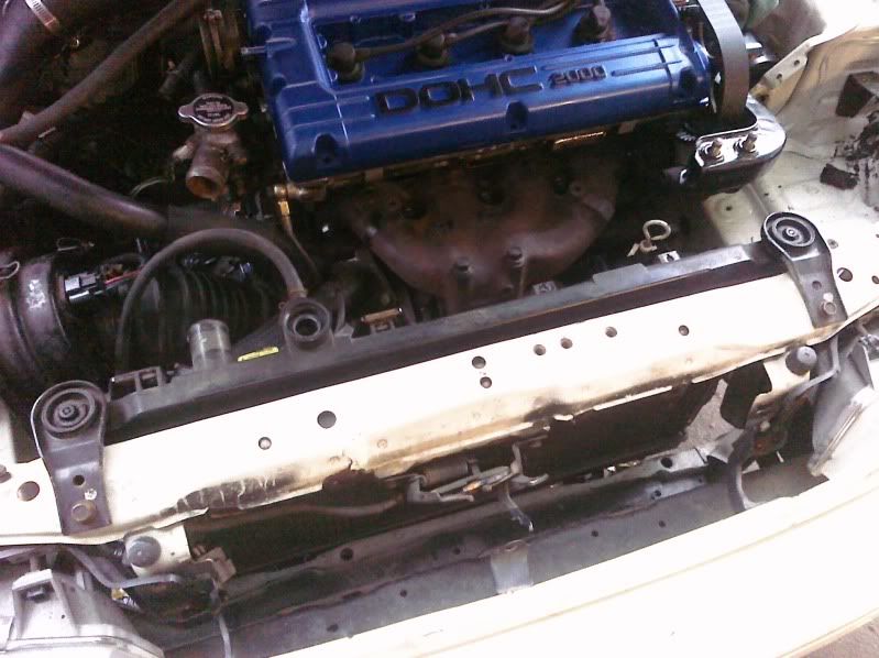

Hey there, I was toying around with different style radiators that me and my friends had. This one fit really well under the hood and has the filler on the radiator and the bottom outlet is in the same general area as well... here's a few pics of it installed underhood with an oem 4g63 ac cooling fan installed. This is from a 99 Acura Integra GSR
My only concern is the thickness of the radiator, it seems a good 20% thinner then a stock 1g turbo radiator. Does anyone know if it will efficiently cool a 4g63t? And will there be an ill effect of having 2 filler caps? The oem GSR cap is rated at 16psi, and the 4g63 one is 13psi.

You shouldn't have any cooling problems at all. People use Civic radiators in CSM's all the time, and those things are half the size of that Integra radiator. If you're concerned about having 2 caps then swap to a CSM (4g61t) or a GVR4 thermostat housing, those cars came stock with a cap on the radiator, but it shouldn't give you any problems. I'd probably run the same pressure caps in each, just because it seems odd to have 2 different pressure caps on there.

That Acura radiator is probably the same size as a Colt 1.5L radiator. I run one in my 4G63T Mirage with one 1200cfm slim fan and I have no cooling issues. :supz:

I had a gsr 4 years ago, I bought this radiator for a spare. I looked at it, thought about putting it in the colt. And it fit right in, even fits with the stock upper brackets. I had to buy a straight hose for the upper for it to work.
