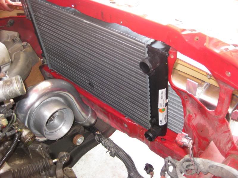

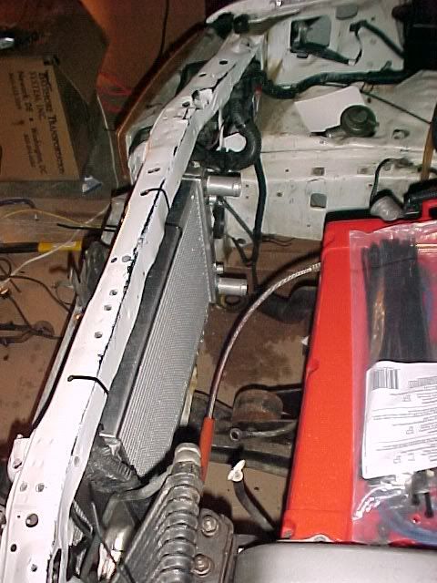

Get yourself a full size scirocco aluminum radiator, and you can mount it in the core support.
Hope this helps

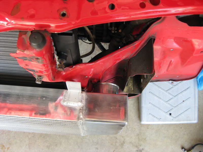

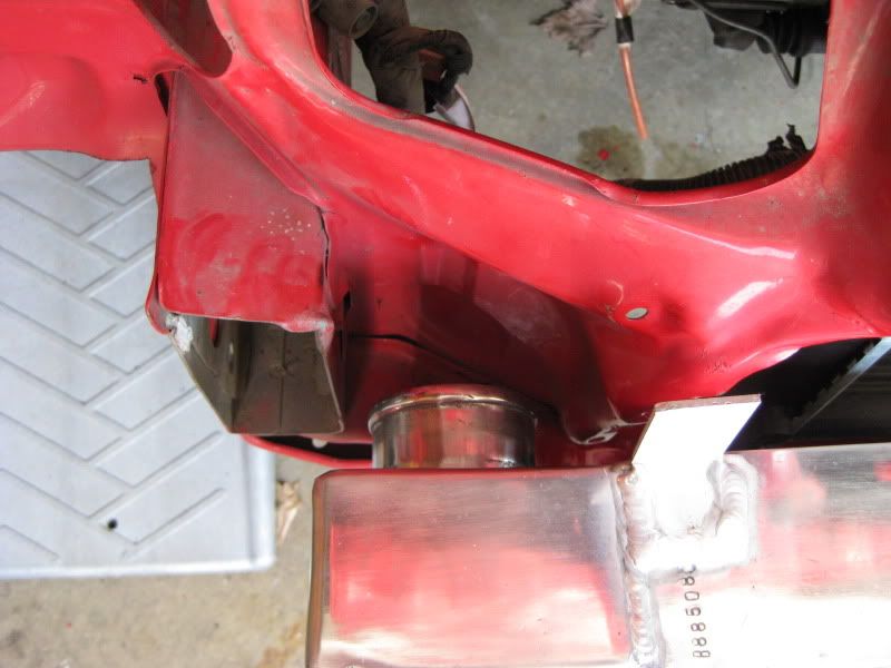

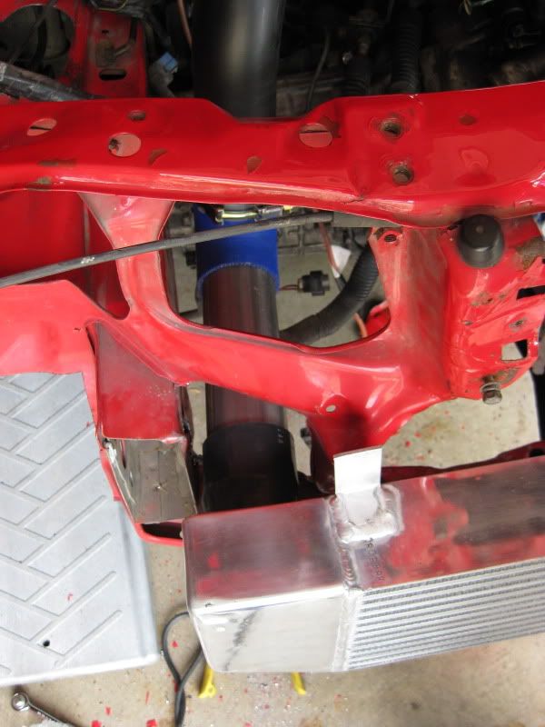

Just make sure the radiator fits in between the two intercooler outlets and all you need to do is trim a little sheet metal for the piping and you're good to go. I basically have the same setup and works great. Here's some pics...

The scirrocco radiator is thicker, but not as wide as the DSM/DSM/GVR4 radiators.
Geoff

If you're on a budget hit the junkyard and look for an early 90's Audi A100. The radiator sits off to the side of the engine bay. I did a write up in the archives a few years ago on how to mount it in a csm.
http://www.4g61t.org/forum/viewtopic.php?f=10&t=19003
