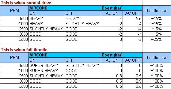

I see. But that is a weird condition. When aircond is ON, it really difficult to run and feel heavy. Heavy in term of like sitting in a fully loaded bus... :-?
Below stat is my summary:- Please advice...
PostPosted: Wed Nov 26, 2008 11:17 pm
The 1.6l has very little power at that low of rpm to begin with, the air conditioning compressor takes about 10-15 hp to spin. Does the engine rpm change when you turn on the a/c? The ecu should compensate for the extra load on the engine by raising the rpms. If it doesn't, that may be your problem.

The RPM does decrease and ECU does help to increase the RPM.
Normal idling with aircond ON = 800+/-
Normal idling with aircond OFF = 1000+/-
I did discover something just now. When I ress my pedal (Throttle Level) around 10% or less, the car is moving smooth and easy. When full throttle, the car didn't want to moe at all (1500-2500 RPM) and RPM slowly increase until 3000, then start to feel power. During the deficiency stage @ low RPM, I can smell petrol. I have an idea, would it be cause by AFR too rich? If I add in a Fuel Regulator, can it solve this problem? By the way, is that any method to check fuel pressure?
