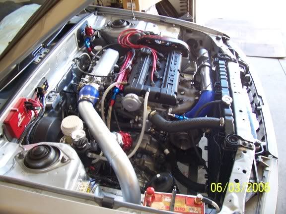

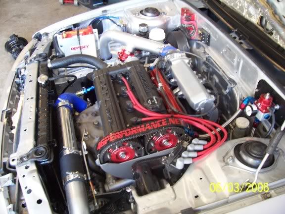

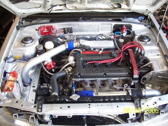

Well its been a while since I been on here, and after almost a year with the Colt being in the corner, I finally dug it out, dusted it off, and decided to get back crankin on it. This is mostly due to the fact I had a baby boy in July.
Im having trouble getting it dialed in. Running real shitty and loading up with fuel big time. I've changed so much stuff I cant keep up with it anymore nor remember which year parts I've used. Pretty bad, I know. A wrong CAS was in the back of my head and I couldnt remember which one I was running. Just thought I would eliminate that as a possibility. Just seems to be some kind of electrical issue. Weather its my wiring being wrong, settings screwed up, or a bunch of nick-nack crap screwing me up.
If you guys can think of anything, Im all ears... Heres a quik rundown of what Im working with...
89 Colt GT (originally 1.6t)
JDM 4G63T
DSMlink
MD166262 ECU (from a 91+ DSM)
91+ Transistor wired to make the ECU work
1g MAF (til I figure out what the hell is going on)
PTE 880cc
SX Fuel Pump
Aero. Pump Controller (which Im about to ditch)
Aero. Regulator
-8an feed
Holly rail
SCM61
N/T throttlebody
yadda
yadda
and a bunch more stuff unrelated to my problem...
oh and yes, it is AWD... at least thats working right lol!!
