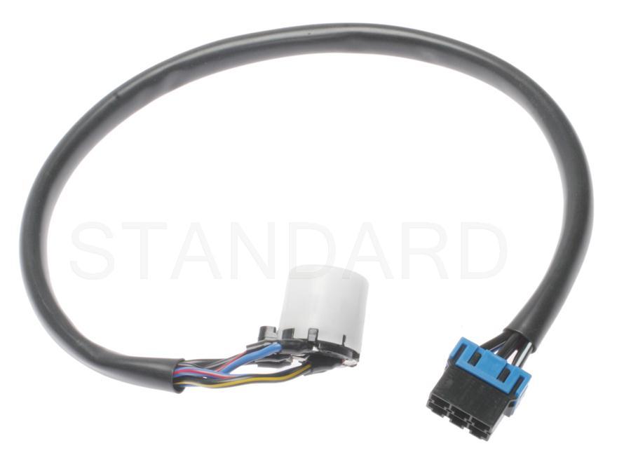

PostPosted: Sun Apr 27, 2014 5:15 pm
CSM Expert
Posts: 2187
The problem is the ignition switch mounted behind the ignition lock assembly.
Mine is doing the same thing. Jumping a wire to the starter and the car starts right up.
If you pound on the ignition switch with your hand it should work.
Many times when you turn the key you either just hear a click or no click at all. There's also a small philips head screw that holds the switch to the ignition assembly. Mine was loose.
