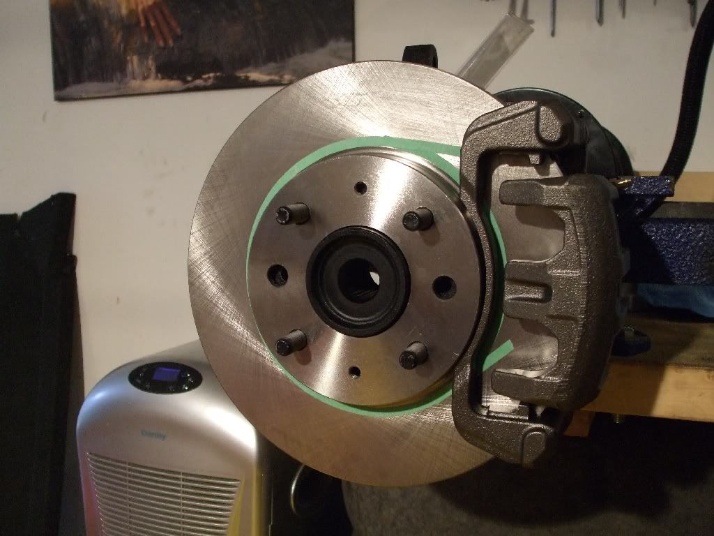

So this leaves me confused, why can't you use single piston galant rotors or the (probably identical) expo rotors.
Maybe they won't clear 13" wheels, thats all that I can come up with.
Actually, if we want to get technical here, the rotors will fit inside the OEM 13" steelies without issue. The actual reason I can't use those rotors is because they won't fit inside the 4g Mirage caliper when it's bolted to the expo hub. I just looked up some rotor specs on the Autozone website. The Expo & FWD DSM use a 256mm rotor. The GVR4 & AWD DSM use a 276mm rotor. The 4G CSM uses a 236mm rotor.
Odd... I thought the 1G FWD & AWD used the same brakes in the front. I might have to recheck a few things. I know I put AWD rotors on my NT FWD DSM... I wonder what part(s) of the full assemblies are actually different between the two (If any at all). Is it the caliper brackets, the mounting ears, the pads, or the calipers? The same differences probably exist between the Expo and GVR4 as well.
Now I've confused myself. I'm going to have to pull some more parts out of my collection and see if there are any real differences.

Wagon Hub & Knuckle (w/ new bearings and seals)
VR4 & Talon Big brake kit (before painting)

Screw 13" wheels...
I'm about half-way through the swap right now. I'm just taking a break to eat some food. I'll come back on later and post pictures.
Used Expo hubs - $50 from junkyard
Used DSM calipers - had them laying around
New DSM pads - $20 from Autozone
New Expo rotors - $50 from Autozone
Used Elantra LCAs - $25 from junkyard
New Elantra LCA ball joints - $60 from Autozone
New CSM outer tie rod ends - $40 from Autozone
Used 240sx sway bar end links - had them laying around
Used 14" wheels - $50 from a pal & $1 for spray paint.
New hub centric rings - $10 from ebay
New Sumitomos - $200 from my local source
Brake Fluid - taken from my supply
Grand total: $505
So I've got about $500 into it so far. Wow...I shouldn't have added it all up. Good thing my wife isn't on this forum. :lol:
If anyone wants a set of 13" 1-winter-old Winterforce tires, let me know... I'm going to need some bigger winter shoes now.

First off, sorry I haven't been able to post pictures. I can't even get the stupid things to upload on my POS internet .
Second, I've been driving around for a little while with the new brakes. Of course, I took the car out and bedded the brakes right away by doing like eight 70-0mph braking sessions while making my way around the country block. The car definitely needs a bigger master cylinder now. The brakes are a bit mushy for my liking. However the car stops great!
The first thing I noticed when I first got the swap done though, was how completely out of whack the alignment was... I thought for sure I had put everything back in the same position - but even if I was off a little bit, it shouldn't have looked that crooked! I spent about 4 hours screwing around with the alignment. The camber is still really positive and I haven't really had a chance to mess with it. I'm going to go with the "bolt and slot" method hopefully on Wednesday. Then sometime in the next week or so take it in for a real alignment so I con't blast through my Sumitomos. I'm all ready starting to get some slight feathering from the toe being off-spec.
