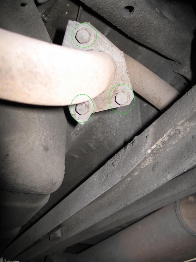

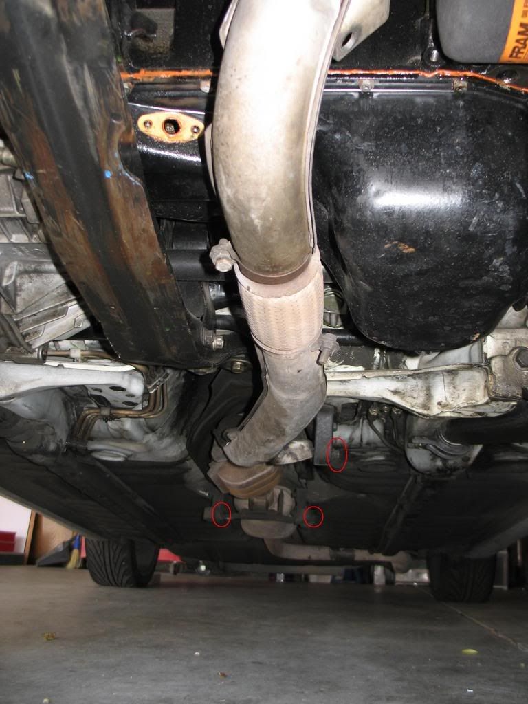

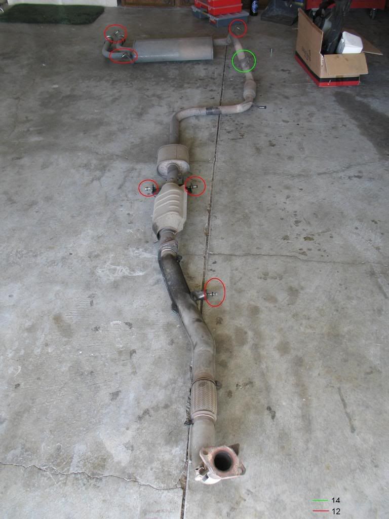

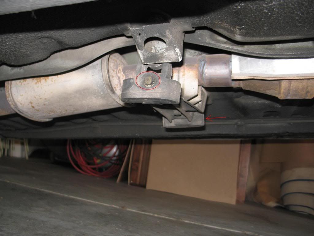

Spend last week reading around the forum, and figured that I?m going to install small 16g, 2g manifold (already ordered), will try to get 450cc or 490cc injectors I will try to get the 3 inch down pipe (anybody knows who I can order it from?)

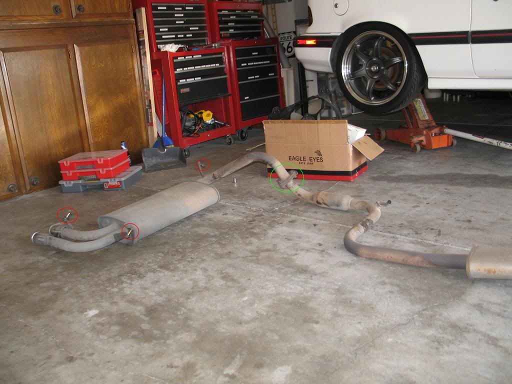

Today decided to take the down pipe off?
Little right off with pic?s
(my manifold and turbo was already off)
Tools:
Ranch
12mm
14mm
Put the car on the jacks. All you have to do is unscrew 6 12mm and 3 14mm screws.
(thouth 3 are hard so get a bigger ranch :twisted: there also going to be a lot of dust so protect your eyes)

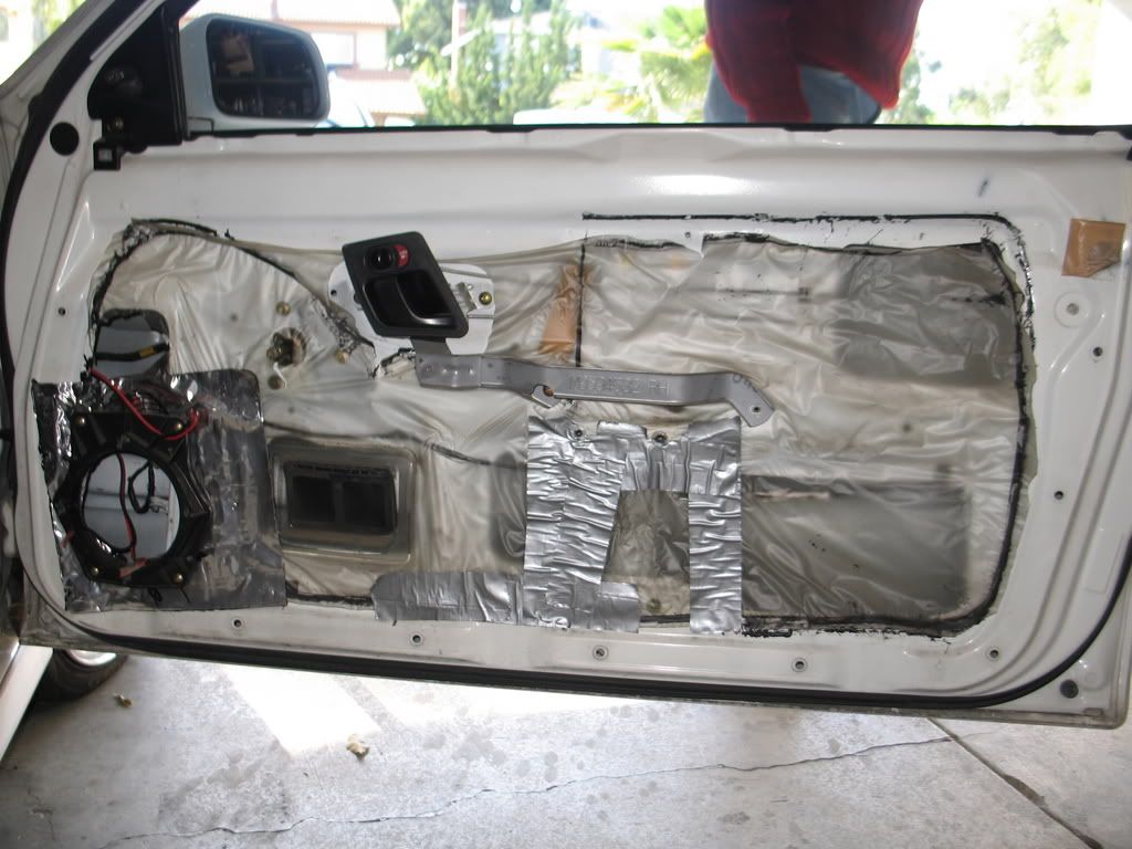

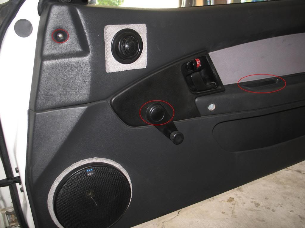

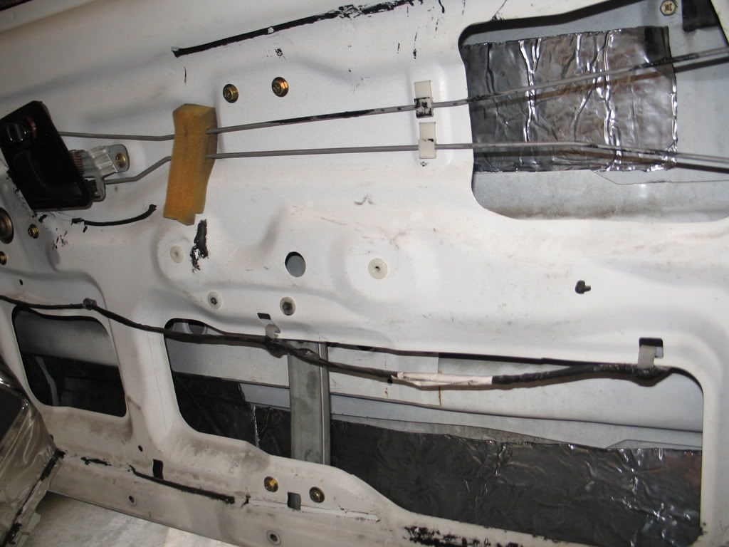

Also decided to sound proof my doors.(i know it adds up some weight, but i'm not too consern about that)
My dad used dynamat for his audi, he had some left, so why not use it?!
so here is some pic's on how to take the door cover off
You will have it somewhat different. Without the speakers and little water protection (remember, I inherited the car from my dad and he had a lot of work done to it, although keeping it stock)
