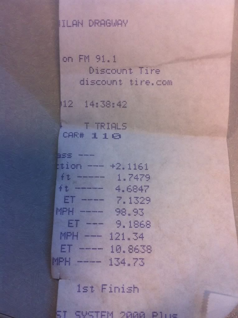

After some more manipulation ... adjusting 2 step and playing with the boost control .... I decided to let old girl Vida Eat...
and we were rewarded with our FIRST ten sec pass 10.86 @ 134 mph.... HELLL YES

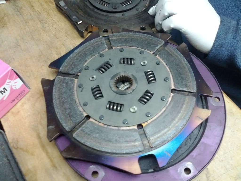

the next passes were poor and the reason being, was that the clutch was giving out . On the last run, the car had to be towed of the track.. ( we could see shrapnel dust coming through the Bell housing, so we will post pictures when we take it apart...

thanks ben, its been a long time coming for that car. I am tearing into the car tonight, to see what exploded on the clutch front. I am hoping to either upgrade the twin disc to a triple set up or move to the newer Quartermaster series

clutch pictures for folks
disc thickness was close to the wearing plate
floater plate number 1 above had extreme warpage ( 1mm of runout) lol, that is what happens when you launch at 7200 rpm
