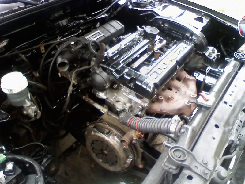

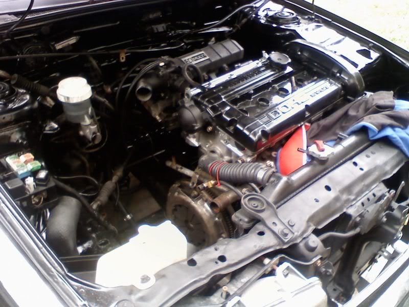

I was at work pretty late today and one of my buddies decided to come up and help me out. See I helped him install the engine in his 70 Roadrunner a few months ago and that's been the main focus for both of us recently.
Anyway I took the engine and tranny out of my 92 Colt a few days ago and I degreased and painted my engine bay to match the rest of the car so I didn't have a black car with a red engine bay and hood. Plus the fact that my block is painted black didn't help either.
Reguardless of the fact that he's on vacation he and his friend installed the engine in my car while I was at work and decided to send me these pictures.
The specs:
4G63t
Evo 8 pistons
1G big rods
Evo 3 cams
Adjustable Cam Gears
New valve seals and FelPro headgasket
Brand new OEM oil pump
450s (For Now)
Balance Shaft Elimination
2G manifold
60-1 turbo
40mm wastegate
2G MAF
1G Non-EPROM ECU
91-94 Harness
F4M21 trans for now (I know I know it won't take it)
Stage 1 N/A clutch and flywheel
I'd really like to get DSMLink V3 eventually but I'll let the stock ECU handle it for now. Give me your feedback, it makes me happy. I can take constructive criticism. Thanks for looking!

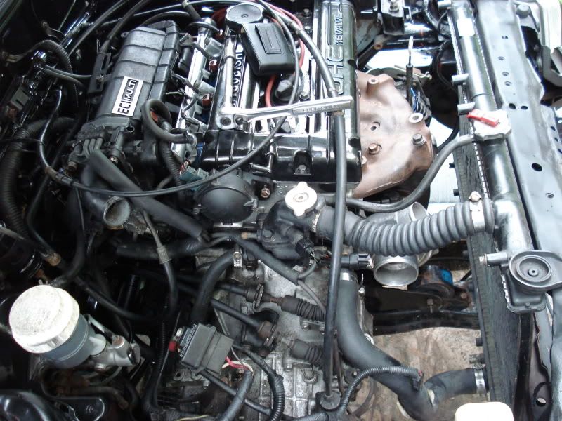

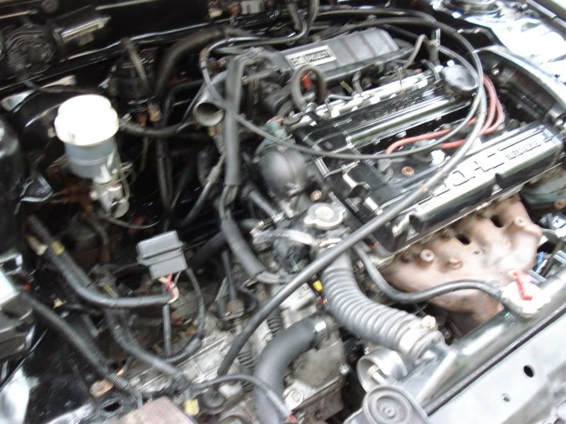

I got a few more things done. Tranny's in, axles are in, harness is in, ECU's in, turbo's on (at least until I can get my manifold tapped for the wastegate), fluid's in the rad, oil pan bolts are installed. I'm getting closer!!!

Make sure you zip tie that o2 wiring up out of the way...
