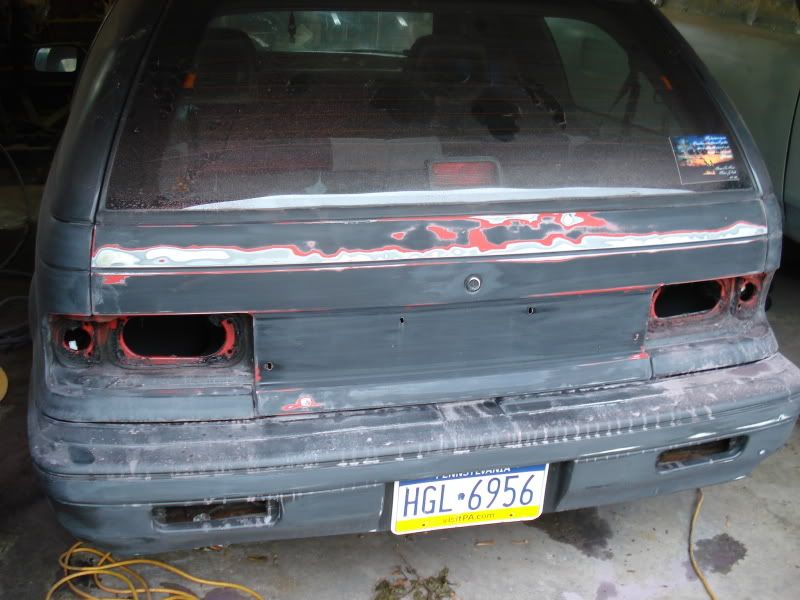

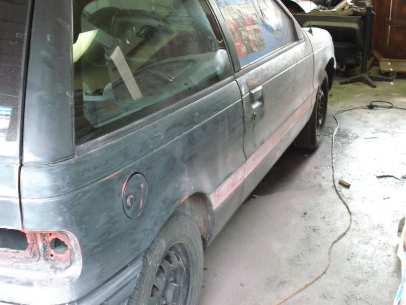

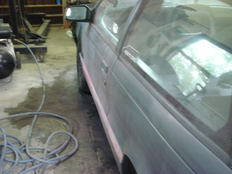

Getting the body work done...

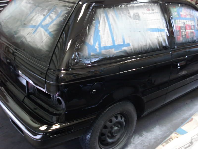

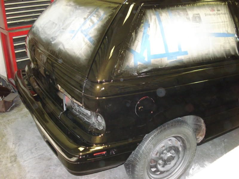

Well, I knuckled down today and did my thang. Keep in mind I've never painted a car using a gun and lacquer before. You've all seen the before pics. Well here's the after.
Without Flash:
With Flash:
There's still some waves and dents in it but I wasn't looking for a SEMA paintjob. This was done in a garage using cheap tools and a small air compressor...and ALOT of patience.
PostPosted: Wed May 27, 2009 4:58 pm
From what I can see it looks like a decent job for what you had to work with. A+ for a diy job well done. I would open the gas door and black it out with a spray can though. :wink:

Just a simple base and clear. It's a mixture of Jet Black, Gold Pearl, Yellow, and Blue. It's from a 2004 Sti. I'll let it dry and harden for the next couple of days and then I'll go back and fix the runs. Then it's wet sand and buff time.
Question Chris, when I wet sand it with the 1000, then the 1500, then buff with rubbing compound do I use a wool pad for the compound stage? Wouldn't that heat it up too much? I bought a foam pad for the glaze but shouldn't I use a foam pad for the compound too?

Looks like you still have some red left under the near the gas cap. Nice paint job!
PostPosted: Wed May 27, 2009 11:04 pm
Yeah, I plan on getting some more of that paint because I have to respray the hood with black and clear it still. I got the whole car done but not the hood because when I sprayed it it cracked at the front of it. When I spray it I'll mask the area surrounding it and spray inside the gas lid too. I just saw a buddy's thread here and I want to paint the inside gauge surround the same color as the car too. I also painted the valve cover, timing belt cover, and my spark plug cover the same color.
