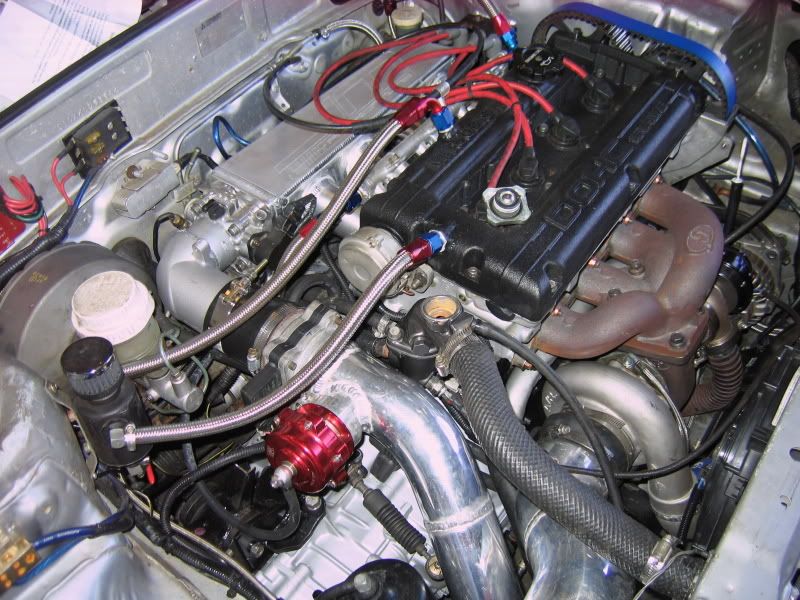

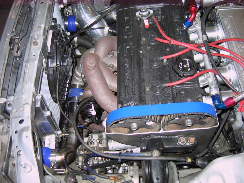

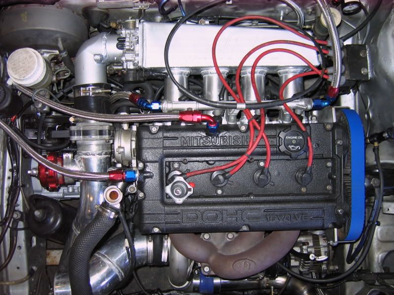

Just some new/better engine shots...

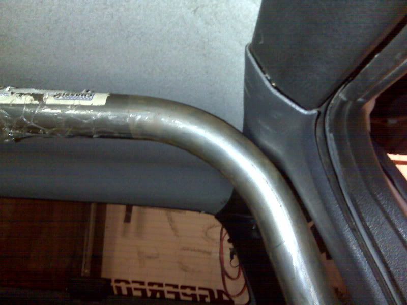

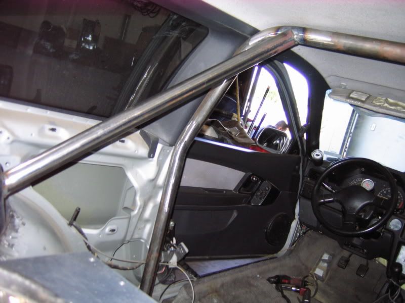

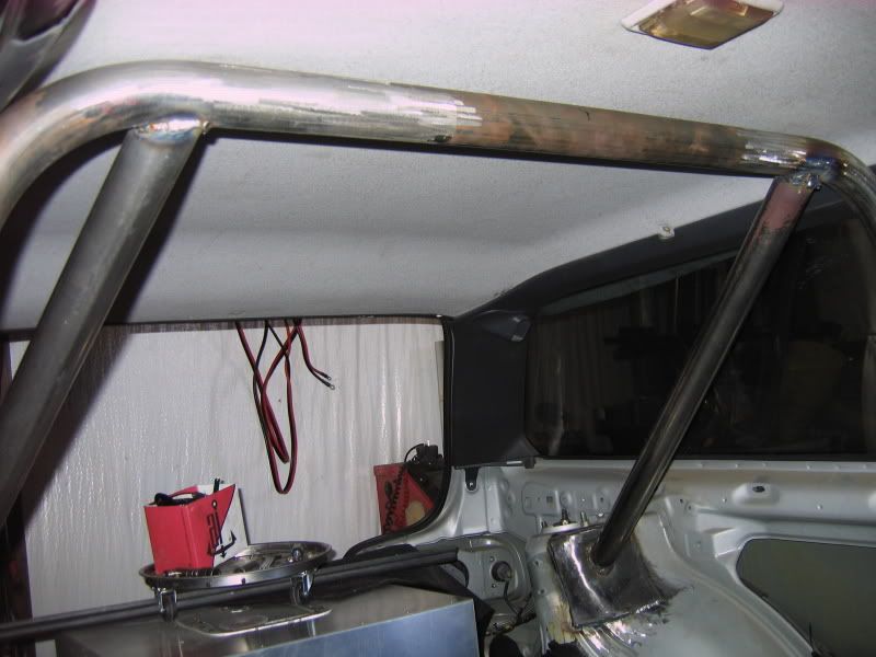

Here is a cage kit I bought about 6 years ago for my old 1G DSM that i never got around to put in, All I had to do is trim the legs down on the main hoop and damn it fits good! I think I paid about $275?? So get a DSM kit!!!!! Dont spend $500+ on a CSM kit!!!!

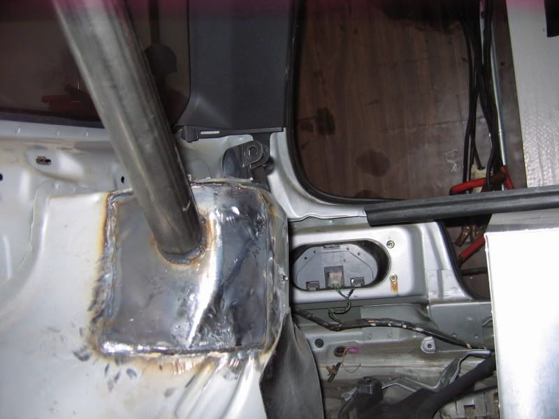

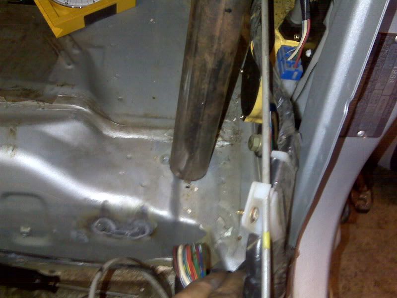

You can see how nice and tight the hoop fits. Also you can see where i decided to mount it. Its a very strong location since its where the front floor, rear floor, and rocker box all meet.

the car is looking really good man. i see you welded a elbow to your throttlebody, i kind of had the same thing done. you should be 9's in no time. :D

great car. what radiator is that? and how bout some more pics of the fuel cell setup :D

Also by plating the spots where you welded your cage in you're now legal right? My last colt someone hack jobbed a cage in it and i would like to do it right this time, myself. Looks awesome BTW and those are some really nice numbers!

What's that black cylinder by your bov?

Its actually a AFCO drag scirocco style radiator. Fits perfect where the a/c condensor used to be. Id get some pics of the fuel cell setup but its all enclosed now. Nothing really special about it though.

Thats black cylinder is my coolant bottle. :D
