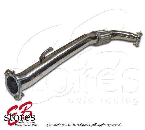

Yes, the evo3 o2 housing has a goofy angle, it's why I sold mine (for $75) and went with a ss 2.5" o2 for $60. The only difference between 1g and 2g megan downpipes is that the 1g goes straight and the 2g has a bend (which puts the outlet directly into the tunnel under csms).
1g
2g

Actually judging by the pics that you posted, there doesnt seem to be too much difference between the two downpipes. Just the angle that the pics were taken. I have a 90-94 AWD downpipe and Megan Racing tubular o2 sensor housing on my car and the downpipe ends right where the stock exhaust begins. I thought I would have fitment problems but the downpipe fits exactly like it was made for the car to begin with.

The 1g has a slight bend after the flex and right before the flange whereas the 2g has the two distinct bends after the flex closer together. Either one will work, the 2g dp just fits better in my opinion.
