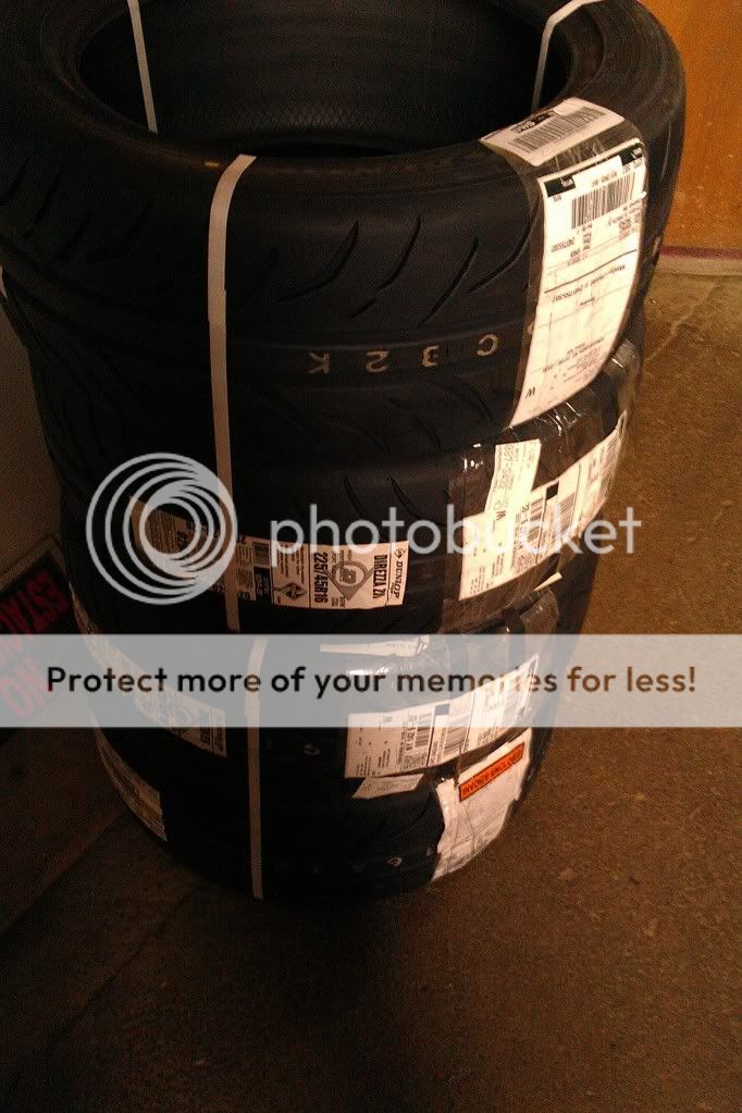

Dunlop Direzza ZII 225/45/R16
Currently retailing at $129 each from tire rack.
