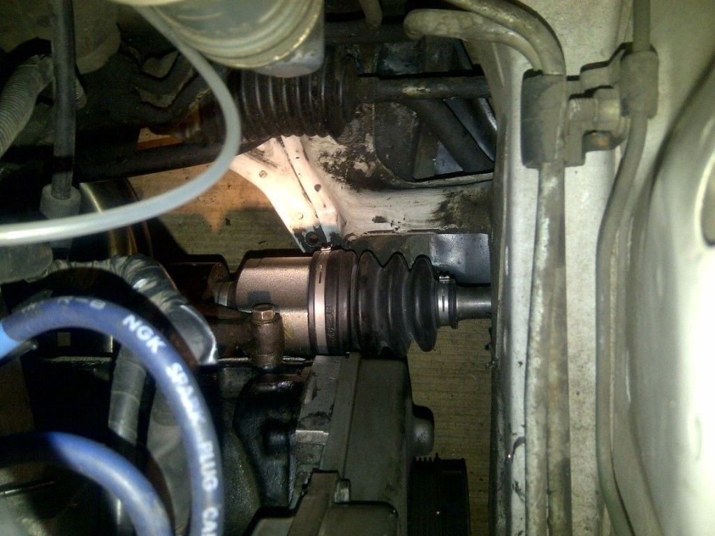

Here's a pic of the cv joint. It doesn't look like an extreme angle to me. I see no reason it should be leaking unless Carquest axles are just crap. I never should have got rid of the stock axles.

no a/c compressor?

Um no I dnt see a a/c compressor is that bad thing or what. My talon aint got one either

He is using the equivalent sized spacer in place of the AC compressor bracket. Should be just fine that way.
Strange the axles keep leaking. Is the boot pulling loose from the inner most sealing area around the tripot?
