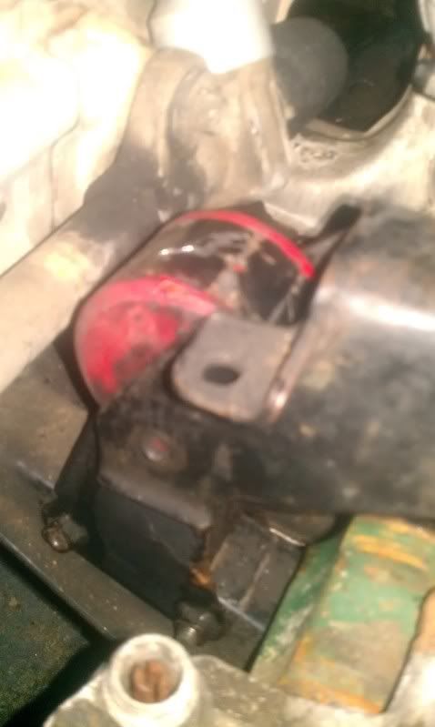

Hey guys im having trouble with the rear bracket on the 63 swap.I'm using the rear roll stop mount from a turbo but i dont know what braket to use,The fwd dsm doesnt work and the 1.5L one doesnt align.
PostPosted: Tue May 22, 2012 11:17 pm
I think the fruit and banana problem is with the rear metal mount,Im using all the elantra timing belt mount and tje other from the mirage turbo and the only thing im using from the 4g15 is the rear metal moumt because the 4g63 is too large.

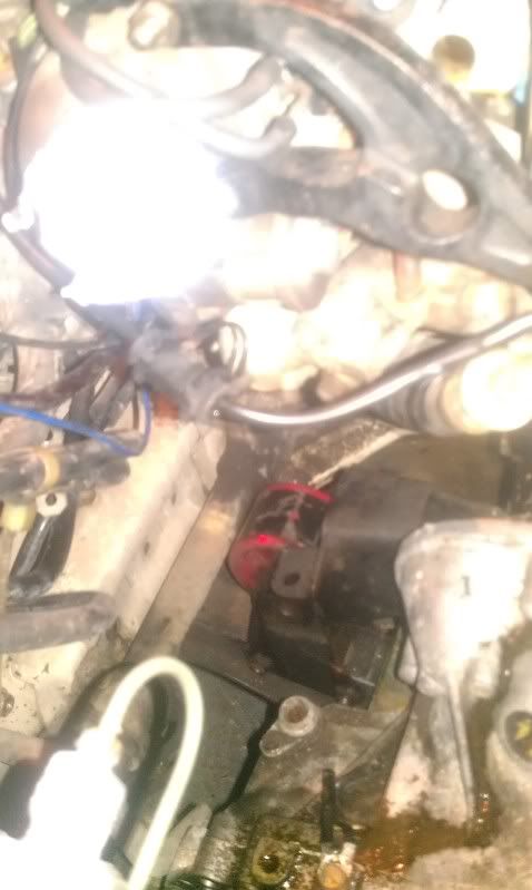

PostPosted: Tue May 22, 2012 11:29 pm
This is how it looks with everything bolted on
PostPosted: Wed May 23, 2012 4:59 am
Looks close. Remember to not tighten the mounts down all the way until everything is connected, leave some wiggle room and get yourself a good crowbar to lever it around in there.
PostPosted: Wed May 23, 2012 10:44 am
Ok,So thats the correct rear metal mount? And the front one is the one that has stamped 347?
