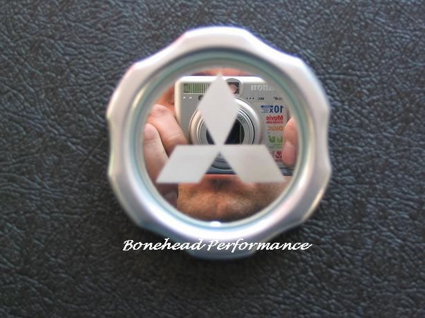

Pics would help :flux:
Show some pictures of the bottom of the oil caps you ahve questions about, If available.
PostPosted: Mon Nov 29, 2010 9:08 pm
That's just from a google image search...
PostPosted: Sun Dec 12, 2010 2:45 pm
None of those caps are good for your car.
They may look nice but you ALWAYS run the risk of the screw coming out and the cap coming apart and the screw going into the motor.
Pick up an EVO-GSR thru EVO XI oil cap :)
