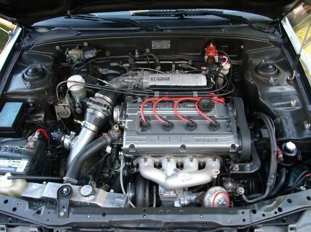

i was wondering if anyone had any pics of a hx35 setup in a csm.
i was interested in running one but wasn't sure about clearence issues.

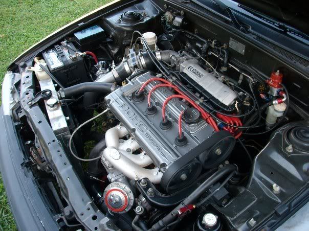

Here's a couple shots of my install. Let me know if you have any questions or need some closer pictures.

how much power did you make at what psi, did you use the bep housing? im thinking of going with an hx35

I never had the car professionally tuned or dynoed and it uses the bolt on .55 a/r bep housing. The car is currently set at 24 lbs and runs very good and strong. If I were to take a guess it should be making 375+ hp.

how will the car spool without the bep housing ? I am thinking of going with the holset exh housing that is on it.

I'm running a HY35 setup using a ERL manifold, stock holset 9cm housing, full 3" downpipe with alt and oil filter in stock position. I am currently on wastegate pressure, around 21-22psi. I get full boost by 4300 with a small leak on the manifold gasket.

Nice. :D I really dig the short route piping, did you have to cut into the car much for them to make it through and what radiator are you running to get the pipes around it?

No, I didn't do much cutting, just a little sheet metal. I'm running a scirroco radiator, it fits really well and give a little more room then a stock one would.

I'm running a 7-blade HX35 in the bep .55a/r housing bolted to a ported 2g manifold. I really had to do some dent work on the water pipe, and the compressor outlet is clocked upwards, but it fit just fine other than that. My colt just made 394whp 350tq at 6100rpm on 22psi and E85. He let up at 6100 because I'm only running 880cc injectors and started leaning out too much. Bigger injectors and a better tune at the same boost level...it's well over 400whp. I plan to run over 30psi in the end. Full spool was at 4200rpm. I highly recommend this turbo, especially if you don't have the $1K+ it will cost you for a turbo made by other companies with similar flow rates and potential. Talk to Justin on dsmtuners(jusmx141 I think) and he'll give you a good price on a freshly rebuilt HX35 or HX40. I'm really happy with the one he sold me and he does really good work.
