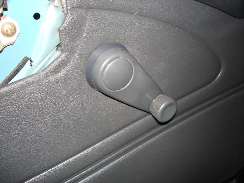

hey guys, pretty simple just need a little help. how do i get this damn crank window piece off so i can remove the door panel completely? got everything else, panel is loose, only thing in my way is this!

i just use a flat screwdriver an push that damn little clip out the way. then look for it on the ground.

You can try a rag wound up so that it's like a rope, look at it to find the open end, put rag over, pull.

Go to Napa or somewhere like that and get the tool to remove them. It's only a few bucks.

All I do is alternate pulling with two hands, one on each end. They come right off.

The rag thing works really well.. also cheaper than the tool :P
