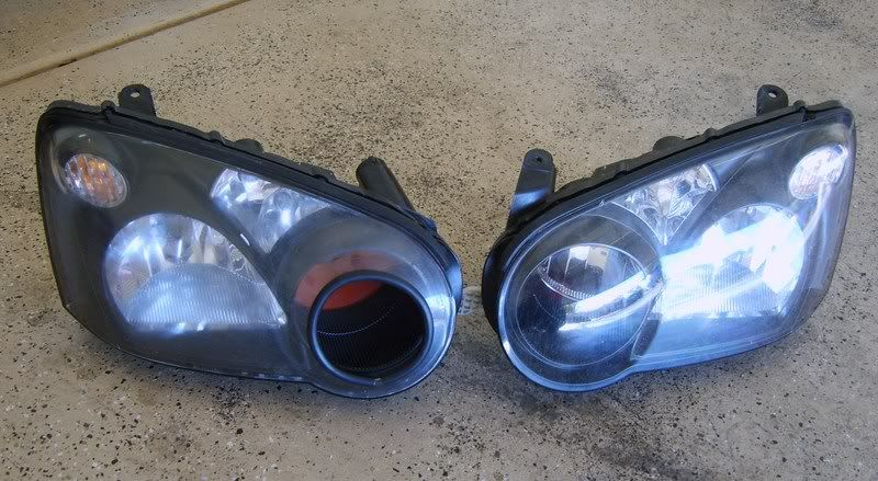

Cut your passenger side headlight in half then use 1 side to let air flow in directly.... you can also remove the left bumper signal since thats blocking air going into your smic(I still have the duct/grill that goes in place of the bumper signals if you want it.)
your headlights are JDM so if you dont want to waste it just buy a cheap used headlight and just modify it similar below

yeah ill take whatever you still have. as for the headlight thing, i may buy a spare but have to find one first, i may also remove the right amber corner light and make a "scoop" like in the link above, im in the process of fabricating a make shift heat shield right now but dont have a welder so im gonna use plexiglass for the time being and then just use that as a template for the permanent piece, im not gonna go too crazy with it because i should be converting to Speed Density soon and getting the FP 4" intake, that damn radiator fan keeps blowing all the hot air right at the intake and after a pull my intake temps jump almost 15 degrees from heat soak and i knock like crazy, like well above 10 degrees knock and it scares the hell out of me so i pull over and shut her down to lower the intake temps.

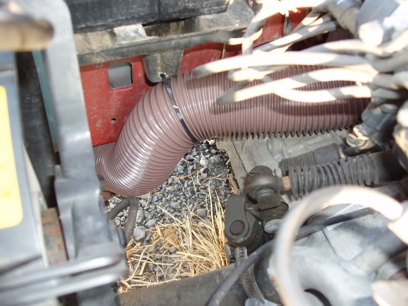

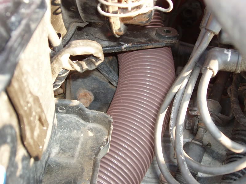

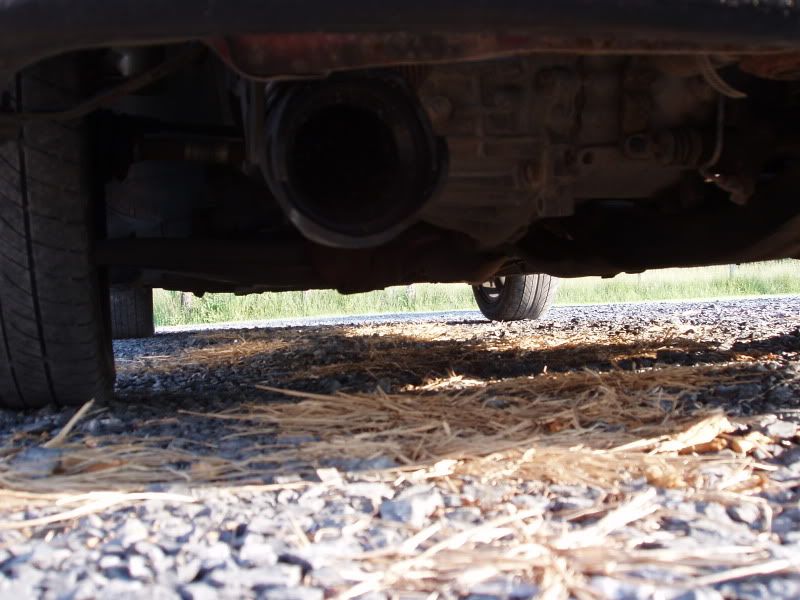

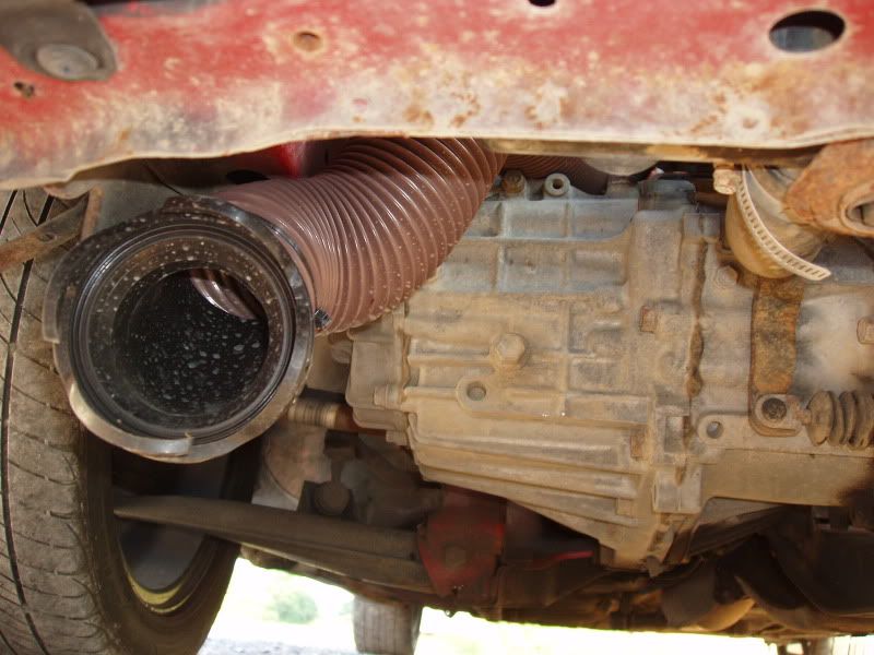

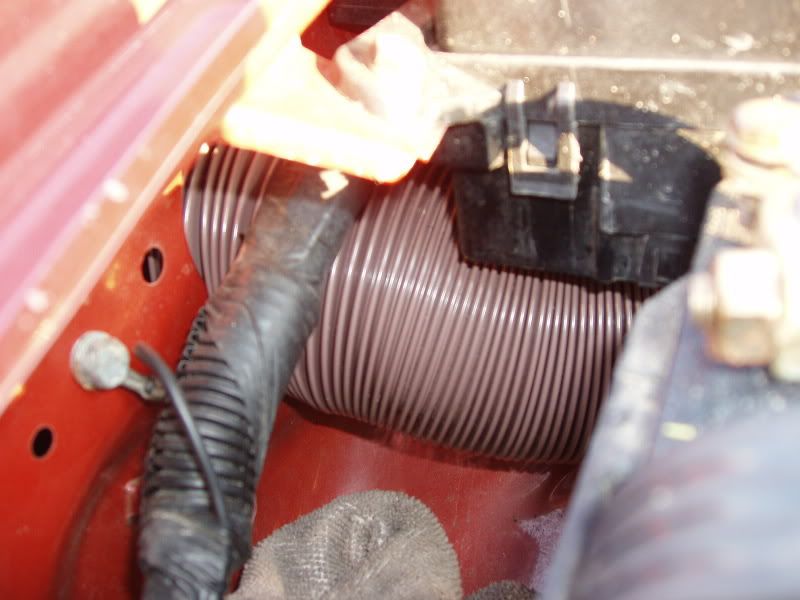

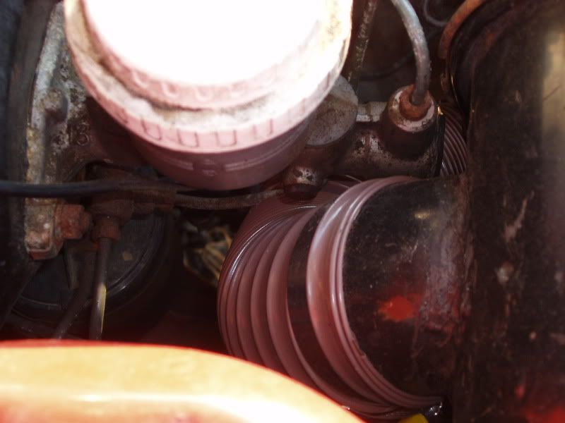

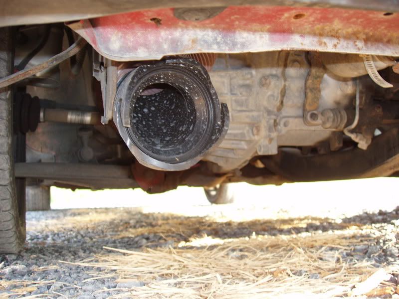

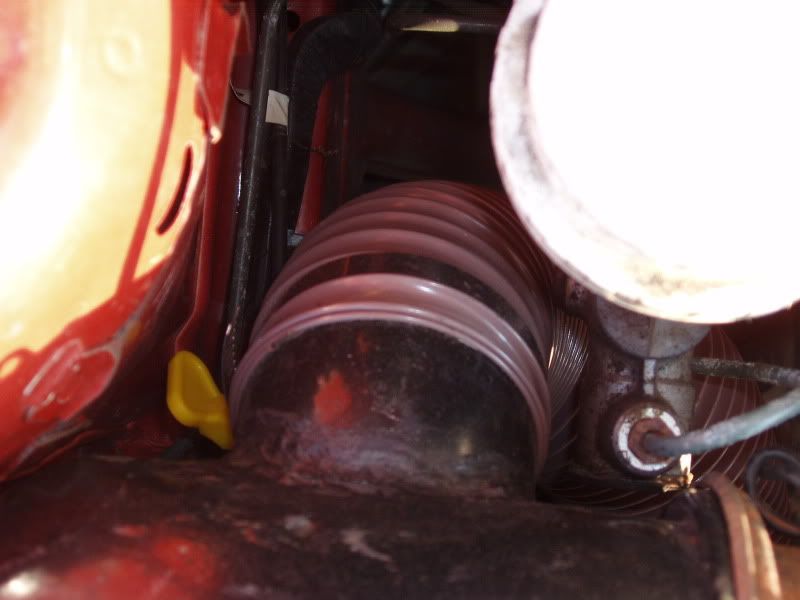

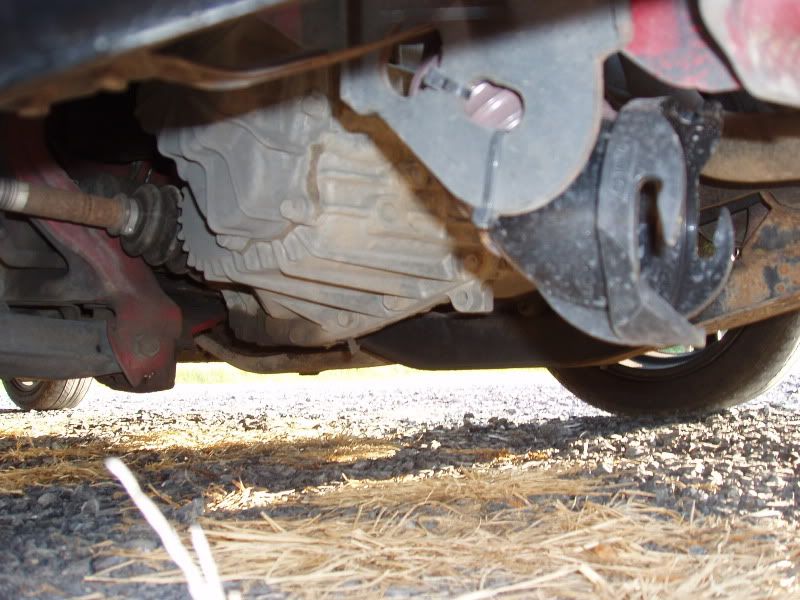

Heres my ugly attempt at cooling the intake air. It's not pretty, but it works and the last pic is my shameless attept at a plug. All thanks to my local Walmarts Rv section. Helps keep the heat soak down and it works for a 4g15. Also, check out that negative CV position angle on the pass. side.
